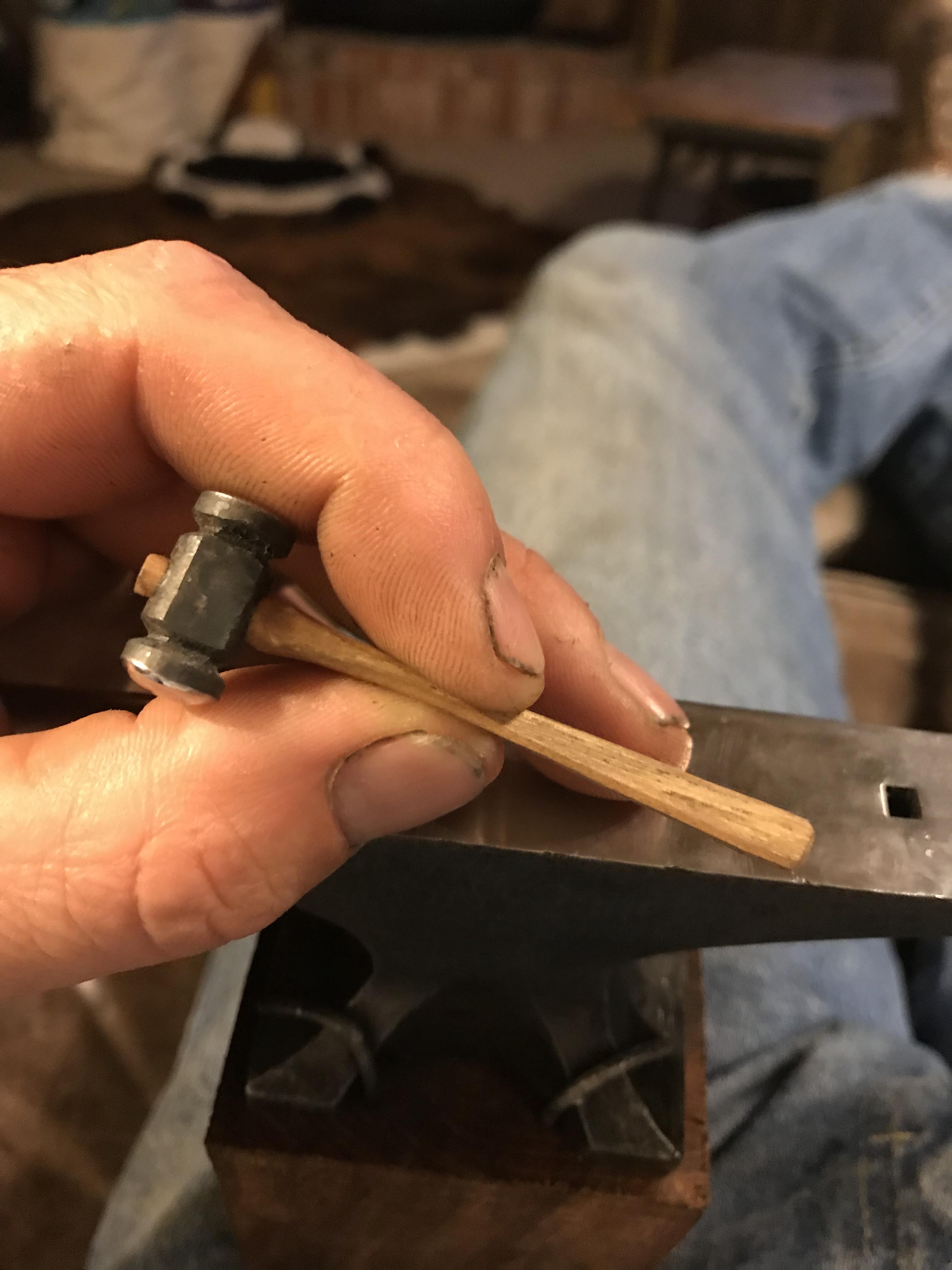

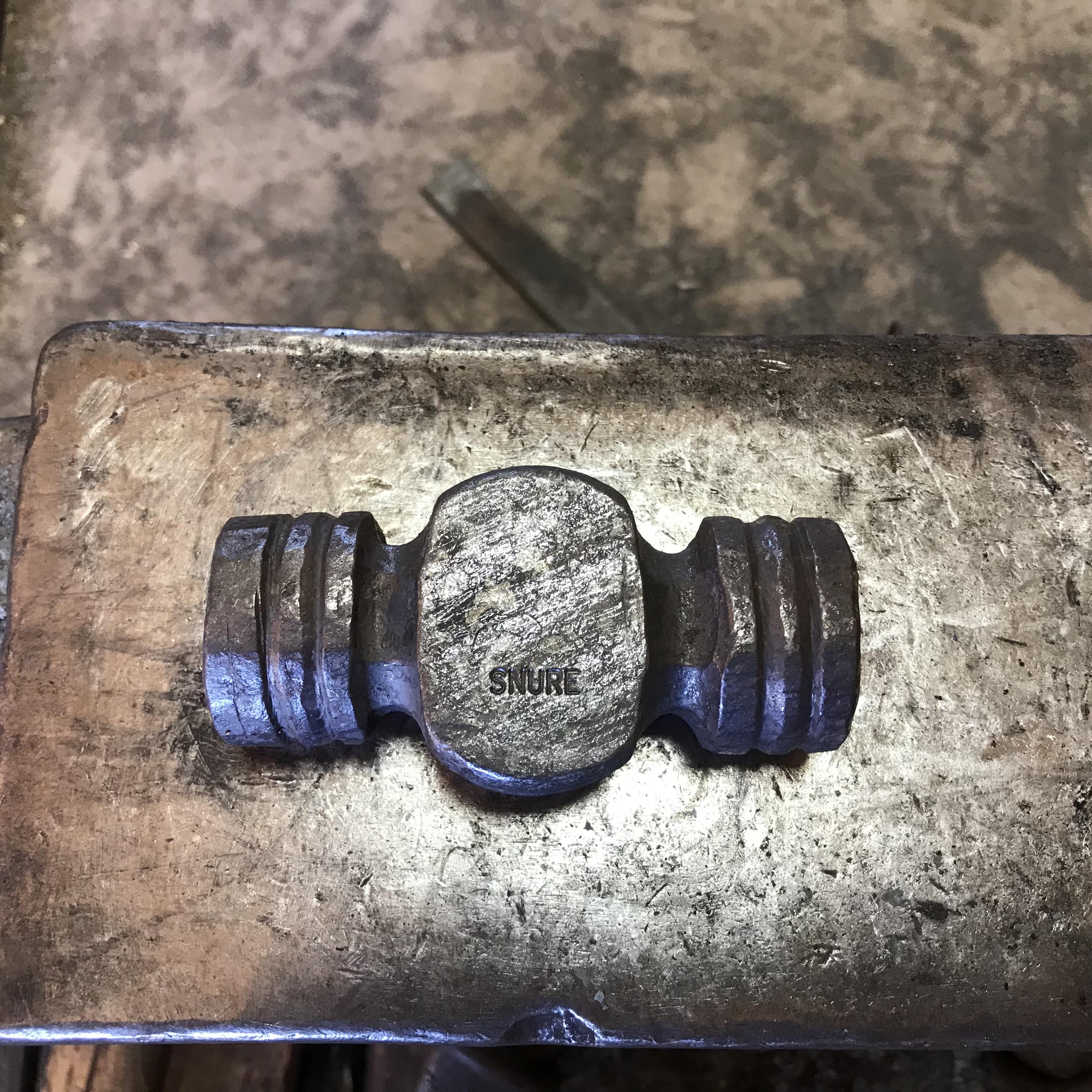

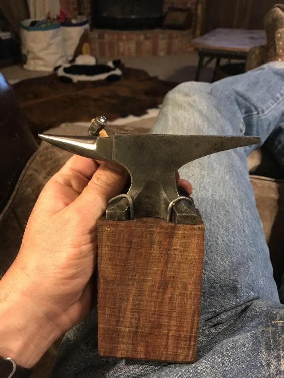

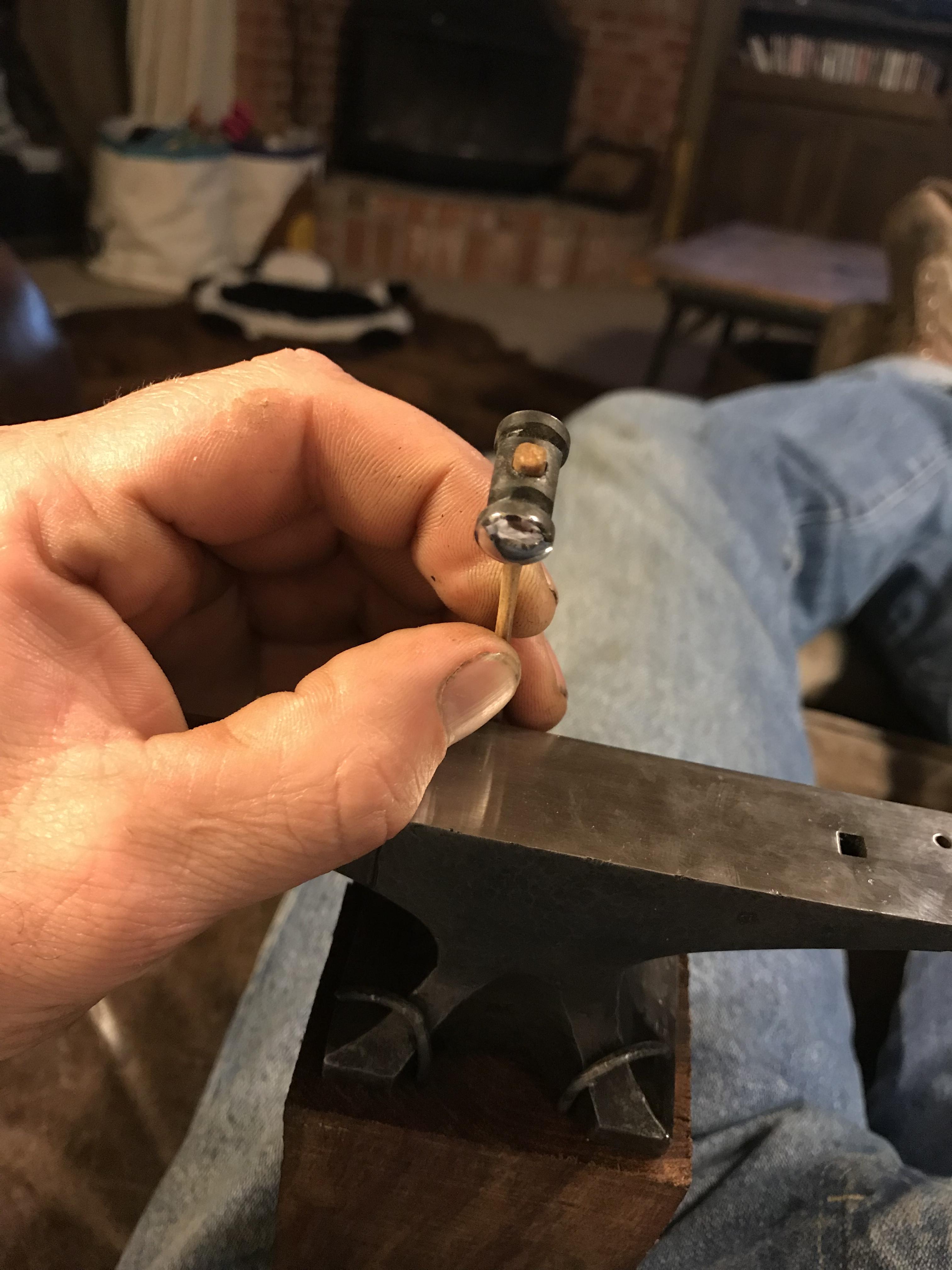

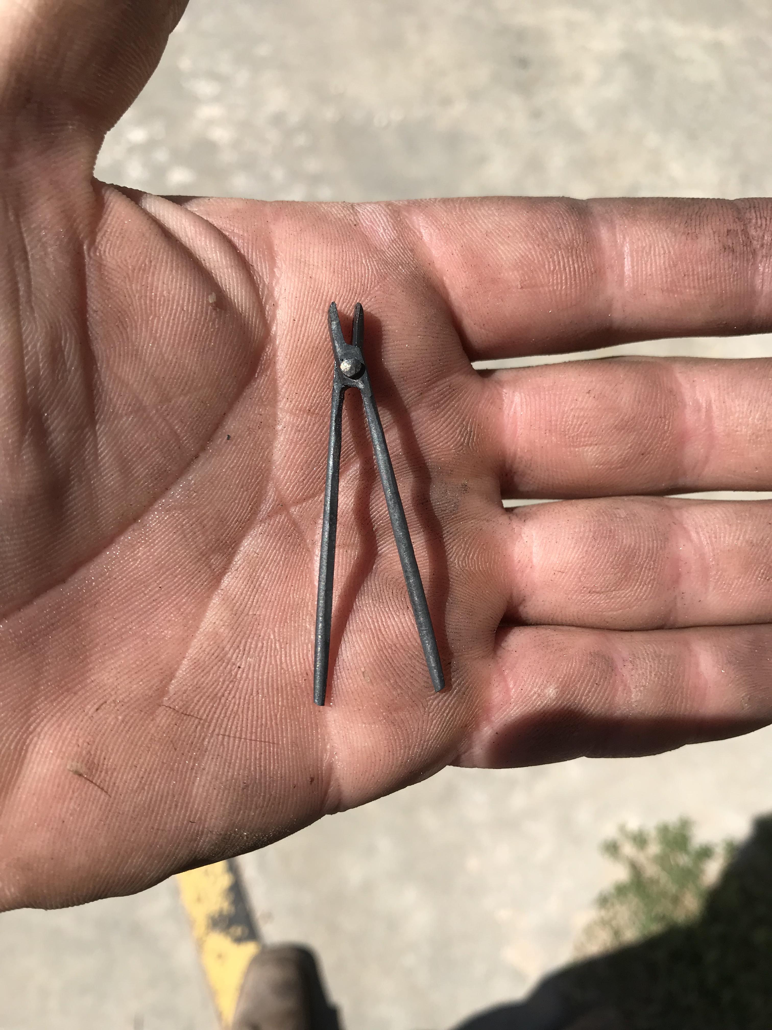

I’d have to say that the tiny ones were tougher. After you’ve built a few dozen full sized sets of tong they don’t present much of a challenge. These tiny ones were mainly done on a belt grinder and one little slip pretty much ruins them.
Ranchmanben replied to Mark Ling's topic in Blacksmithing, General Discussion
Thanks Das but I confess, I filed and ground the hammer and tongs. -
Great work mud man! I like that Fungtional hammer. Now that my joke is over I thought I’d show the little tongs I made from 5/32” 7018 rod and the hammer made from 3/8” cold rolled. The tongs are working set with peened rivet and offset reins. The hammer is handled with hickory, like it really matters. The anvil was forged by a guy named Devin Jennison at Fawkes forge. It’s based on an arm and hammer anvil, forged from 4140 then properly heat treated. When not on the stump it’s got appropriate ring.
