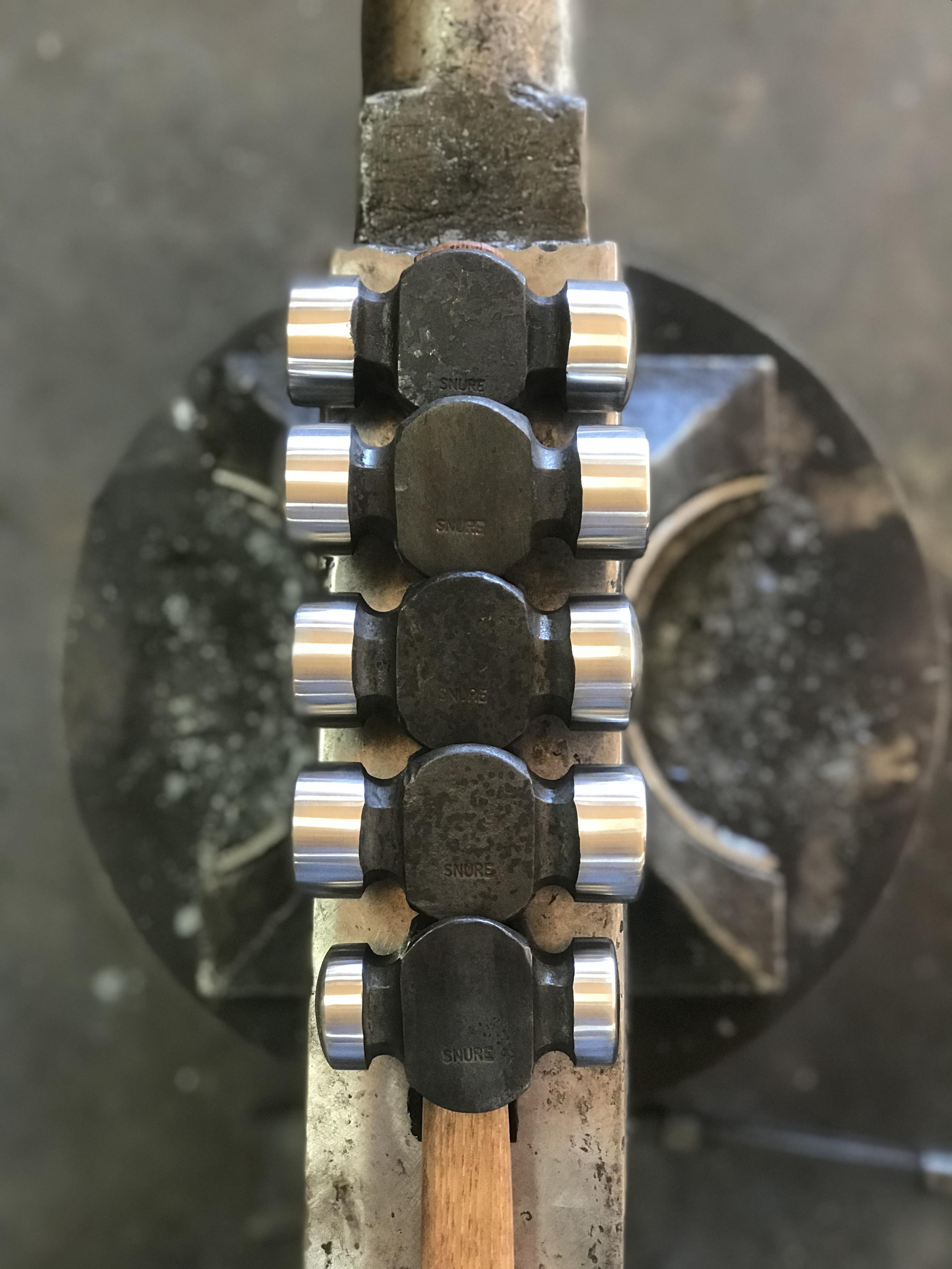

I’m with you Jennifer. I quench everything I can in water. I forged and annealed five hammers Monday. Did some grinding Tuesday evening and heat treated and final polish on the faces Wednesday evening. Hopefully I’ll get them hung this evening. Four 2lb and one 1.25lb that was a special order. One of the 2lb didn’t make the cut for the store order. Nothing wrong with it but it just didn’t look enough like the others. I’ve got special pans for it -

Thank guys. I’ve never had much of a problem with my heads coming loose but I’m always looking for ways to improve my products. I think I’ll look into the swell lock and try it on the next hammer I make for myself. Glenn, I occasionally will give the wedge a coat of blo before driving it in to help lubricate it. I don’t know if it helped secure it in place once cured but I doubt it since it very little air is in that joint. I just make sure to drive it in as hard as I can without breaking things.
Glenn, is your second metal wedge perpendicular to the first like this one? Or along side it some how? If using swell-lock, I assume you’d use it before soaking anything in BLO. Would that cause any discoloration when you did soak it? Is swell lock something you could dribble down the slot for the wedge right before you drive the wedge in?
Mark, I’ve actually had a coulple of hammers done like you’re talking about. A couple of them have had the wooden wedge work it’s way out in two pieces after very little use. I’ve toyed with the idea of glueing the wooded wedge in but I like to be able to knock the wooden wedge in further if needed.
Thomas, do you use a metal wedge with your hammers?
As I’ve been making more hammers and therefore more handles I’ve gotten to where I never install a metal wedge. I send them with the hammers I sell but have decided that when hung properly there’s no need. Every hammer once mounted gets the head soaked in boiled linseed oil/turpentine for 18-24hrs and then the handle for the same amount of time. I’ve played with longer times but the results are negligible. As long as I soak the head once or twice a year they don’t seem to loosen up. It they get loose enough that a soak doesn’t do the job then it’s time for a metal wedge. Also, it often seems like the metal wedge just splits the grain making a built in fault. Does anyone else else do something similar or do you always use a metal wedge? I look at hammer handles as a consumable but like everything else, the more care you take of it the longer it lasts.
