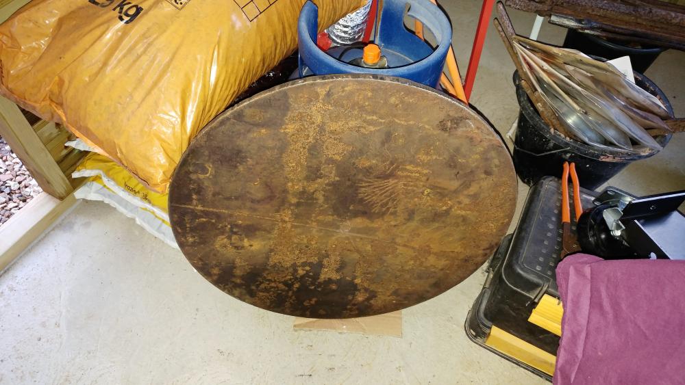

  12. Hi stockmaker, thanks for showing that. Some weight there boy! Rounded plate for me means I will be able to move it around if needed. I like the top plate mounted to one side. Are you right handed? I am a lefty and may put it off to the right. Is the leg just a tight fit into the tube at the bottom? thanks, Tom.

  14. Like this one here.....(the one on the left!) Hi KRS Thanks for your reply. Yes, I think that would be good. A strong piece of tube welded to the plate-just the right size for the leg to fit in without moving-don't think I would drill through the plate though. Just weld to the plate as it is so that the forces are striking the plate and not the concrete floor. I will stand on the plate while I work at the vise also-so it cannot move. I will also fill the upright square tube with sand and fit a small top plate to bolt the vise to. Are there any other suggestions which might help too please? thanks Tom.
  15. Surprised? I haven't had one single reply about my question! Anybody there? Can it be given a bump up? Tom.
  16. Sorry, I feel like I have mixed up the previous post to mine about a post vise base; with the one from another member about basketball hoops. My post and request is not part of that and it starts at the words, "Mine is in bits at the moment having a long soak in vinegar...." The best one I have seen so far that might fit my bill is on faq's on anvilfire under 'V'-its a red steel circular base with a circular steel pole welded to it. thanks Tom.
  17. This is the mount I modified for school. It works nice. It originally held a basketball hoop that fell and smashed the ring flat. I saw it in the school's junk pile and knew just how to use it. It does not work real well for much leverage as it does spin. But for what the kids do with it, it works great. Mine is in bits at the moment having a long soak in vinegar. Its only a baby with 3" jaws.will be getting a bigger one too) I haven't fitted yet and I've looked on file here at various ways of doing it also on google. I have a 6" concrete floor to work with and I have this plate I would like to use as a base. Its 23" dia. 1/2" thick mild steel and weighs 24.5kgs. and am thinking of welding a suitable 4 or 5" square tube to the base and fix the vise to that and perhaps fix the bottom of the leg through the plate too. Are there any issues with doing it this way please? thanks. Tom.
