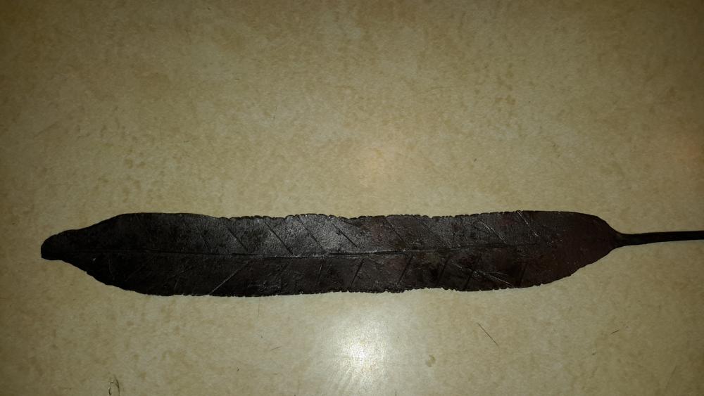

  19. I took a chisel to it while it was hot....I just chipped it along the edges.

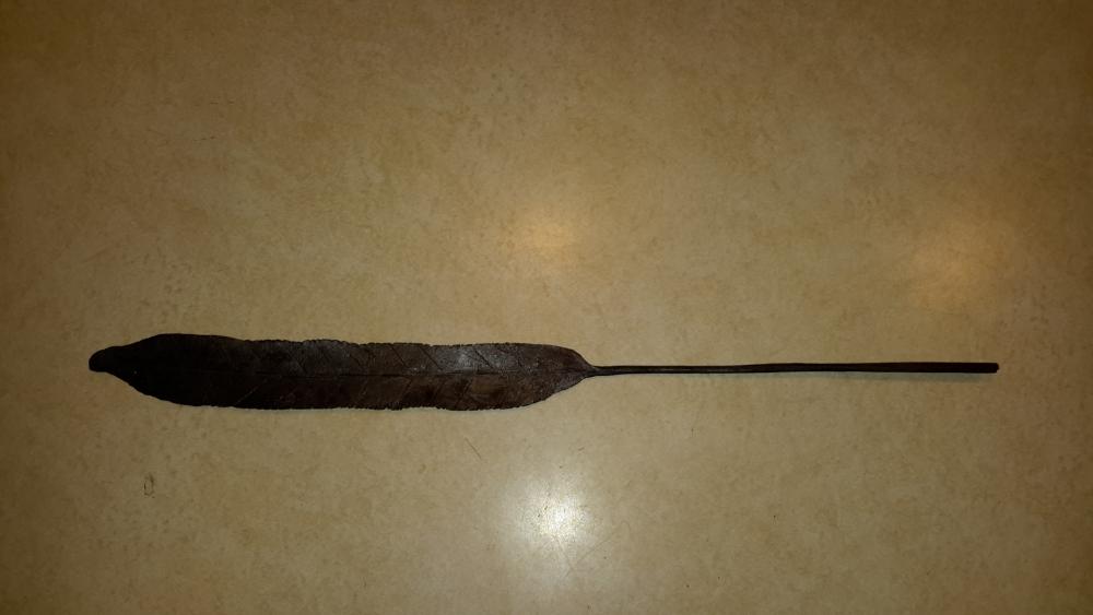

  20. Hey everyone...Got my forge up and going and this is my first project. Its WIP but soon to be finished. I saw Chandler Dickinson make one of these on you tube...Thought id give it a try. I still need to draw out the stem at bit and curl it up to hold the incense stem. Flatening and drawing this out was much more difficult than i had imagined. Started out with 1/2" diameter re-bar. 18" overall length at the moment. Ill post more pics when complete. Thanks Bruce
