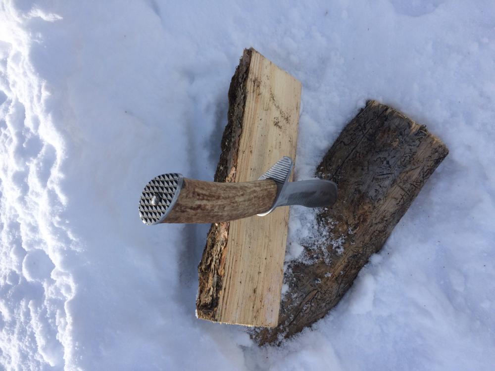

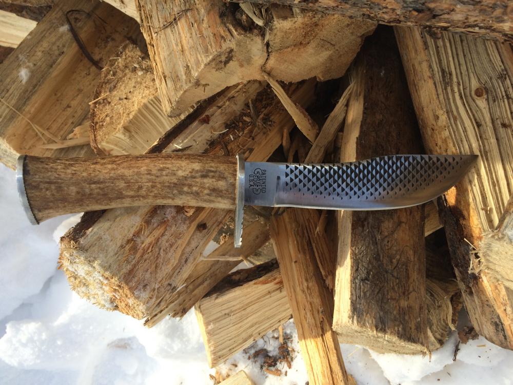

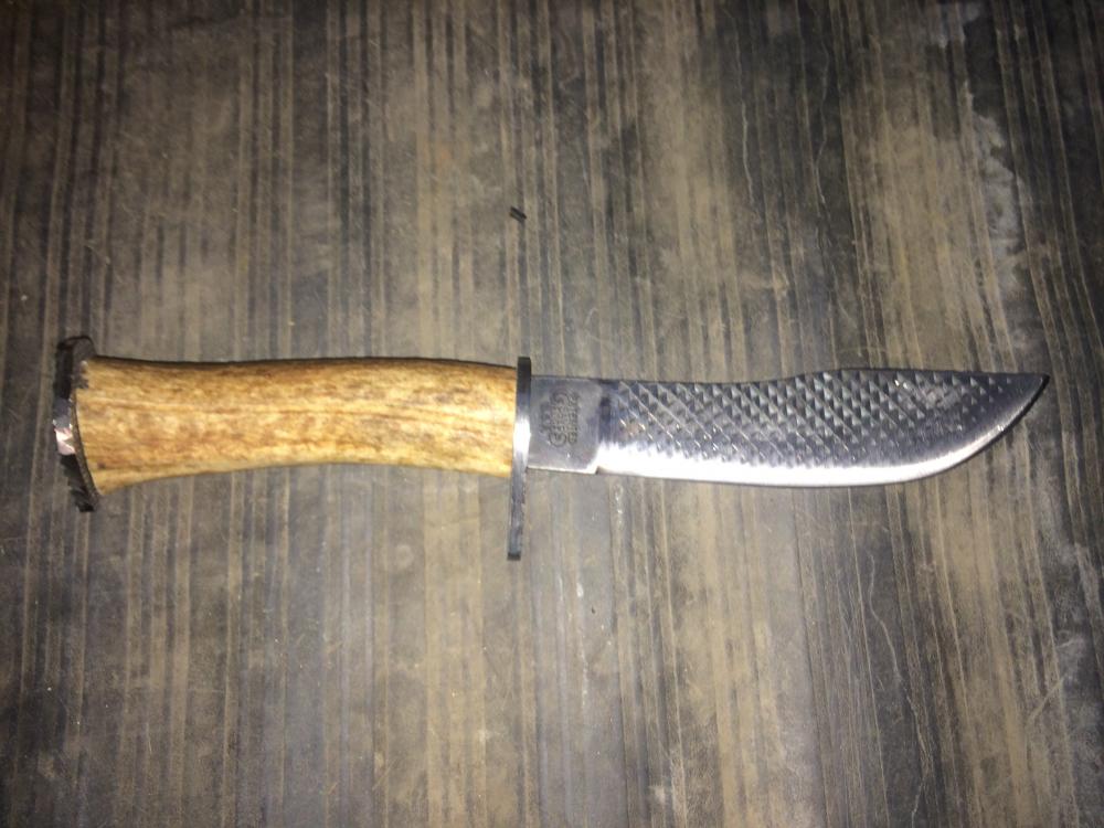

  6. Finally finished it! Butt cap is pinned and tang is peened. Here's what I have learned on this project. Coarser grit and a better belt grinder will make for faster stock removal. Thanks to a farrier friend with a 36 grit wheel I was able to Finnish on time. Make sure its near sharp but not sharp. (Just a little blood) Follow your lines good file work saves Finnish time And most of all… Keep it fun Almost forgot adapt with the metal!

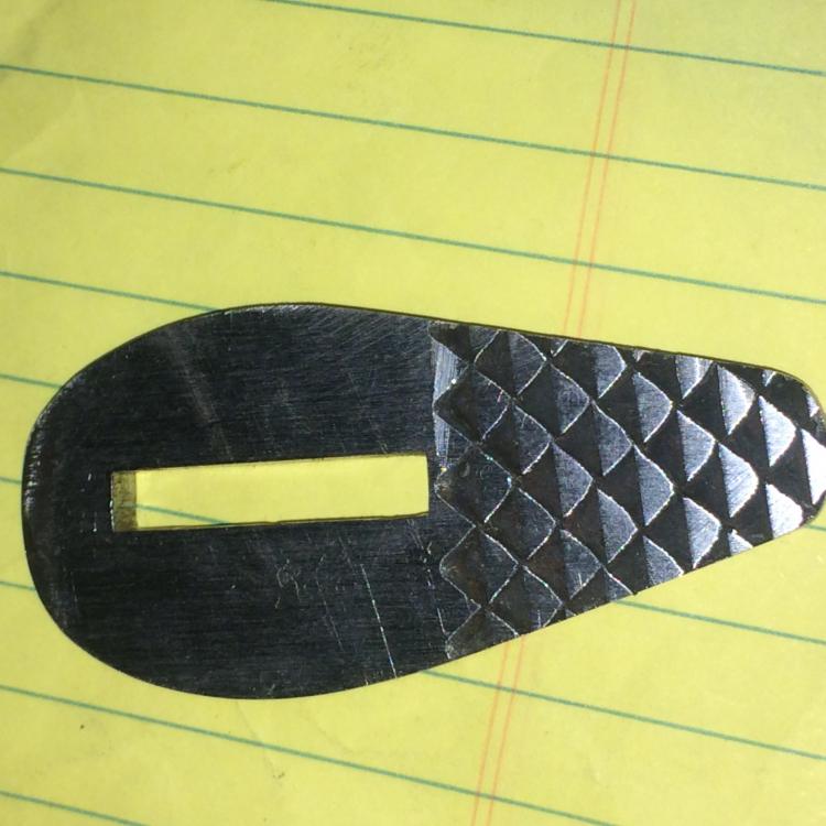

  9. Cut a V notch in the tube, bend weld then grind to Finnish. Makes for a fast easy bend on square.
