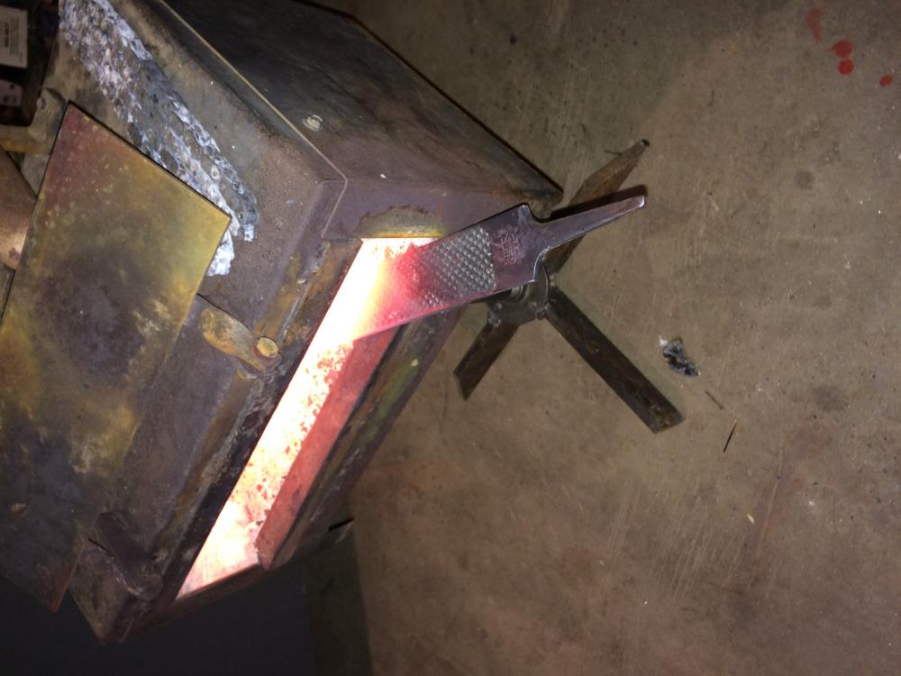

Locksmithjoe Posted November 30, 2015 Share Posted November 30, 2015 I was wondering how I can make my two burner forge more efficient and maybe add side holes for longer pieces? I don't know the brand but the burners are cast and have about an 1.5" opening inside the forge and all of the fittings 90 down at the rear of the air intake. Any ideas or thoughts please. Not a great pic but better than none. I was thinking of cutting a 4"x5" square on each side with a flap cover to increase my size usage Quote Link to comment Share on other sites More sharing options...
WayneCoeArtistBlacksmith Posted December 1, 2015 Share Posted December 1, 2015 You could help it some by painting the inside with Plistix or Metrikote.to reflect the infrared rays back into the forge. Rather than trying to modify this forge you should probably just build a new forge. You might even be able to reuse the burners. Go to the Forge Supplies page at www.WayneCoeArtistBlacksmith.com and see the attachments there for how I like to build a good, long lasting, efficient forge. Let me know if I can help you. You can e-mail me at waynecoe@highland.net. Quote Link to comment Share on other sites More sharing options...
Locksmithjoe Posted December 1, 2015 Author Share Posted December 1, 2015 Building a new forge is not an option at this moment. Luckily it is quite efficient at keeping the garage warm. It also brings the metal I'm using up to non magnetic so I can not complain too much. I probably need a better regulator on it, yhe one I'm using was from the hardware store in the bbq section. I'll get some better pictures in the morning. Quote Link to comment Share on other sites More sharing options...
Mikey98118 Posted December 13, 2015 Share Posted December 13, 2015 Joe. Isn't this the very same kind of forge as the rebuilt model in the thread right above yours? Before you enclose it's front like Harry did his, I would suggest installing an angle iron below the front opening, instead of an enclosing plate, and stacking firebrick in front of the opening, but NOT against the wall; leave space for exhaust gas to hit it and be deflected upward. This keeps you from being blasted by dragon's breath, while the gas heats the brick face, creating infrared energy, which bounces back into the forge interior (much more efficient than allowing it to escape with the exhaust gas). Brick also has the advantage that you can change the shape and size of the little opening you leave in it to poke your work through. When Harry enclosed the front of his forge, he made openings in its ends for the exhaust to exit through (after all, those are very large burners for such a small forge), which allows him to put long narrow pieces into it. You should do the same thing, but add exterior angle iron below the end openings too, so that they can be baffled with brick just like the front opening. Then, don't even try to run those burners full blast; you shouldn't need too anyway. You could refine the forge even further by employing kiln shelving backed by insulated firebrick on the outside of the forge, but realistically, there comes a point when we are trying to "make a silk purse out of a cow's ear"...in other words, just upgrade that forge minimally, and build a different forge if you want efficiency. Quote Link to comment Share on other sites More sharing options...

ytuyuty Posted December 15, 2015 Share Posted December 15, 2015 On 11/30/2015 3:49:55, Locksmithjoe said: I was wondering how I can .... add side holes for longer pieces? 1. Disassemble the forge 2. Remove the front door 3. Remove the refractory material around the front door 4. Cover the front with more refractory material 5. Cut holes in the end plates and refractory material 6. You may need to extend the firebrick floor all the way to the end openings 7. Reassemble the forge 8. Cover the front (where the door used to be) with sheet metal In the photo below, the red sheet metal is where the front door used to be located. Quote Link to comment Share on other sites More sharing options...
VaughnT Posted December 15, 2015 Share Posted December 15, 2015 That's well done. A lot like my forge. Just remember, the bricks are lousy insulation and really suck up a lot of gas. My forge will only get to welding temps at around 25psi, which is double what most folks are experiencing with forges that are better insulated. You'd do yourself a tremendous favor by replacing the hard insulation with something like Inswool or Kaowool blanket material and then giving it a skim coat of refractory cement and a painting of Metrikote or the like. Quote Link to comment Share on other sites More sharing options...
