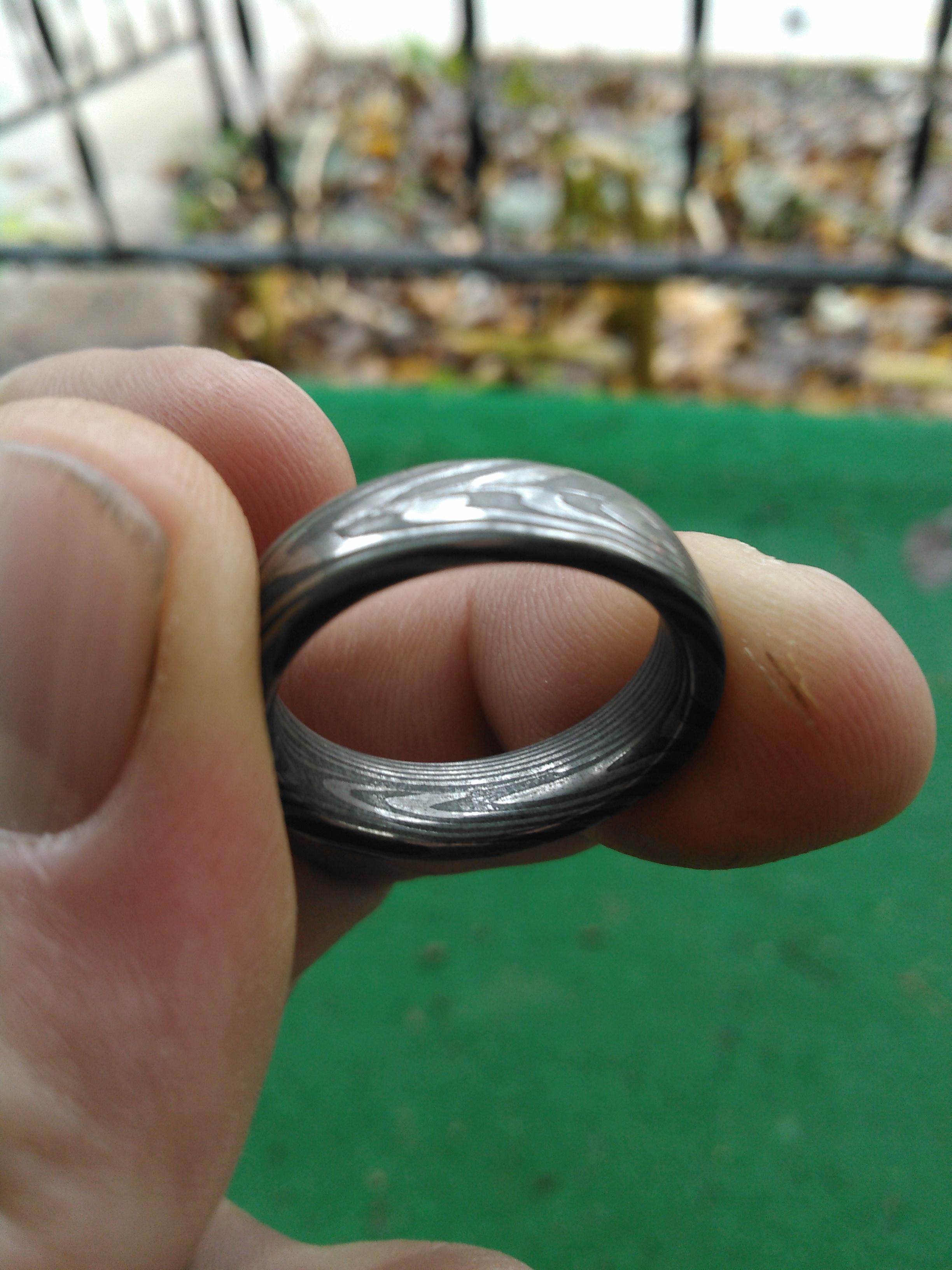

  17. I heat treated, etched and repolished. I realized that I was saying the etching mix wrong what I meant was 6 parts water and 1 part ferric chloride.

  20. Thanks das, I spoke to a silversmith I know and he said to use renaissance wax. I looked it up and its a micro chystaline polish used in museums for restorations and rust prevention.
  21. I really like how it turned out but the rust is an issue. I think next time I may try 15n20 and 5160.
  22. II made this Damascus ring with band saw blade and flat spring, now I can't keep it from rusting on my finger. I thought about etching and sealing with bee's wax and repolishing. Is there anything that you guys would suggest. I really like this ring and want to keep wearing it but not if its going to constantly rust.
