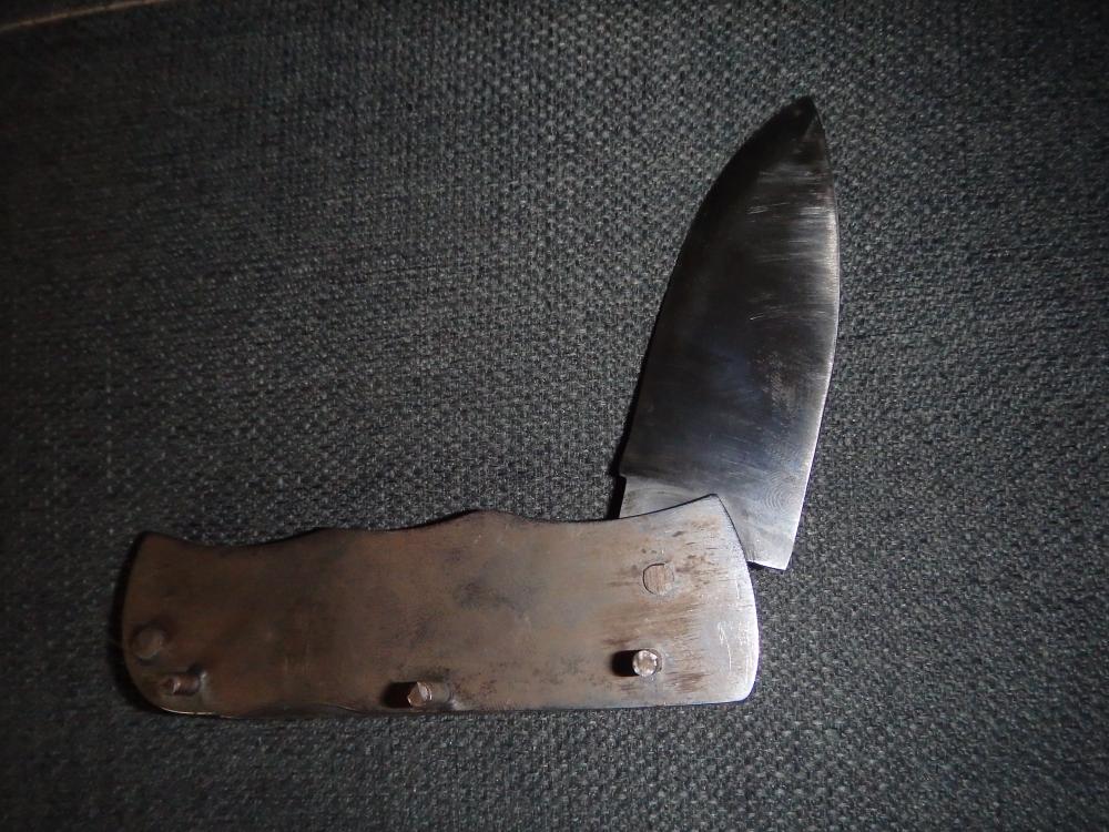

  1. Thanks guys! It was a lot of fun to make, though it really wasn't too hard. I took apart an old folding razor knife to get the idea for the lock, and then I modified it for this knife. I also took gun blueing and blued it, now I use it as my normal carry around knife. I am pretty impressed with the steel actually, it holds an edge well!

  5. I have now finished with the modifications. It changed the handle material to be Umbila wood (Also called Kiaat) and I changed the spring for the lock. I still need to do some perfecting, but it is definitely a start.
  6. Yes, It is not finished yet, still needs the scales,. but I made a different spring for the ball-bearing that holds it closed.
