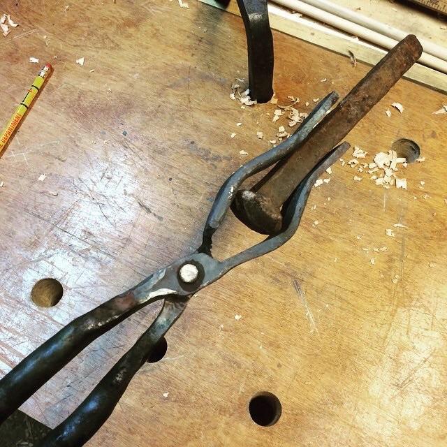

  2. still getting the basic concept of forging a set of tongs, but I thought I'd make my second pair a set of bolt tongs. Filmed the process here. it was fun and for some reason a slight challenge. I also made a quick hot cut hardy so I don't have to use chisels all the time. It is out of a RR spike so we shall see how long it lasts.
  3. @2ballcain357 Thanks for the kind words. These are a lot easier than I had imagined. I used 1/2" stock fyi.

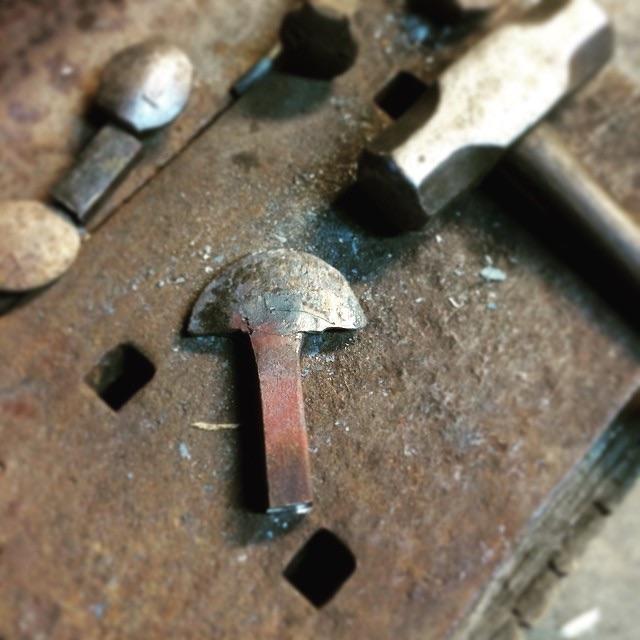

  6. Getting by with a track anvil can be difficult sometimes. I have already created a horn on mine, but getting a hardy hole has been a challenge. I believe having this hole would be a great benefit because you can place different tools in one to achieve different things. I have had a different piece of railroad track, not the track, but a different section that holds the rail timbers. In the video see how I ended up crafting a hardy hole section to hopefully achieve this. link removed Area under the track plate hole has been drilled out, Spike can now be modified to fit into the *hardie hole* and be used.
  7. I've had my piece of track for a while now. I finally took on the challenge of creating a horn on it. Check out the video here.
