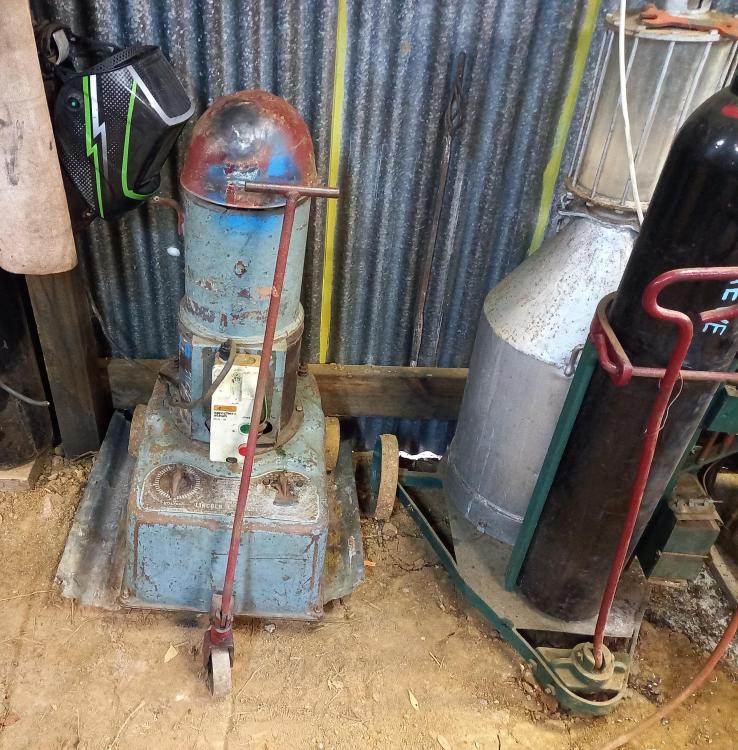

  4. I have a 10HP rotary converter and I tried to run my Lincoln DC welder witch is basically an AC motor but it won't even hold the welders relay closed and if it dose it just stalls.

  13. I got it, dont see why it wouldn't run off a VFD, there is no connection between the welding side and the AC motor.
  14. I saw an old Lincon vertical DC welder for sale and was thinking it would be good for my situation, I understandthey have an AC motor to run a DC welding generator? I have an 11kw VFD phase converter, witch will not run a normal 3 phase welding transformer but would run an AC motor happily. My AC arc welder is about 70 years old and doesn't work as well as it could thrugh the long run of cable to the shop. I use to have an old garden tractor that had a DC welder on it that was driven off the engine, I really liked that thing.
