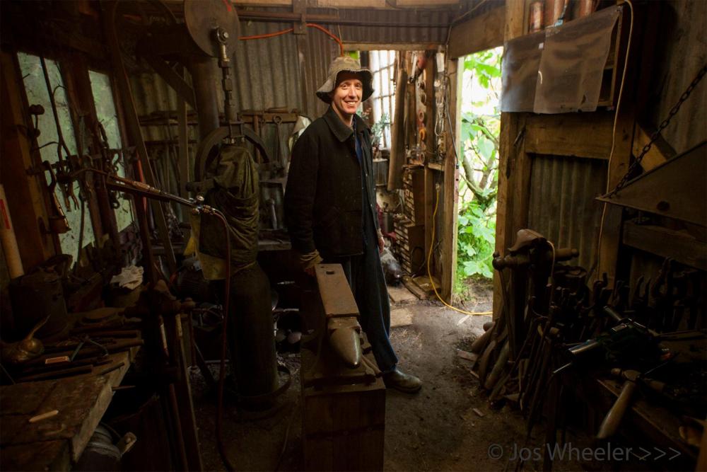

Its almost time for my old shop to be demolished for a few reasons and its upsetting people, I have been using it since 1998 and almost full time since 2007, new shop will be 100M on the other side of the hill overlooking the Pacific ocean and be bigger with a higher roof. I have no idea on the layout but my anvil stand and vice stand will be cemented into the floor and power hammer needs a 4 ft footing, will have fluorescent lights more power points, better bench, coal forge will have flue going through the wall and not the roof as this caused a lot of problems with water leaks in the current shop. I wont have windows as I smashed most of them my mistake. I think the coal forge could go in one of the corners and power hammer could go along one of the long walls and I would like to have my big leg vice not so hard up to the wall, I have to have it underway in a couple of weeks.
