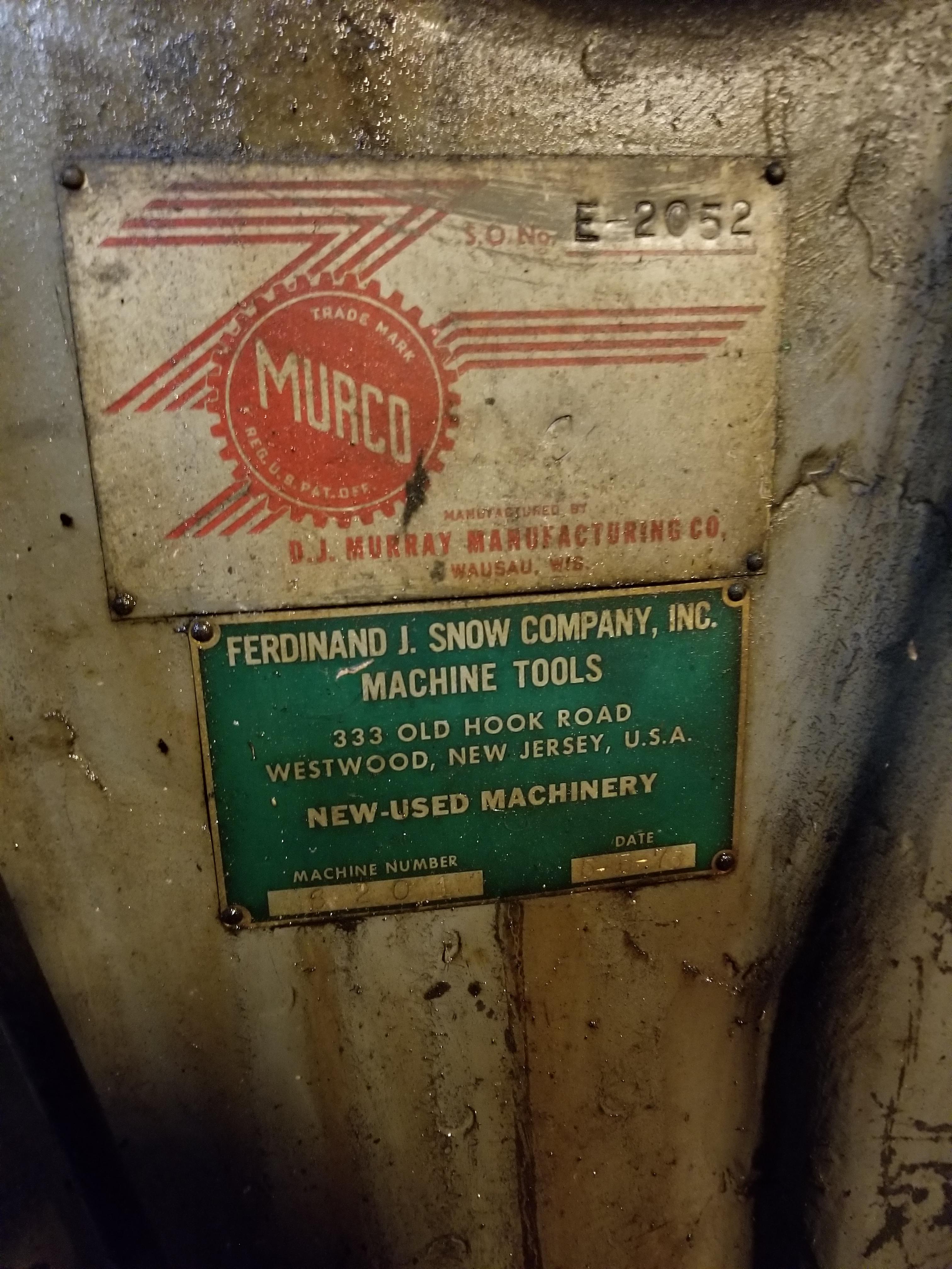

Ahh so the tag serial doesnt reference a year at all. It did in a card catelog somewhere, forgotten in time though. I keep meaning to buy that book. Does jt contain info on self-contained hammer? -
mayer bros power hammer spring issue
DanielC replied to bhixson's topic in Power Hammers, Treadle Hammers, Olivers
I need more info on this from books. I didnt realize Murco was bought by LG. Whats yours look like? -
The tag screams 1950's to me. -
Well the machine company that had it eventually to sell to someone else has 1975 on thr date with a machine# which is i am assuming a catelog number for their records in their warehouse, and the date it was brought there? Or it was bought new and they were a distributor of the hammers and the date 1975 is the date of manufacture? Maybe the 2052 serial number on the Murco tag means it was the 20th machine made in 1952? -

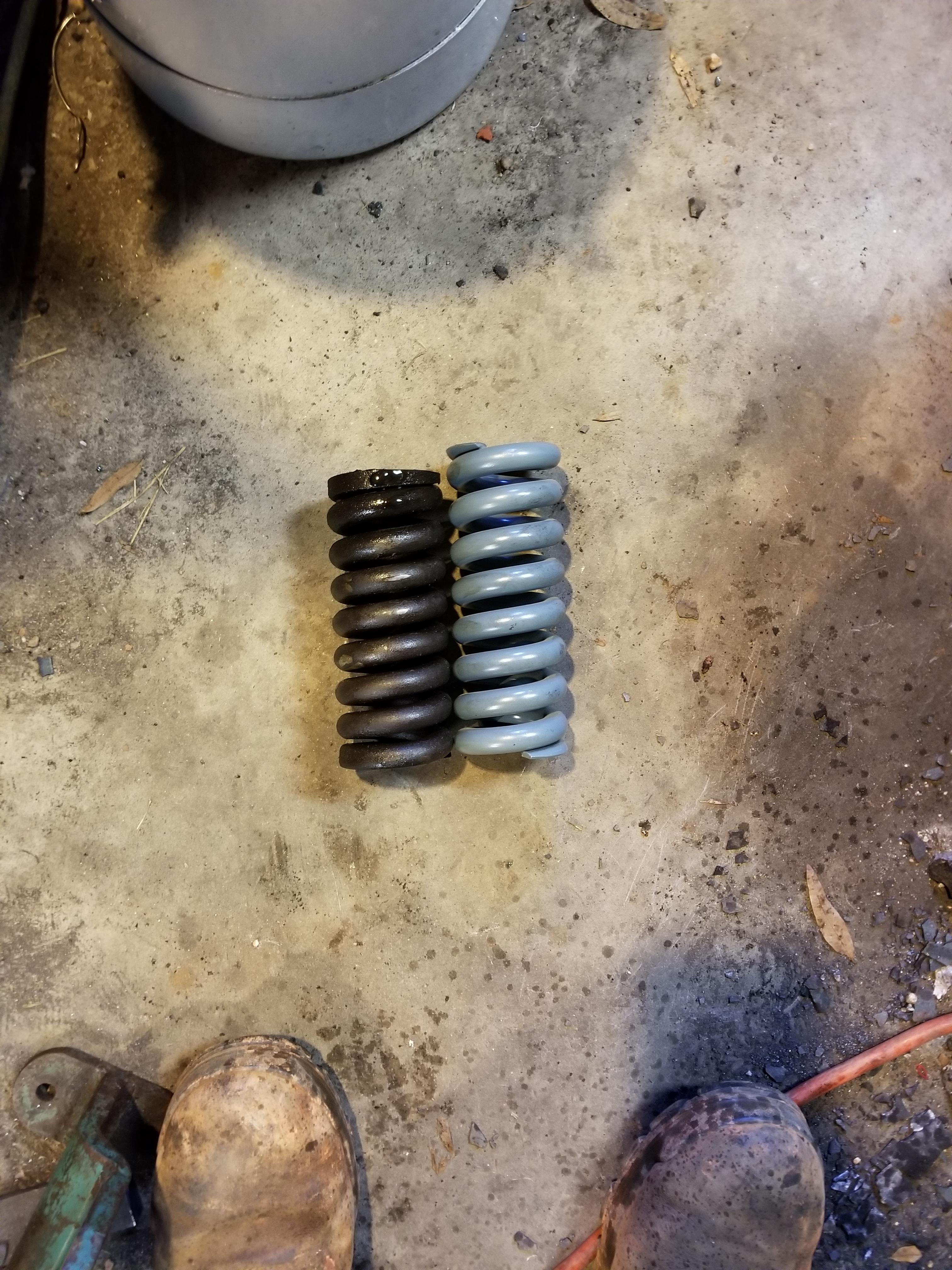

It is amazing that i just found this thread, and i was replacing the tension spring for the first time on my 50# Murray. Like your Moloch, my Murray has some upgrades to the LG hammers you often see. Roger Rice is making up some keys and bolt down die blocks for my hammer as we speak. He said my hammer had very few hours on it, and thats after me pounding away with it for a few years. With that said, i havent forged with the new spring on, but before it was replaced, my 50# Murray has such ridiculously good control. It will forever be used as my blade hammer. Simply no replacing it. -
