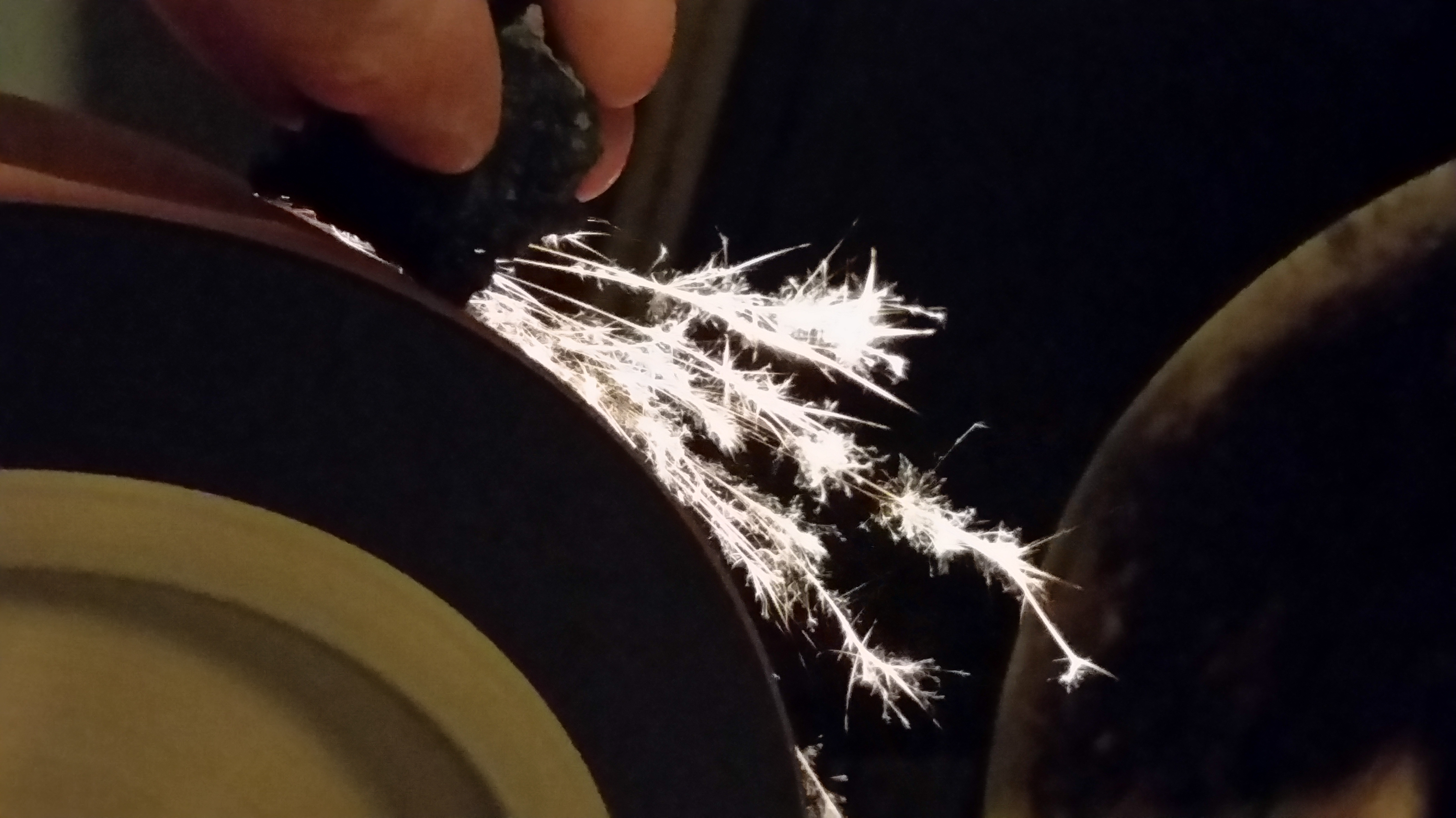

  14. That top pretty puck with the colors wash turned into a bar for a friend. Wasn't cracky at all, just needs some of the charcoal bits to diffuse into the steel. A little piece broke off in the second pic revealing the steel grain. Then changed a few parameters of my furnace to push it further to cast, but not quite. Made these closest possible carbon content before it is so high that it is cast and cannot be worked. I would say this next bit is easily 1.5 C. Squished it down (good sign), and then quenched it. It shattered like glass when struck. The grain is so-so and deserves some folding to be truly beautiful. Spark is dense and intense, but also long. Unlike cast which is dense and short.
  15. Been making a lot of it lately. 1.2-1.5% C range in all of my pucks, in their entirety. Been figuring things out, or rather finding through trial and error how the japanese make such beautiful looking steel, with clean surfaces and tempering colors, rendering the steel to take on its name by appearance as jewel steel. I have the composition spot on with what they are using. Almost have the visual down pat.

  19. Well honestly I know it lowers phosphorous, and I only suspect it lowers sulfur. Good chance that it does as well. It comes out in the slag during the melt. I can consistently make and have been making fairly clean steel in the 1.2-1.5% C range, and fairly identical to the same orishigane made in Japan, which is widely used as a tamahagane substitute, which in itself is indistinguishable from tamahagane.
  20. This iron is literally melting. Depending on the height of the floor to the tuyure, I can control the carbon content and separate a majority of the slag from the metal, along with lowering phosphorous and Sulfur to a high degree. I can either make really clean iron with no carbon at all, or introduce enough carbon to make it cast.
