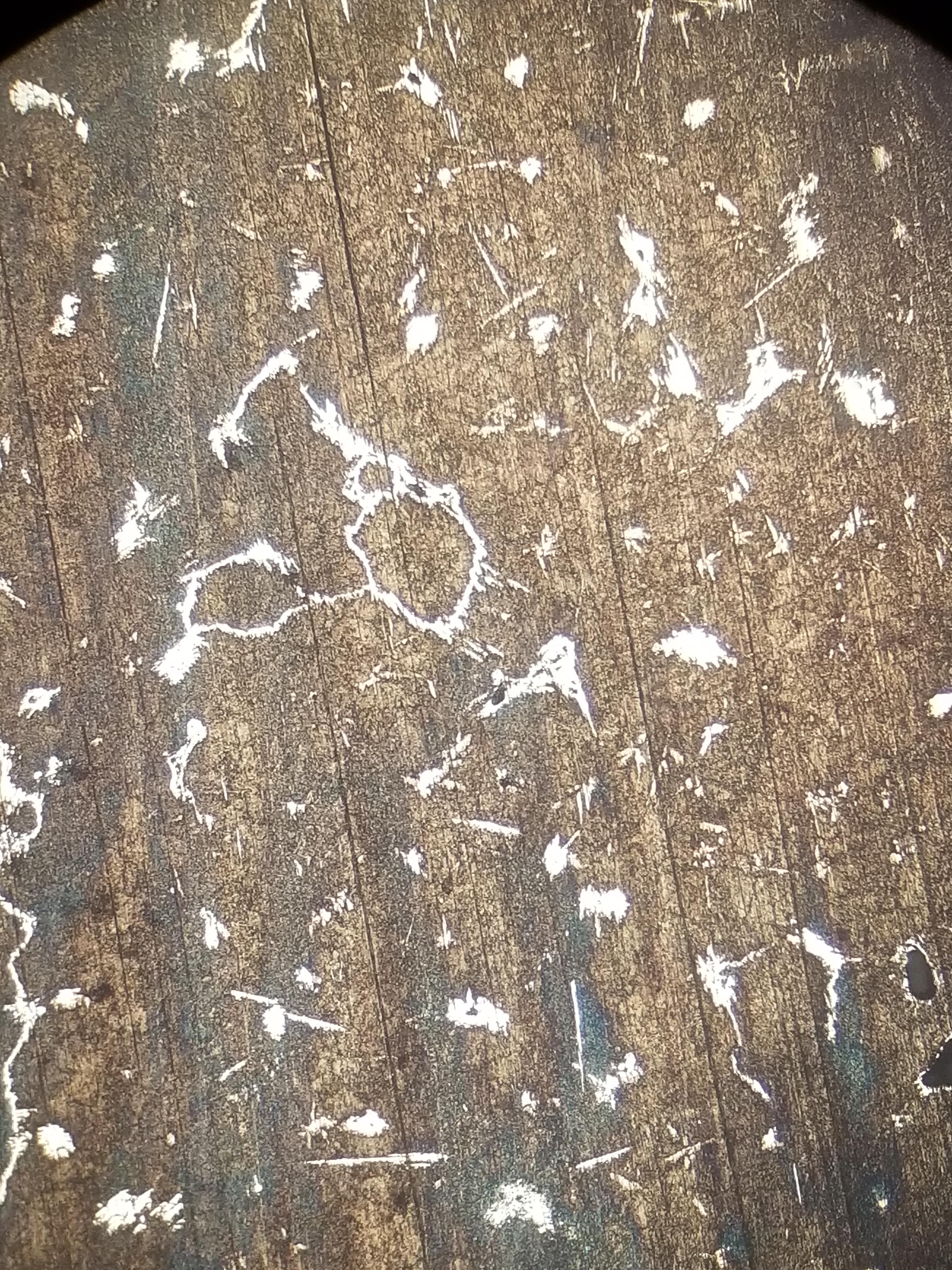

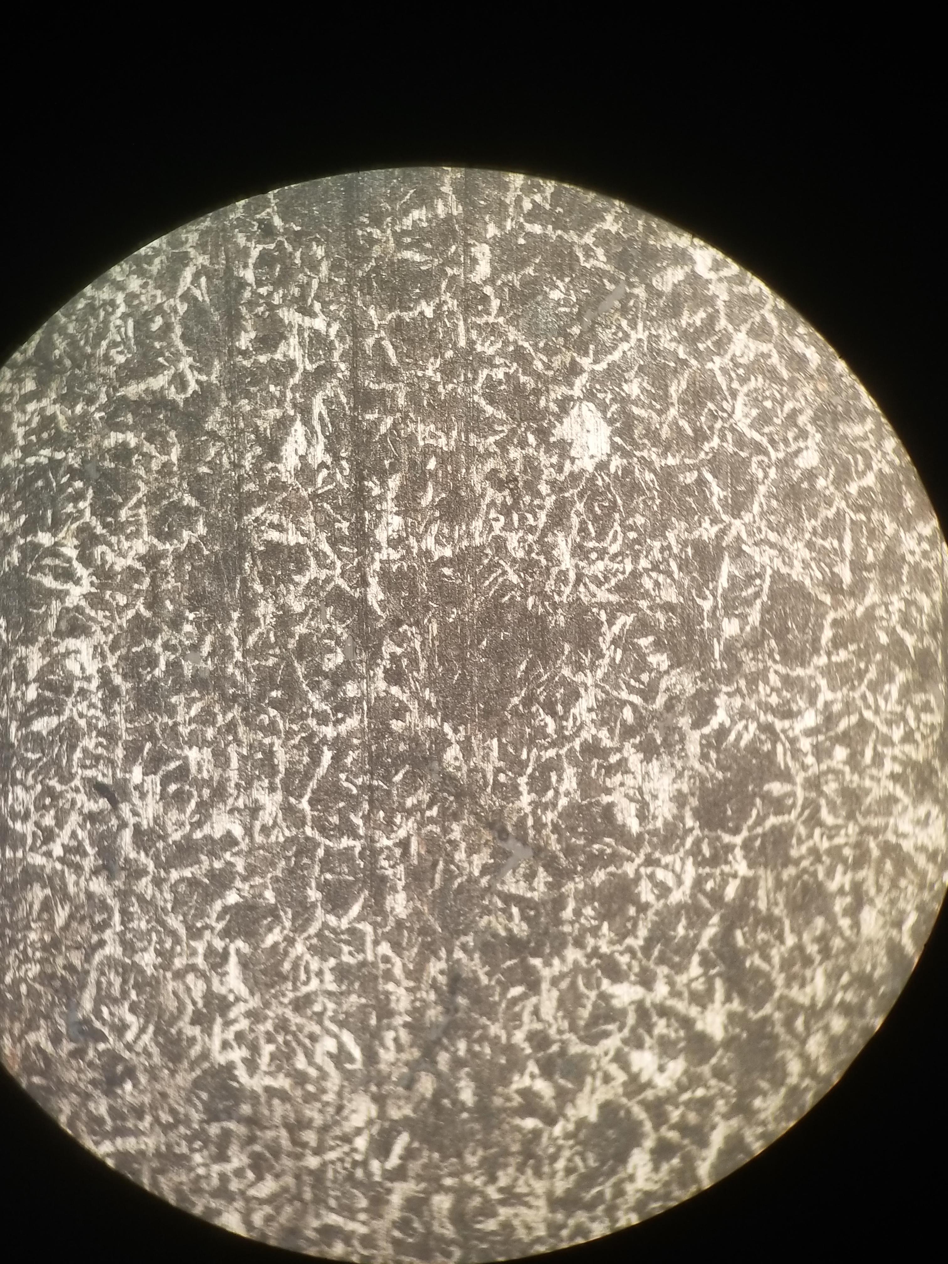

Was on the verge of chucking this bar today because it was not looking good under the scope. Decarb from the soak may have left a carbon content gradient that needed to be ground through revealing the true nature. As can be seen in the picture below. The amount of spheroidized cementite looks very low in concentration to be 1.3-1.4% to me. This took roughly 6 hours to turn into a short oblong bar. This is the picture (directly below) that made me feel like there just wasnt enough cementite. So here I am today, about to give up on the bar. Assuming I either cooked all the carbon out in the roasting by not protecting the Ingot well enough or I overestimated carbon content. Either way, after another 3-4 hours of forging, I felt the bar finally give under the hammer and feel like a beautiful piece of steel and not a hunk of cast iron. The watering pattern at the edge gave me a sigh of relief. Whew. Lucky me, the bar weighs over 4 pounds. Lots of blades if all remains well. -
