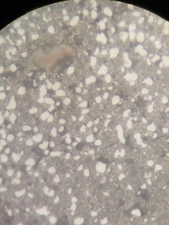

  5. Yea, I do. I recently purchased an refurbished an inverted metallurgical microscope. Finally got it running and decided to take a peek at the resulting blades. Spheroidization of the cementite is obvious :0 (Ferric etch. Not etched in 3% nital as is proper). Also 800x objective is being funny so not using it yet.

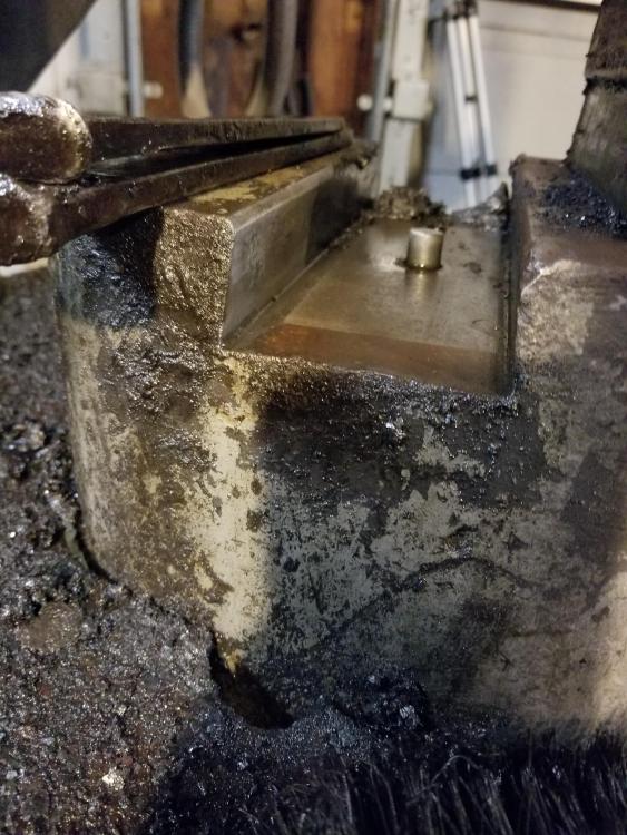

  8. I had him make me a custom quick change for my Murray. Then once you get it, you will need to take measurements so he can make you proper keys, that you will then have to custom fit with prussian blue/magic marker/dykem. Its a little tedious but worth it in the end. I had him make me like 6 or 7 custom keys for various dies.
  9. I helped make my upper (See thread down below in this section). And then I had Roger at LG make my bottom because it wasnt worth my time making another.
  10. Testing everything out. Works better than i had hoped. Die fits tight. Keys fit rather well.
  11. The dies came annealed. After all the machine work i normalized 3x at 1650F, and then hardened at 1550F in 10 gallons of Parks 50 which was at 75F. I am not overly concerned if the main body wasnt as hard as the face of the die. Since its roughly the same diameter as many of my 4140 hand hammers thats are hardened in Parks, i knew it would take on full hardness. Now for final fitting of the key.

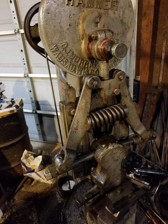

  17. It is amazing that i just found this thread, and i was replacing the tension spring for the first time on my 50# Murray. Like your Moloch, my Murray has some upgrades to the LG hammers you often see. Roger Rice is making up some keys and bolt down die blocks for my hammer as we speak. He said my hammer had very few hours on it, and thats after me pounding away with it for a few years. With that said, i havent forged with the new spring on, but before it was replaced, my 50# Murray has such ridiculously good control. It will forever be used as my blade hammer. Simply no replacing it.
  18. Ok so talked to the owner of little giant, and his ans for Murray and as indicated by my machine, that a Murray hammer has taper in tje female dovetails on the machine, but the dies are straight. I originally had my top die correct for my machine. LG's have a 2 degree taper, but my murray has a 1 degree taper. My top die that i milled the 2nd taper in as per instruction here can still work for my machine with a custom key, that they are also willing to make.
