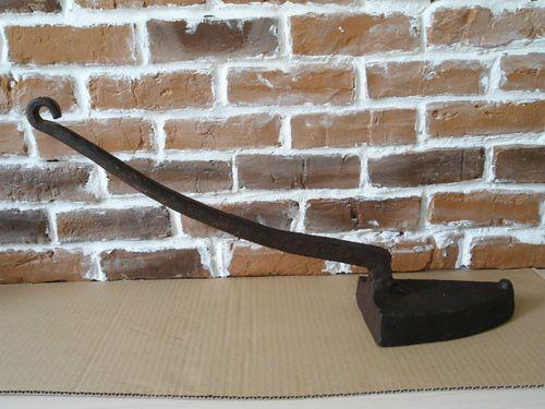

Hand Iron (Sad Iron)
Timothy Miller replied to MarcyOHH's topic in Blacksmithing, General Discussion
Is this a cooking forum or a forum about forging? I thought we were here to educate people about the possibilities of forged iron. I did a quick look on the google. I easily found many pictures of hand forged wrought iron sad irons. Its a bit of a heavy job if done full size but you could make a miniature iron. Depending on your skill and motivation there are many options. -
