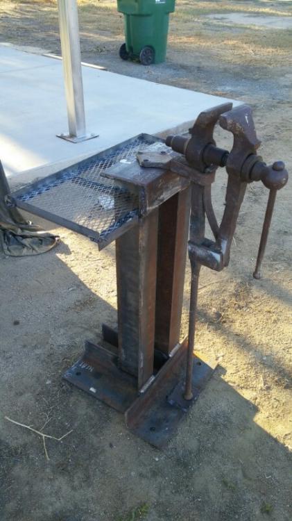

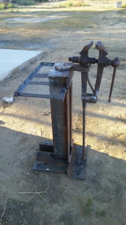

  3. i was wondering because with my vise it's about the right height without the extra pipe below the vise leg Poundhound
  4. clever idea Poundhound
  5. the plate under the leg has a hole in it to receive the part of the vice leg below the part of the vice leg where it flairs. I used a piece of steel thick enough so i did not have to make another hole in the base plate. Poundhound

  8. here are a few pics of a post vise stand I made over the weekend, still need to prep and paint it before I bolt it down. Made out of some 8"x 4" 3/8 angle iron I had lying around Poundhound
