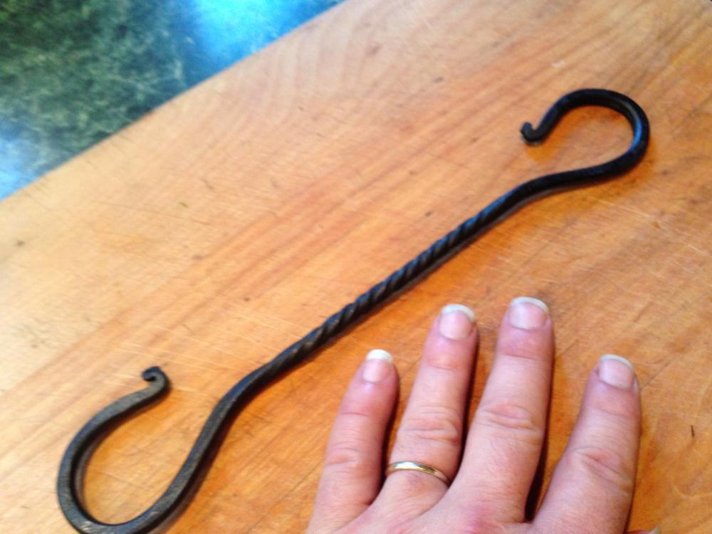

What we Call stuff. A turn of phrase...
Borntoolate replied to Borntoolate's topic in Blacksmithing, General Discussion
Frosty, any IT changes make me nervous. But I jumped in the Win 10 pool a few days ago and waited for disaster. At first my monitor was all effed up and icons were huge and distorted and I could not see or do what I needed to fix it. After a couple reboots all seems well. it is a bit different but not too different at all so far. Take the leap, what the heck. And mine was free with the PC I just upgraded so that made it a bit easier as well. -
its blurry and probably small. Just upgraded to windows 10 and have no idea what I am doing. But to me the "tip" looks like a swan... That is the Finial ehh? Looks like snipping tool worked! -
I like my fingernails long. They were recently trimmed. Generally she is jealous of my nails. we have them for a reason. Why does everyone trim them down to a nub? Forget my feeble hook and nails. Let me see some pics of your stuff and the cool names for them! -
Words mean something, they can also be interesting in how we use them. I am calling this a reverse S hook with swan head tips. Please provide pics and names as this post leads you. Hate to say it but this may be my first pic post with the new format. Hope it doesn't suck too bad. And the swan head tips are not so evident... maybe.. We'll see how it works. My intent is not to put tradition on it's head. But rather to unleash folks art in the form of a pic and allow them to express their personal descriptions of that art. My art is obviously simple and easy. Well I have said enough. I hope we can all get some cool ideas for our art and maybe some cool phraseology to got with it...
