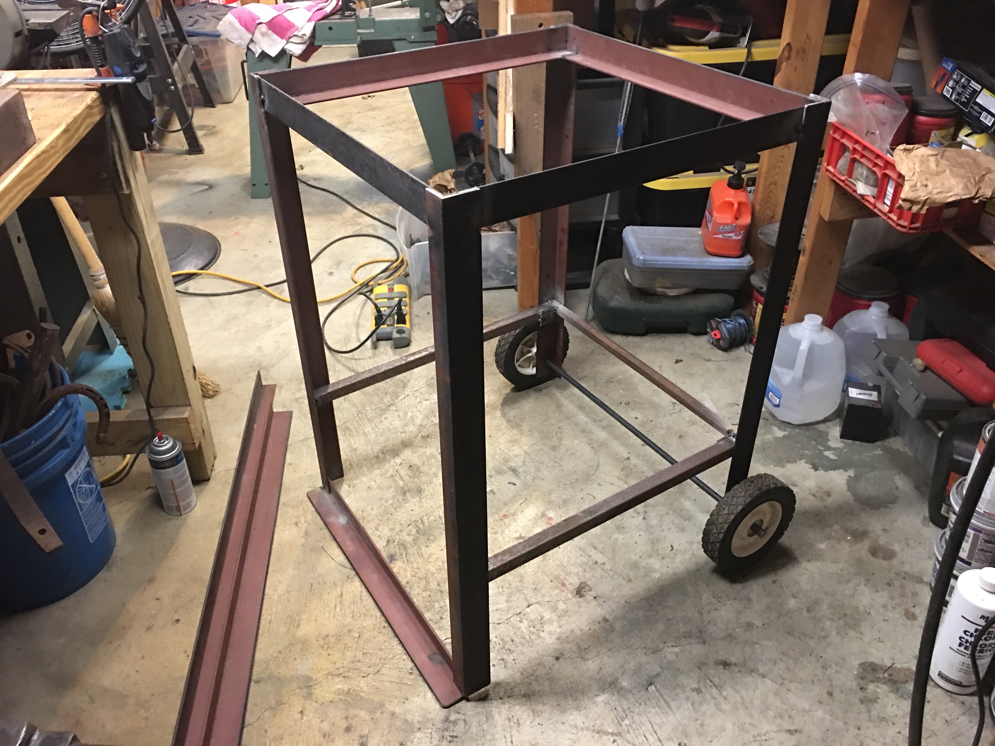

Derek Melton Posted October 13, 2016 Author Share Posted October 13, 2016 Thanks. The purpose will primarily be to hold my small propane forge and to have a hammer and tong rack handy. After thinking about it, attaching a post vise may be something that I won't use quite as much as I thought I would so I may attach a light vise to it. For now I would likely not be doing a whole lot of heavy vise-related pounding during a demo, until my experience and skill deepens. I spent some time last night working on it and this is what I came up with, so far. I still plan to weld on some side racks for hammers and tongs and will probably put a wood board top on it for now. I'm really new to welding but I'm happy with the results so far. That's 3/16 angle iron along with some scrap steel I had laying about and it seems plenty stout enough. Quote Link to comment Share on other sites More sharing options...

jlpservicesinc Posted October 15, 2016 Share Posted October 15, 2016 On 10/13/2016 at 0:27 PM, Derek Melton said: Thanks. The purpose will primarily be to hold my small propane forge and to have a hammer and tong rack handy. After thinking about it, attaching a post vise may be something that I won't use quite as much as I thought I would so I may attach a light vise to it. For now I would likely not be doing a whole lot of heavy vise-related pounding during a demo, until my experience and skill deepens. I spent some time last night working on it and this is what I came up with, so far. I still plan to weld on some side racks for hammers and tongs and will probably put a wood board top on it for now. I'm really new to welding but I'm happy with the results so far. That's 3/16 angle iron along with some scrap steel I had laying about and it seems plenty stout enough. If you are using a gas forge you should be a little careful of having the vise mounted to the flame that supports the forge.. As you bang on the vise it will transfer some of the vibration to the forge and can break and dislodge your liner.. On a coal forge it doesn't matter.. A old fashioned truck or car rim will work.. Just add either a wood or metal tube and plate and bolt it down.. Though you might not feel your smithing skills are up to par, as you advance you will be thankful to have your equipment properly mounted and not having to do it again.. Both saves time and money in the long run.. Wasting your time chasing a vise around will detract from the quality of work.. Good equipment properly mounted makes a world of difference especially in the beginning.. As your skill set improves, one can adapt more easily to unfamiliar or less than ideal situations and still make a top notch product because they have a good base line skill set.. Quote Link to comment Share on other sites More sharing options...
