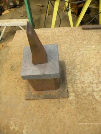

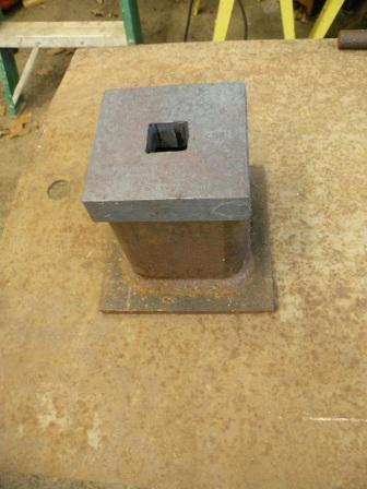

DSW Posted December 30, 2015 Share Posted December 30, 2015 54 minutes ago, J_B said: , but was wondering what would be done for a hardy (an additional piece of round scrap could substitute for a horn I think)? . Build a "portable hole" to use as your hardy hole. Quote Link to comment Share on other sites More sharing options...

J_B Posted January 4, 2016 Author Share Posted January 4, 2016 Thanks for the advice on hardies--I have a bench vise that may or may not be mounted sturdily enough for hammering, but I do have access to a welder so I could make a portable hole (thanks for the photos DSW!). The seller sent me a couple photos showing the bottom of the anvil, though I think I'm leaning toward finding some scrap to start with while I conduct a more patient search. Do they help narrow down the manufacturer? Quote Link to comment Share on other sites More sharing options...
