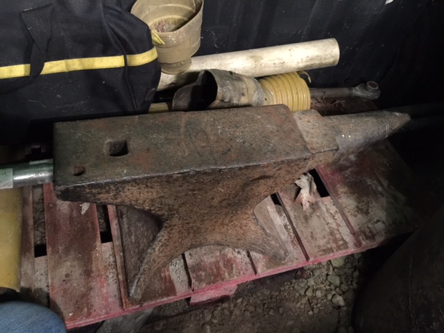

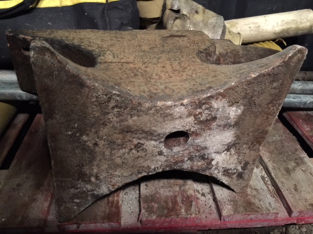

  15. Ok, I just looked at this anvil tonight in the dark - by tractor light. It was painted black a long time ago, and now is mostly rust. With the light I had I could find no markings on either side - looked with my eyes and by feel. It has seen a lot of use over time, but is in pretty nice shape. Rebound is not awesome, but there is some. It's fairly quiet. I don't see or feel any casting parting lines. There is no obvious line from a top plate. Please take a look at the pics and toss your opinion out. It would be a nice size increase over my 84lb Wilkinsons, but the appearance is making me think it's a cast copy of a good anvil. I was really rushed looking at it; with a little more time to study it I could have been more confident. So, what's really confusing me - are there ASO's of this size and looking this much like a typical London Pattern anvil out there? Thank you!
