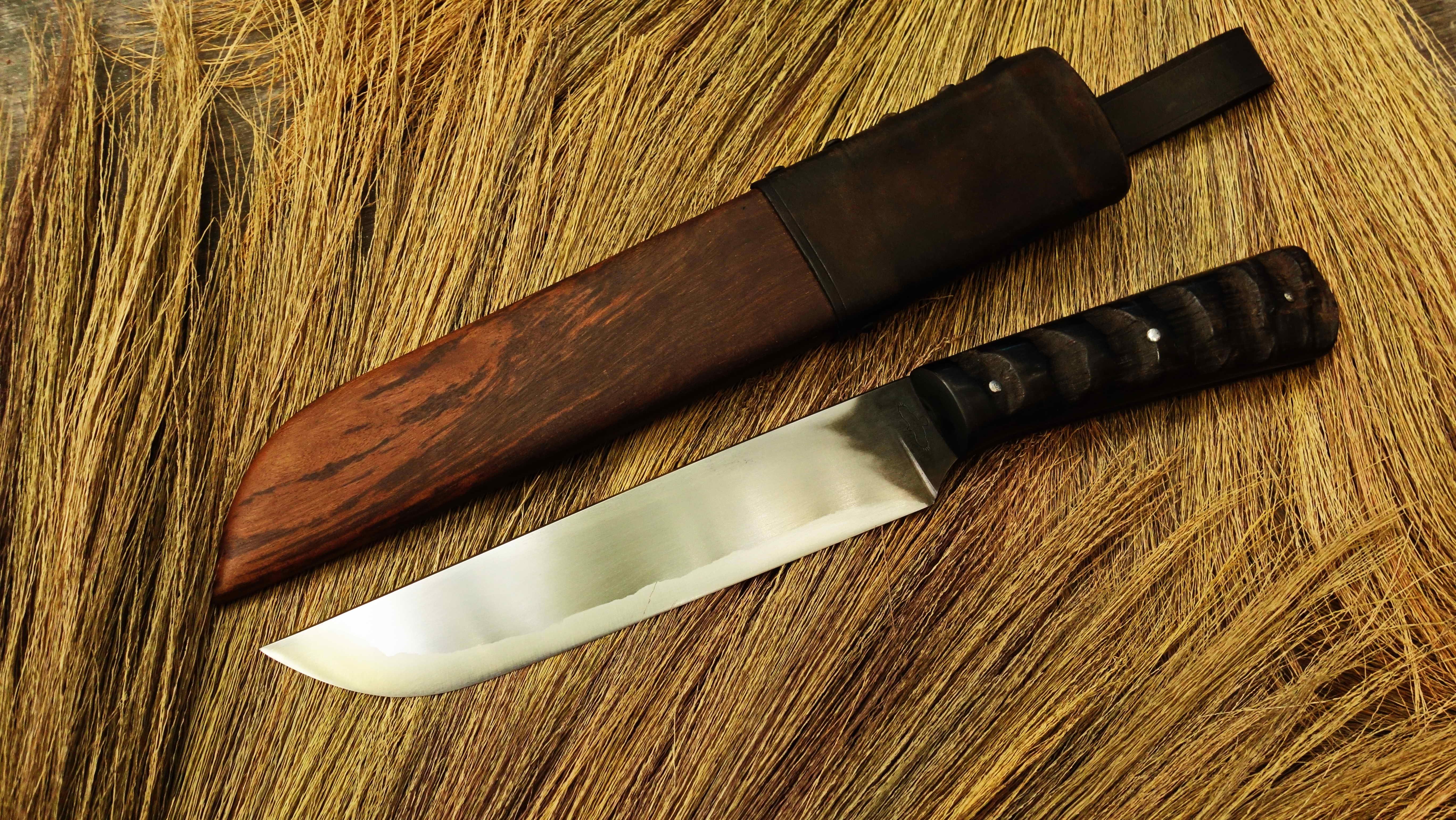

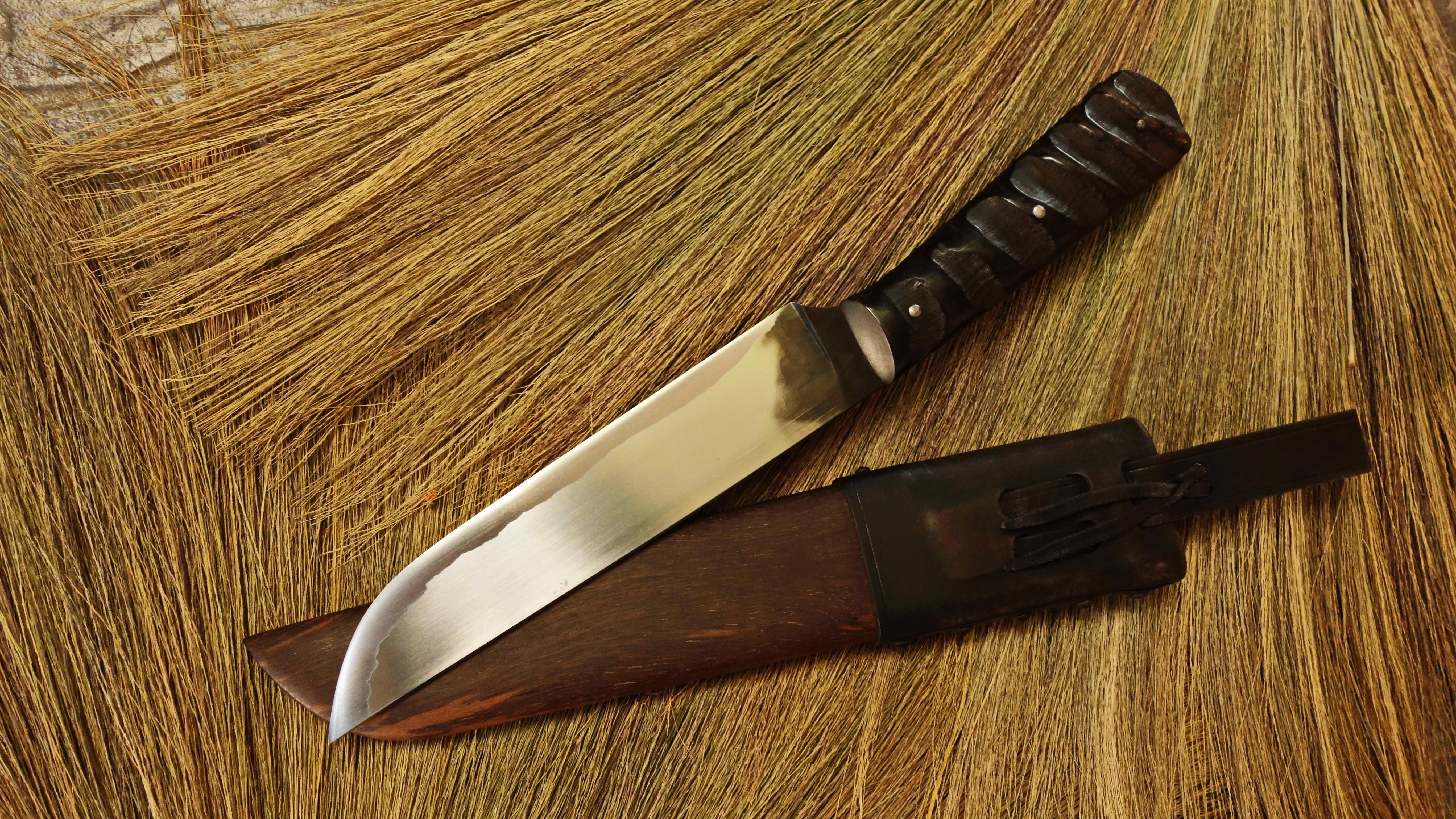

O1 flat tang blade with 185 mm (7.28 inches) blade length and 3 mm width.
For the handle I took steel pinned Thomson's Gazelle Horn Slabs.
The sheath is a combination of half tanned leather, unknown hardwood and buffalo horn.

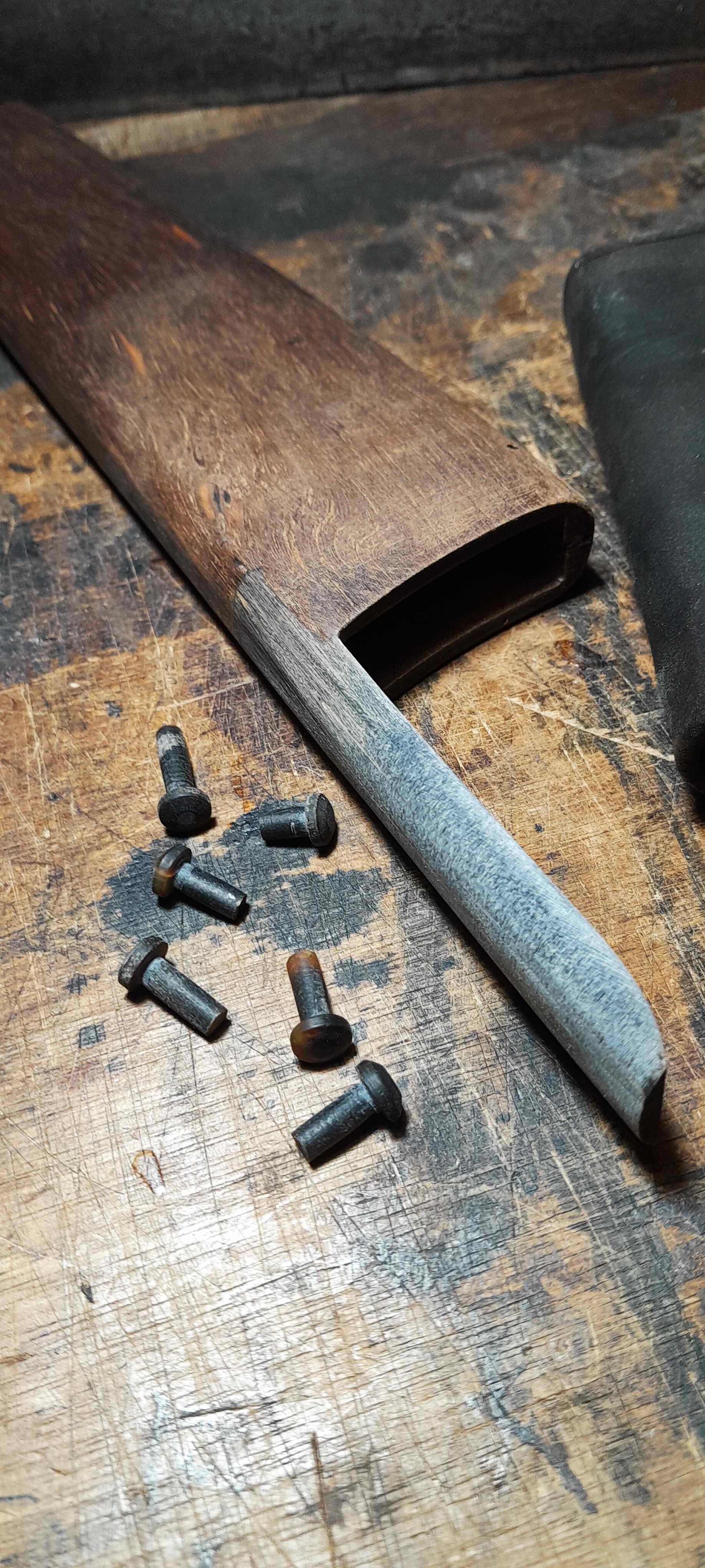

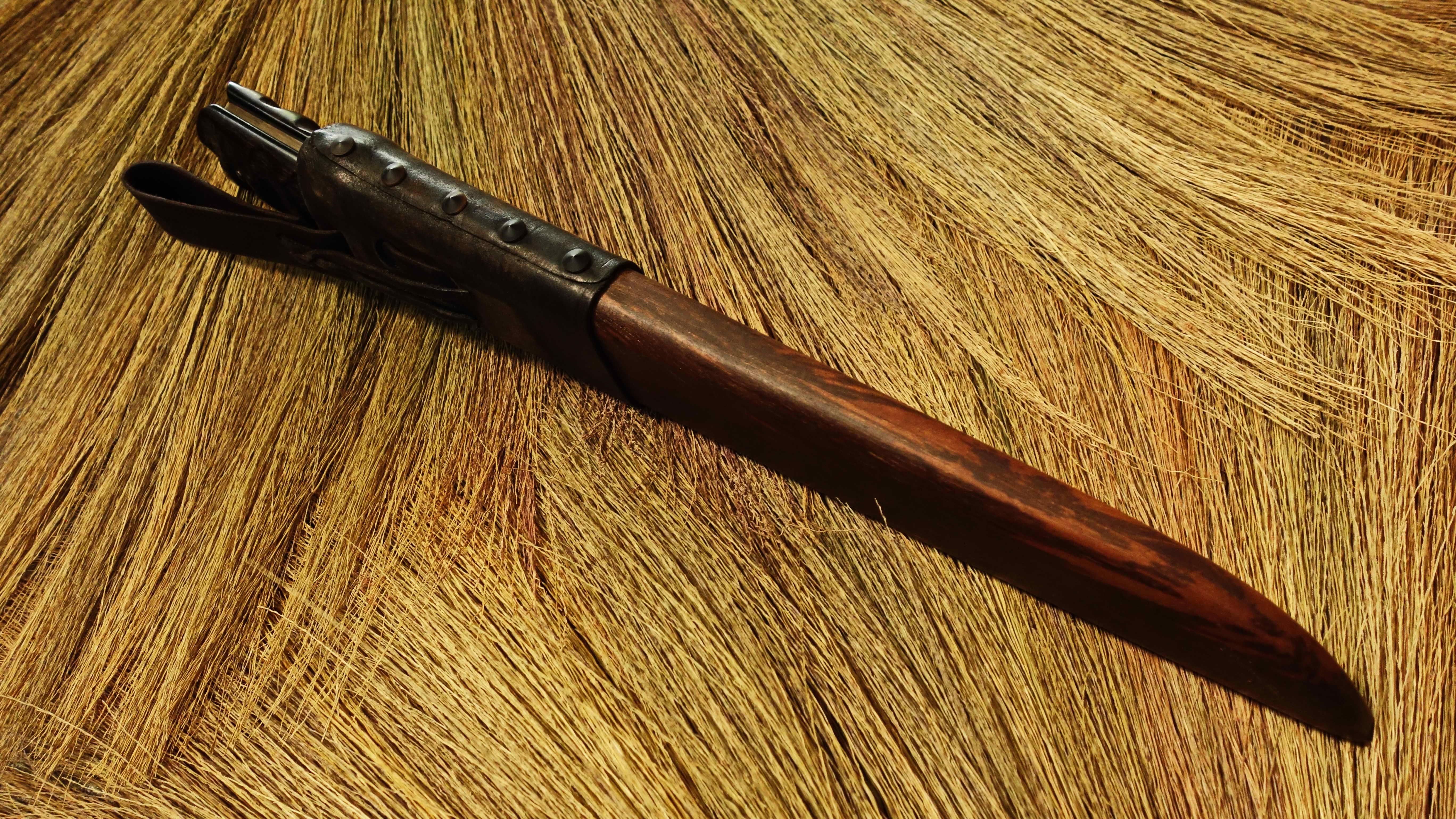

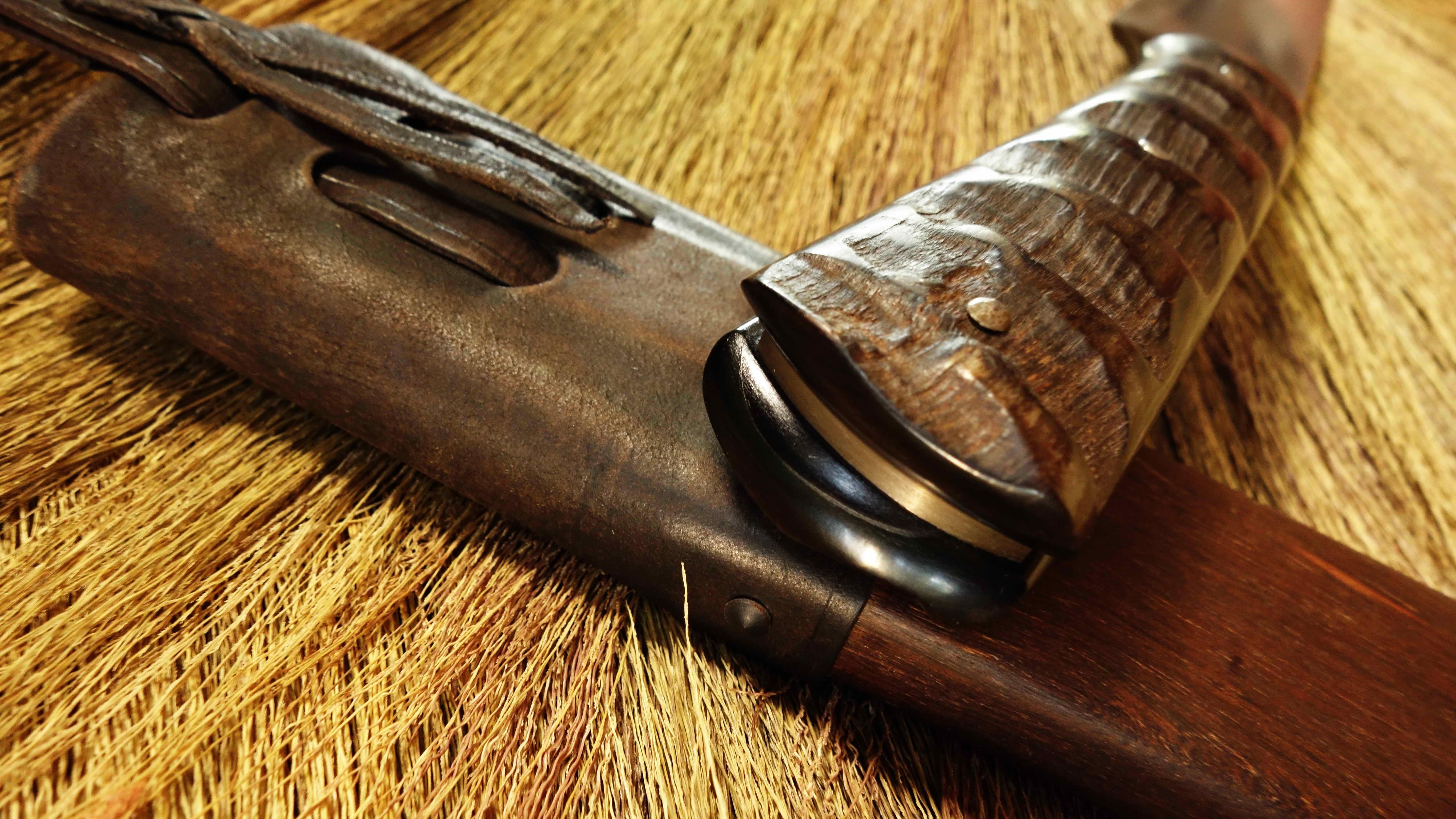

Since the seam on the sheath of a knife is theoretically the weakest point...theoretically...I've replaced the stitching here with horn nails. These are glued into a horn frame on the cutting edge side in the leather quiver using a strong adhesive...a remarkably stable material combination.

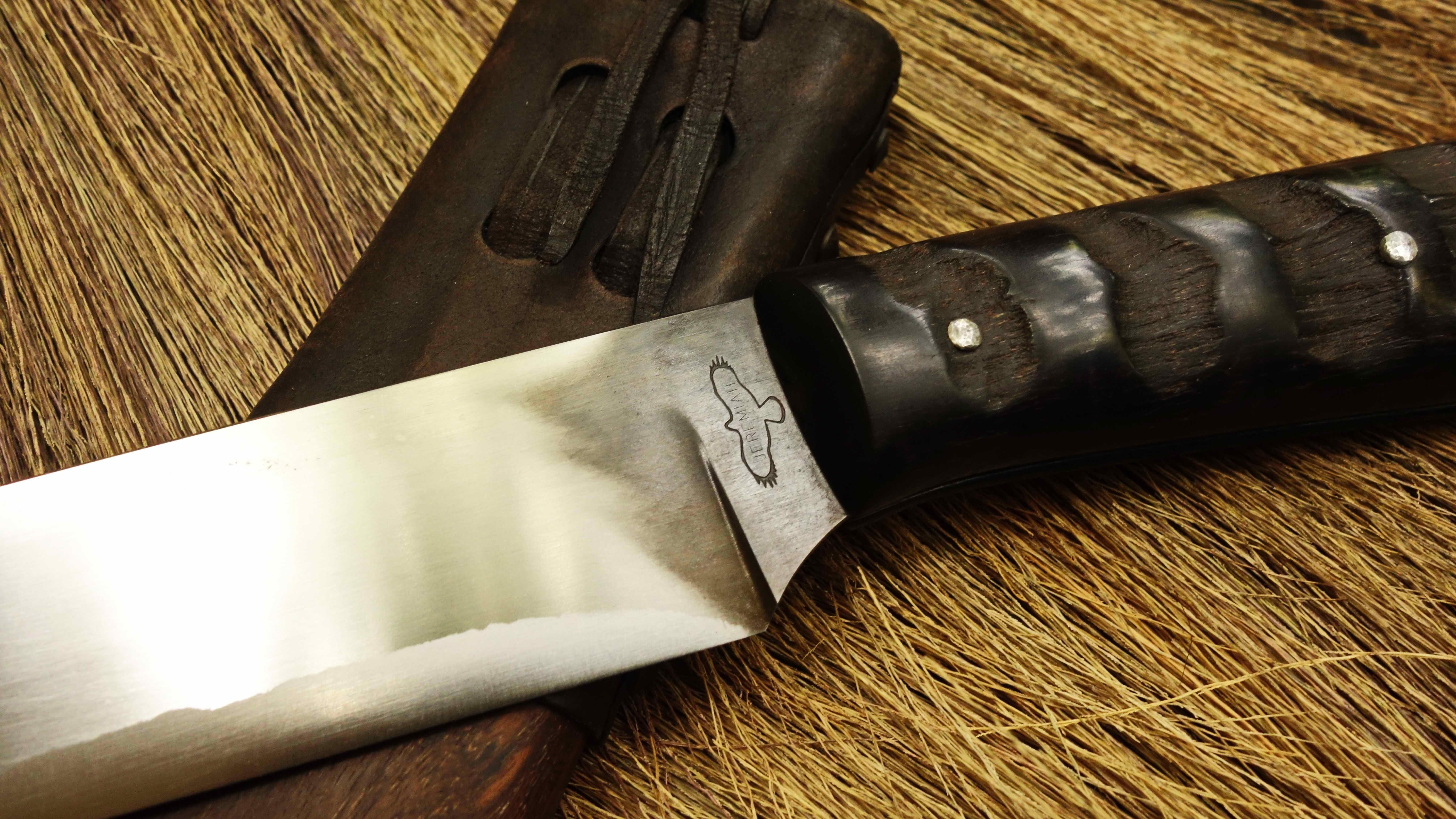

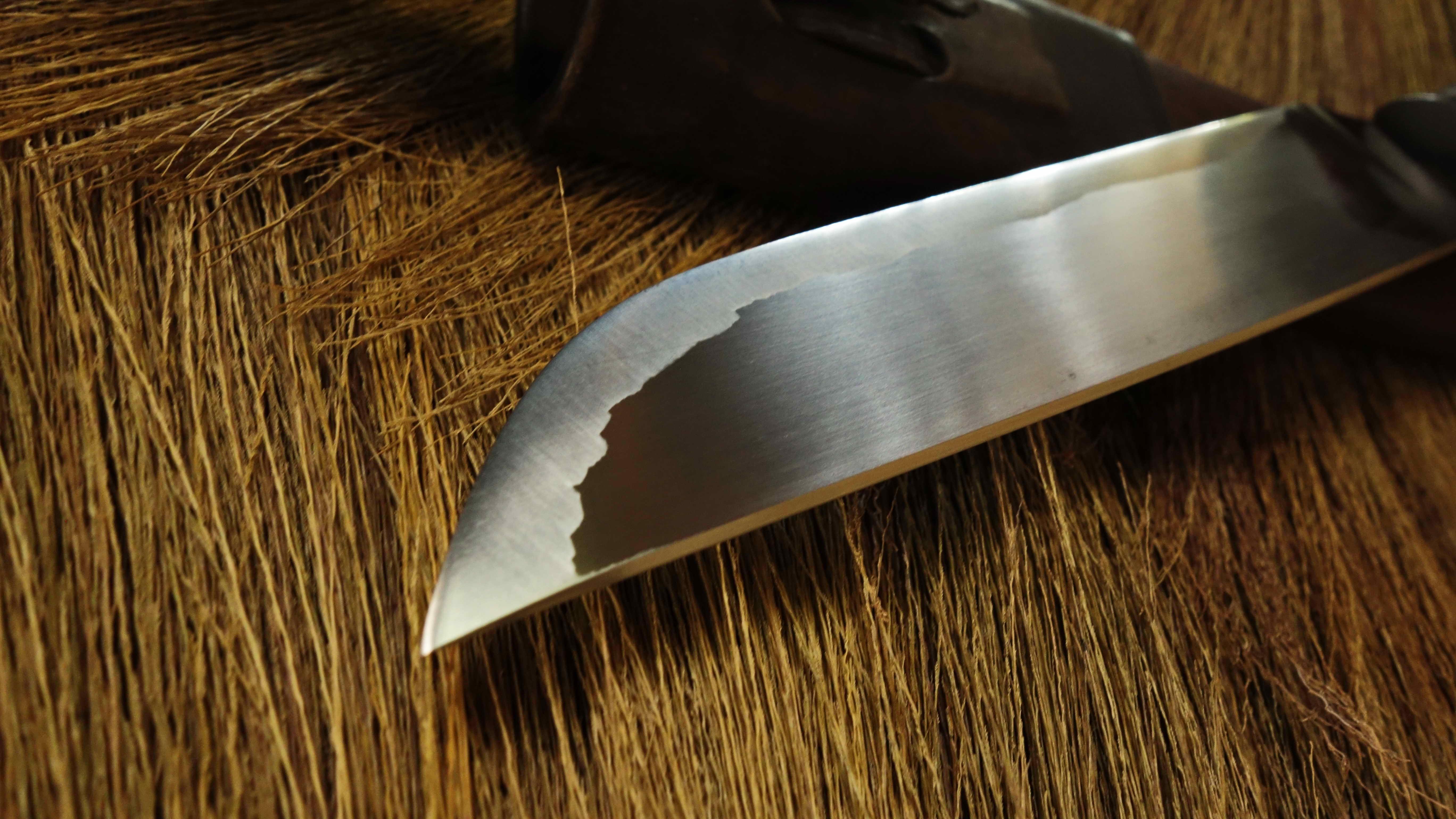

If I may nitpick. The bevel looks uneven grinded.
Is that the bevel, or a really popping hamon?
Which bevel? The flank bevels, the edge bevel or the back bevel?
I’ve never heard of horn nails as a replacement for stitches on sheaths. (Honestly though, I’m not that much of a knife person.) Is the construction method something you’ve seen before, or a fresh idea?
Either way, it’s very cool and makes for an interesting touch on a beautiful knife.

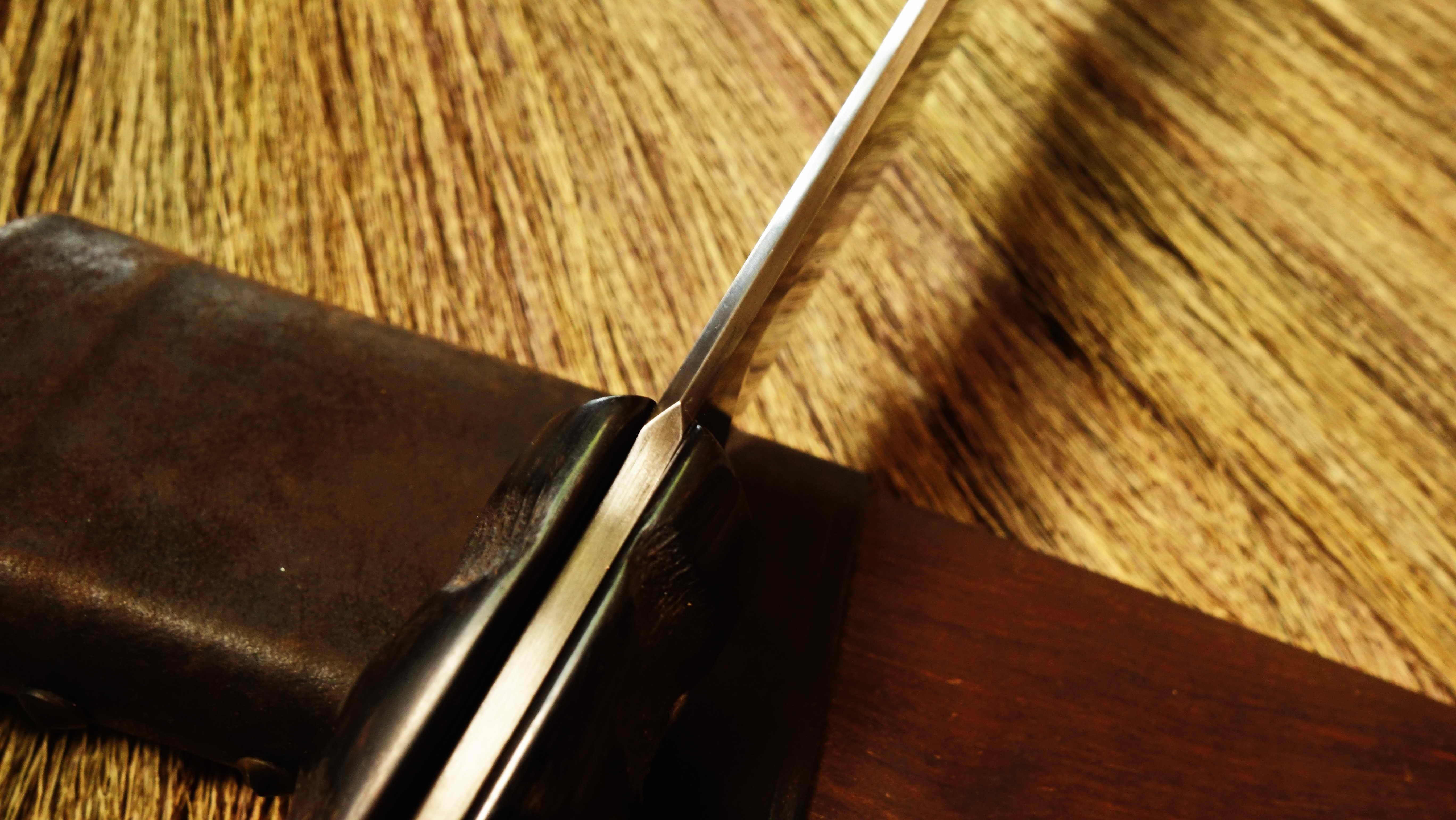

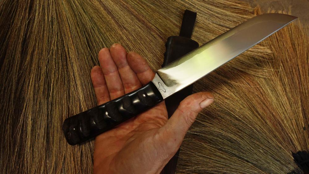

The edge. You can see it on the 2nd photo. Or is a line from hardening?
No it is not a line from hardening (Hamon), nor a Temper Line and it is not the edge. It is just a differently polished Section of the Flank.
Sisal polished lengthwise and crosswise, that gives the impression of a Hamon...and sure it is different on each side....like a Hamon mostly is.
I thought it looked more interesting....at least in my eyes.:)
Keep it fun,
David
David, I must apologize somehow I overlooked your question.
With that idea I came up by myself, in the search of more toughness on sheaths.
But the fact I didn't saw that yet does not mean it didn't already exists.
Thanks David!
The same here, sorry Hefty I didn't answer direct to your question.
Cheers
No worries, Templehound. I really like the effect.
