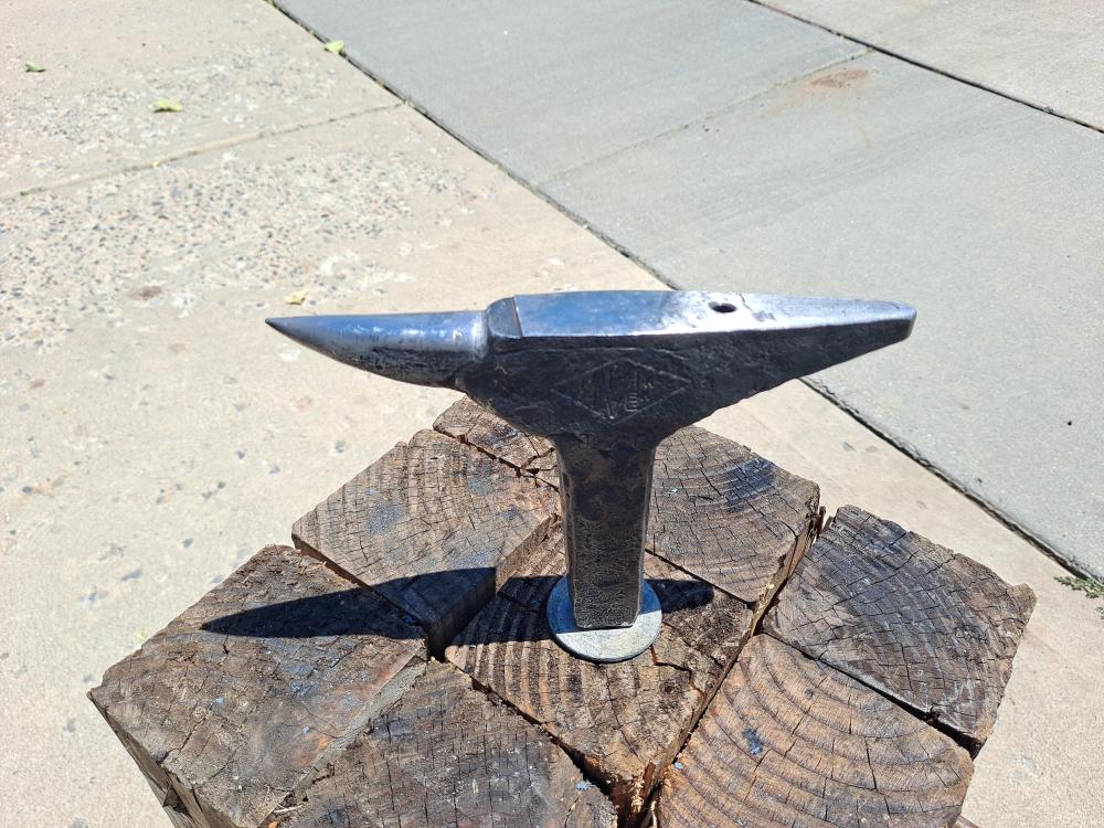

warthog02 Posted August 3, 2025 Posted August 3, 2025 I finished making this forged stake anvil using traditional methods. It is made of 6 pieces of wrought iron and a hardened steel faceplate all forge welded together. Here's a video on making it Quote
Frosty Posted August 3, 2025 Posted August 3, 2025 Thank you for the video, I really enjoyed it. It made me a little jealous how easily wrought iron welds, I've only had a very little experience with WI. I was a little surprised you didn't do more drawing the long tapers on the horn. Not criticizing just noting differences in our techniques. I certainly can't argue with your results, it turned out beautiful and a good useful tool. Well done. Thanks again. Frosty The Lucky. Quote
CrazyGoatLady Posted August 4, 2025 Posted August 4, 2025 I enjoyed the video and very nice work! Quote
FlatLiner Posted August 5, 2025 Posted August 5, 2025 Awesome job, I am jealous you have access to the blacksmith shop at the farm. You should have sent me a message I might have been able to come over and helped you out. Quote
warthog02 Posted August 6, 2025 Author Posted August 6, 2025 Thanks all for replying. I'll see if I can have you over for the next project Flatliner, my powers have quadrupled since last we forged together >:) And to Frosty, Longer horns would have probably been more useful for sure, I partly just didn't want to push my luck and accidentally burn something. I also have a pretty long bickering that I can use if I need something like that. Quote
Frosty Posted August 6, 2025 Posted August 6, 2025 I wasn't talking about horns on the anvil you forged. I was commenting on my preference for using the horn on my anvil as a bottom fuller for drawing and spreading work. It was an observation of our differences in technique, not a critique. Frosty The Lucky. Quote
warthog02 Posted August 6, 2025 Author Posted August 6, 2025 Ah I gotcha, yeah I do sometimes for really heavy drawing out but at a welding heat I can get a bit carried a way with that method. Quote
