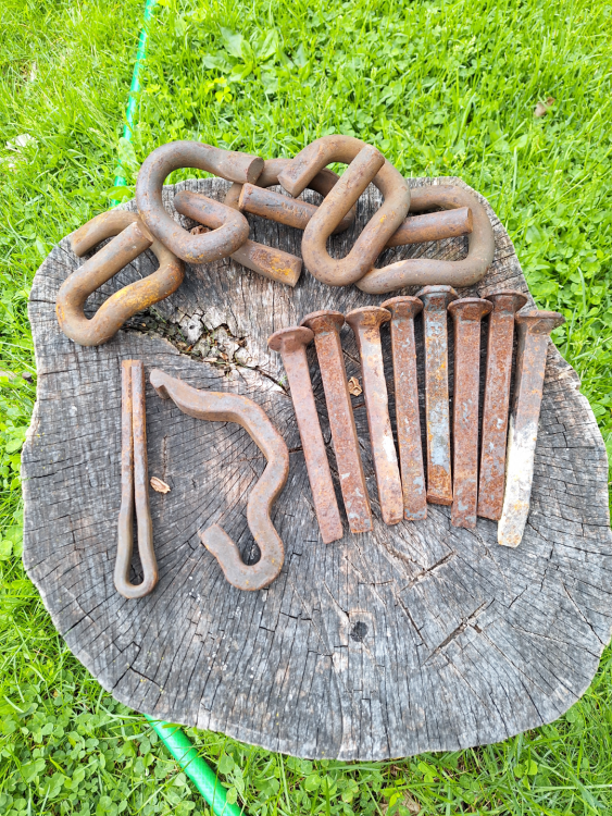

Beginner blacksmith here. Sorry if this is posted in the wrong section. I have some old railway scrap that I would like to work with. I tried to find info on what the Pandrol clips are made of and came back with 60Si2MnA. Not 100% on that though since I don't know how old these are. My main question is what would be a good way to heat them and straighten them out? Hammer it while heated in a vice to gets the bends relatively open then finish on an anvil? Has anyone ever worked with these? Just looking for tips. Thanks!

Your rail clips, i have actually never worked with them but i do know they are pretty tough material. They will make good tooling. As far as straightening them, yes... no... do how ever is easiest for you. For the round ones, i would heat them up. put them in a vice and use a piece of pipe to bend them straight, the square one, same thing with the "U" bend, the rest of it just heat it up and straighten on the anvil.
Those RR spikes, if they have "HC" on the head those are "high carbon" i put that in quotes becuase they are not high carbon but higher carbon than a standard rail spike. IIRC they are about .5 or .6 carbon. If i am wrong some one should be along to correct me shortly.

Your method for uncurling the tips will work.  Use a length of pipe to get more leverage.
When straightening any bend always hit it from the outside of the curve with 2 points on something solid like the anvil.  If it is a U shape with parallel legs use something wedge shaped to open up the legs so that you can turn it over and hit the outside of the curve.

Kinda late joining this conversation. Panadrol clips are spring steel, what number i don't know. But be aware that some are zinc coated. Those you would want to stay away from.
If I were to wire brush some of the rust off of them and then put it in vinegar would that be a way to determine if they are zinc coated?
If you are unsure yes soak them for at least 24 hours. Regardless of if there is zinc or not the vinegar will clean them up.
Something you may hear among blacksmiths "in rust we trust". Zinc is a corrosion preventative it is supposed to keep metal from rusting, so logically if it is rusted there is no zinc. Those being rusted USUALLY, and i stress usually, means there is no zinc. However i have about 100' of 3/8 round that i salvaged from a barn that is rusted and is galvanized. They are maybe 50 or 60 years old and great material to work with once the zinc is cleaned off.
Watch your material when you heat it  and as it cools. If you see any thing that is "not right" set it aside  immediately, somewhere a good ways away from you that is. That is how i discovered these rusty 3/8 round bars were galvanized. Looked like a yellow powder on the heated part as it cooled.
 I am in no way, shape, or form saying that you should throw the metal into your fire and see if it turns yellow. If you have doubts, soak them in vinegar, wont hurt anything.
I've worked with Pandrol clips - it needs to be worked at a high heat - above 2000 degrees F.  Tough spring steel, you can make decent tools with it.  I've never seen any with a zinc coating as all of mine are nice and rusty.
Pandarol clips, like rail, are a mid carbon steel, say around 60 points of carbon-ish, but way, way harder to move due to the alloying elements. Oil quench if hardening. Work hot, and plan for breaks if not naps. Spikes are mild steel, maybe .02 percent carbon and for "HC" around .03. They're better by far for decorative elements than anything else. They make good slingshots and nice heavy bottle openers with a good twist. One of my favorites if you can get them is the big heavy bolts for fishplates. Broken knuckles are also not terrible makeshift anvils/swages.

Both the pandrol clips and the track anchor will make good chisels and punches. I also made a small raising hammer from just such an anchor.
