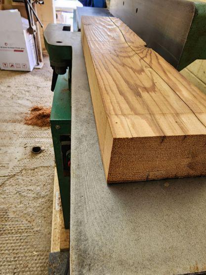

So one item I spent some time on this weekend was a Grizzley 6" Jointer.

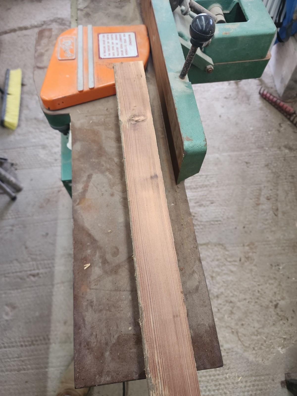

I powered it up and ran a board through it and it worked GREAT!!.

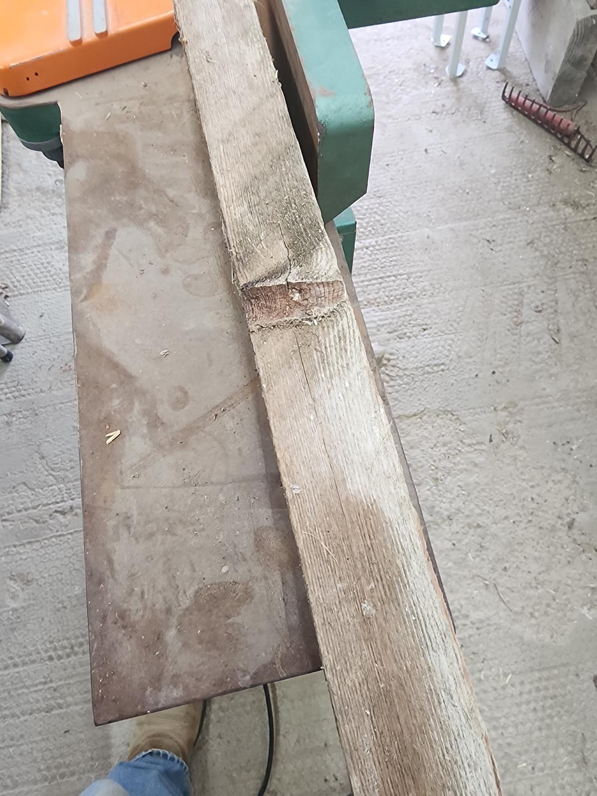

I ran a scrap of rough sawn 2x4 through.
This is the other side of the board for comparison.
One pass looked great

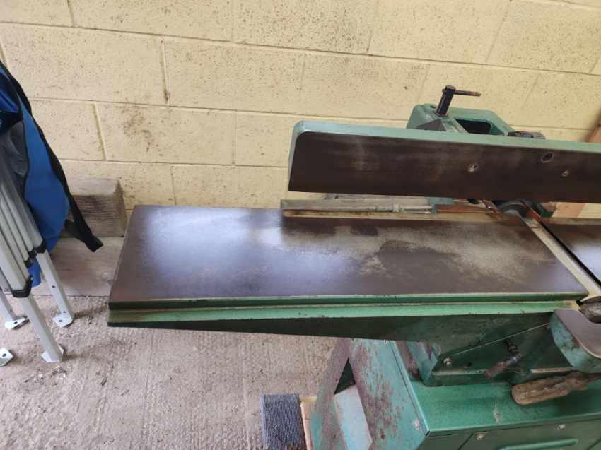

As you can see the bed is pretty rusty,
So with some WD 40 and a scrub pad.

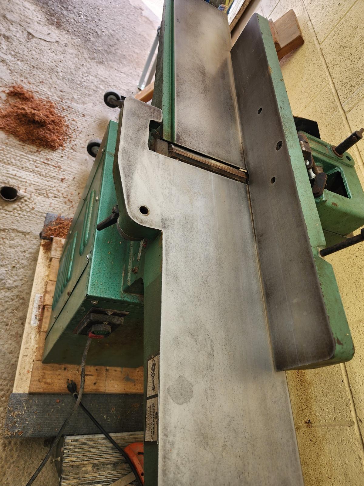

Here is yesterdays couple of passes
Then I coated in WD40 and left it over night.

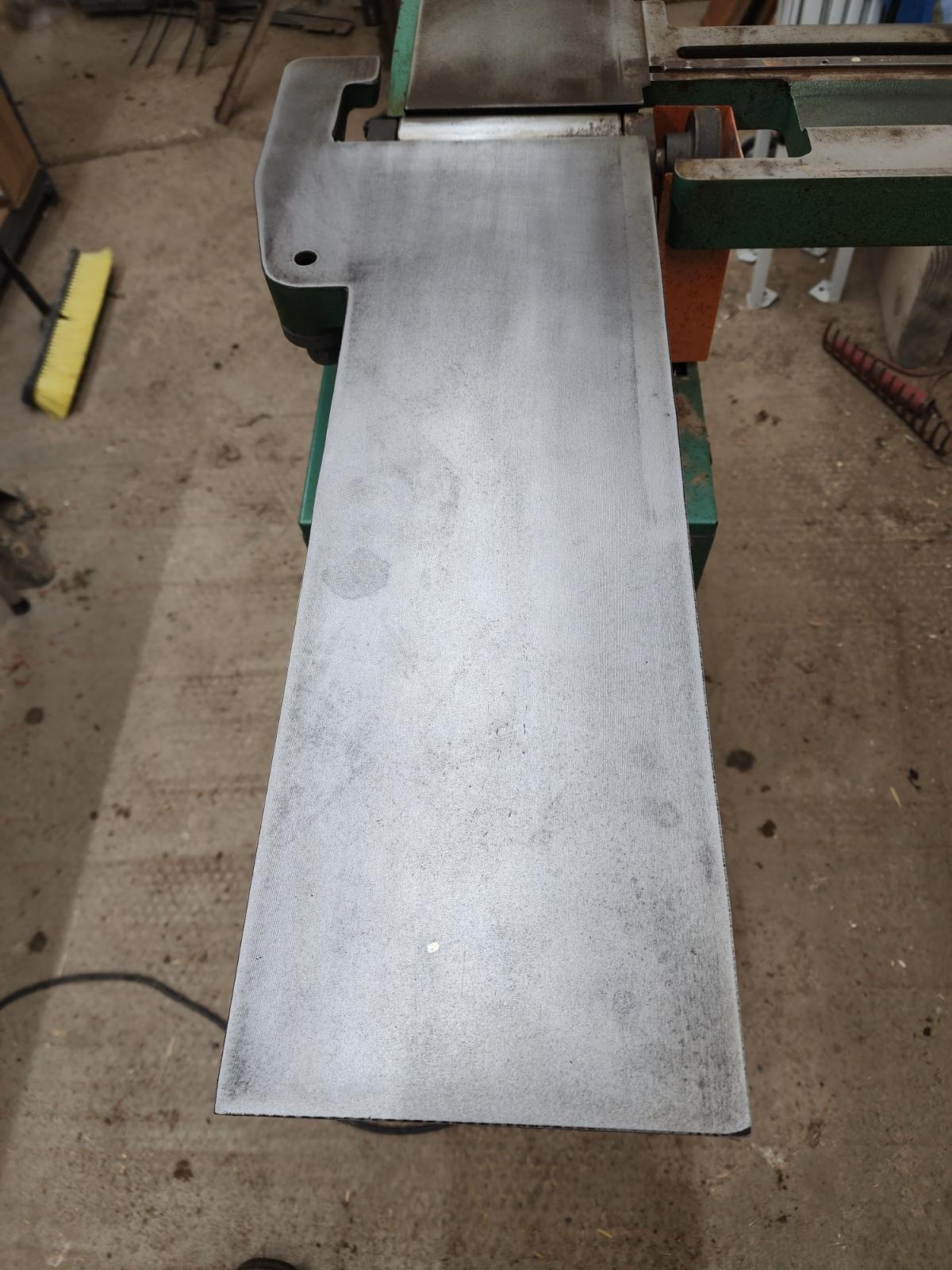

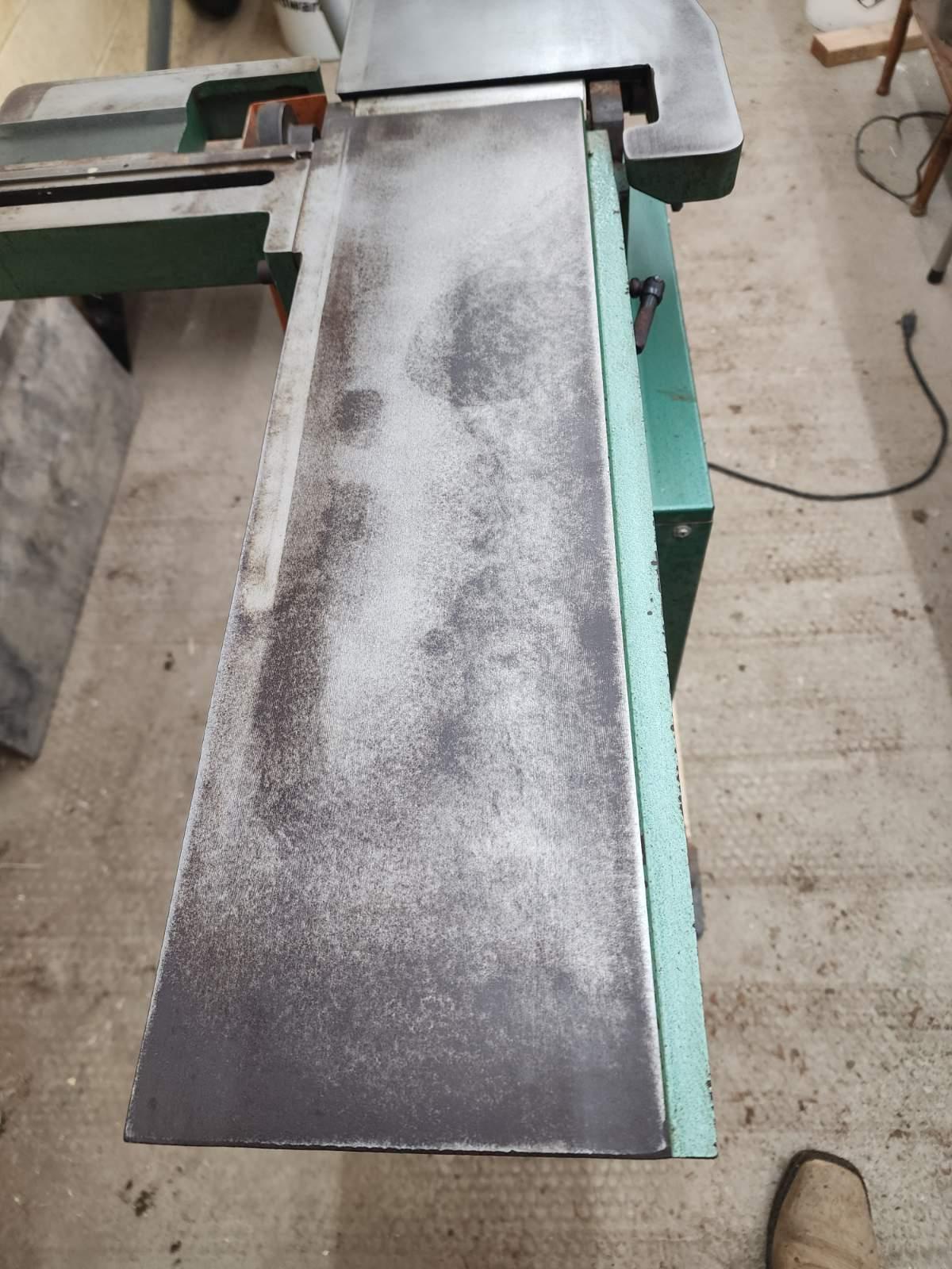

And here is todays results.
The million dollar question is would you do a couple more scrubs trying to get rid of the stains or spots?

Nope. You have it in great shape, certainly well enough to use. Besides, the stains and spots add character and do not impact the precision of the surface for its intended purpose.

Not unless it stains the wood. It looks good now, are you going to use it or sell it?
thank you larry and frosty,
I think I will finish it up tomorrow, put it all together and give a few practice pieces a run through.
I plan to give the tables and the fence a lite coat of pastewax or beeswax.
