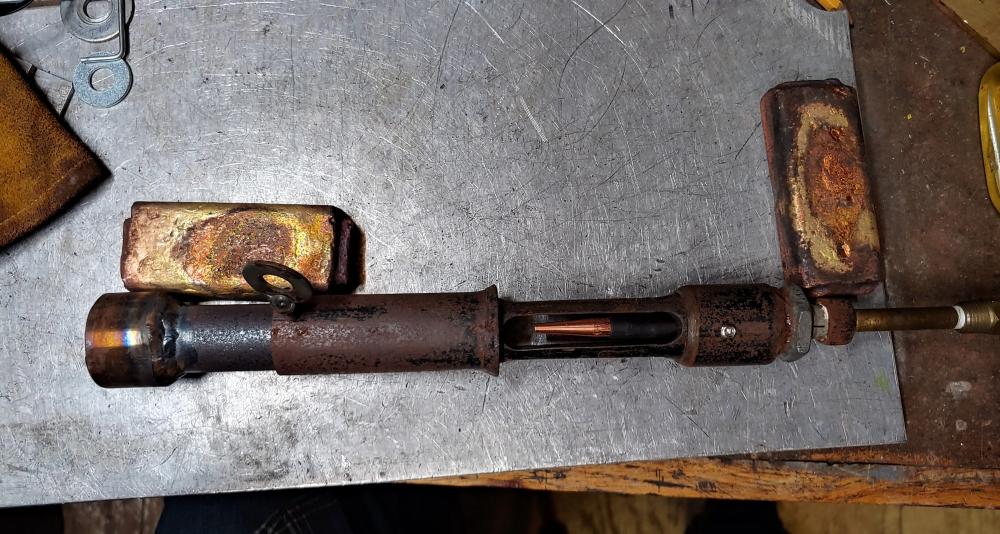

Mikey98118 Posted April 9, 2023 Share Posted April 9, 2023 How about a photo showing your burner's flame retention nozzle, without flames, and in good light. I don't think you're going to do any better, while using that nozzle. Quote Link to comment Share on other sites More sharing options...
Frosty Posted April 9, 2023 Share Posted April 9, 2023 Jim: please edit the videos out of your post, posted straight off a cell phone means they're enormous downloads that don't show as much useful detain as a still pic. They have been wasting bandwidth on my high speed connection for a couple minutes now and I have 0.01 of 0.6 seconds of one and 0.01 of 0.30 seconds of the second. Not hitting the start button shows me all I need to see. Unfortunately the only way to stop the download is delete your post. Not that I don't want to help but I need decent information and videos suck. As Mike requests still pics in good light would be useful, I'd like a look at the entire burner and some details about it's construction. Frosty The Lucky. Quote Link to comment Share on other sites More sharing options...
Jimw3326 Posted April 10, 2023 Author Share Posted April 10, 2023 I apologize for this. I'm looking but don't see how to edit or delete. As requested. 3/4 pipe with .33 tip. I was trying to get a screen grab off the videos but no luck. I'll relight it again and grab some pics. Quote Link to comment Share on other sites More sharing options...
Mikey98118 Posted April 10, 2023 Share Posted April 10, 2023 Okay, so this is someone's interpretation of a Mikey burner. Unfortunately, they did it WRONG! To begin with, the air openings are slots; not rectangles. Sots are easier to make, and after all Hybrid burners get away with slots, right? Yes, they sure do. But those slots forward ends dump the incoming air into a reducer fitting, which supplies that extra spin that those slots couldn't achieve on their own. In other word that type of burner is a cross between a tube burner and a linear burner; thus the name Hybrid. So square up the formard and rearward edges of those slots, to make rectangles. Then bevel the forward edges on their inner surfaces, leaving a knife edge on their out surfaces. See to it that the rearward edges of the new rectangular openings are also beveled. But bevel their outer surfaces, leaving knife edges on their inner surfaces. Next, move the MIG tip forward so that its front edge is 5/16" away the the forward edges of the rectangular openings. After you do that much, we will see what else is needed. Yes there are more things wrong with this burner, but they may not need to be changed. Quote Link to comment Share on other sites More sharing options...

Mikey98118 Posted April 10, 2023 Share Posted April 10, 2023 If you want to go back and dig up what was said, by who and why, name the page; we will go there. If you want to fix that burner, I have given you the needed directions about where start; take your choice. Quote Link to comment Share on other sites More sharing options...
Frosty Posted April 10, 2023 Share Posted April 10, 2023 Don't sweat it Jim, we only have IIRC 24 hours to edit a post. For future use: in the upper right of of a post are e dots. select them and a menu will open, select "edit," make changes and save. WOW, you have to be careful who's "plans" you follow, some are junk or worse some outright fakes to get "likes" or whatever. Frosty The Lucky. Quote Link to comment Share on other sites More sharing options...
Mikey98118 Posted April 10, 2023 Share Posted April 10, 2023 Oh, I might even have been the one who approved what I saw in a previous photo. What I am assuming is that any such a photo showed far less of the burner than this one does. Quote Link to comment Share on other sites More sharing options...

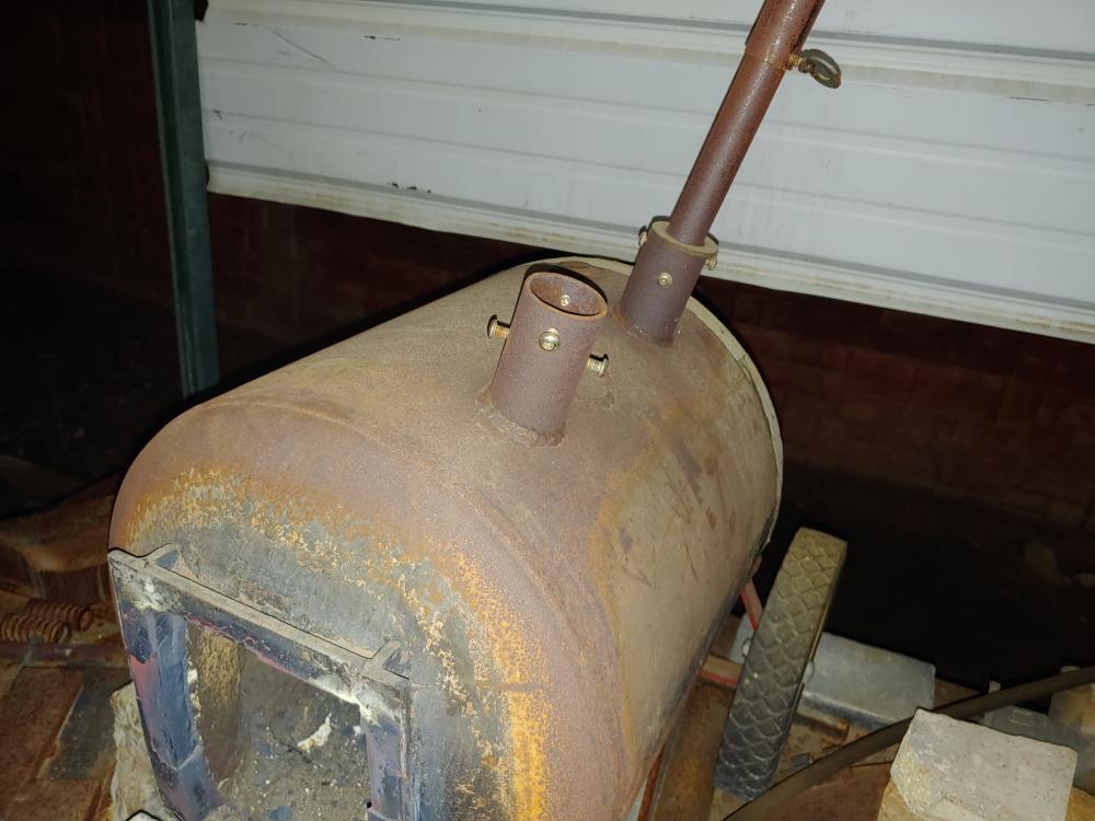

Jimw3326 Posted April 10, 2023 Author Share Posted April 10, 2023 Didn't have to look too far, previous page. On 12/10/2022 at 4:08 AM, Jimw3326 said: So I go to remove the burner and no-go. Turns out the exit has belled, pretty wild. Also disintegrating. It's about an 1 1/2" to long, .8125 id X 8.75 running a .031 tip. I do have the inlet beveled. With the 2 burners, it would melt a #2 crucible of copper in 20-30 minutes. Volume is about 990 in3, 10w. X 9h. X 14d. I used 9.5 for the dia. The volume will reduce a little as I plan to line it with the cast refractory and still use the same depth of blanket, 2". On 12/9/2022 at 5:23 PM, Mikey98118 said: Don't forget to put a Plistix 900 F coating on the forge interior. I also suspect that your burners mixing tubes are just too long. Measure the inside diameter of the tubes, and multiply it nine times, to know how much tube length should exist between the forward edges of you air openings and the end of the tube. Purchase a cheap (Chicago brand from Harbor Freight Tools) rotary tool, along with a $10 set of tungsten carbide rotary files, and put an internal bevel on the forward ends of your burners air openings; you won't believe how much hotter your forge will get. You could also put extenal bevels on those openings rear edges, but your openings are long enough that they would probably have minimal impact. On 12/9/2022 at 5:04 PM, Mikey98118 said: To begin with, as much as I can tell from your photos, you don't have any major problems with those Mikey burners, nor with the shape you chose for your forge. If you are redoing the forge interior anyway, this is the perfect opportunity for you to make the two changes that will actually make it more efficient. Congratulations on choosing an oval shape for your forge; this time, turn it on its side, where it belongs, and decrease its internal area. Doing this will allow you to cut those burner's gas pressure way back, saving about half your fuel use. Your burners have very large turn-down ranges, so you don't need to build smaller burners. I note that you even followed my advice on what to use for fuel hoses; that more than following my early design, down to the flared end on their choke sleeves shows that you followed something directly or indirectly quoted from the 2004 book. Quote Link to comment Share on other sites More sharing options...
Mikey98118 Posted April 11, 2023 Share Posted April 11, 2023 2 hours ago, Jimw3326 said: So I go to remove the burner and no-go. Turns out the exit has belled, pretty wild. Also disintegrating. I was hoping you wouldn't need to deal with this just now. However, you have just perfectly described how a heavily oxidized flame retention nozzle looks. Unfortunately, those nozzles were welded on. Fortunately, it looks like you either used stainless-steel or seventy series rod, with your amperage on the low, rather than high side. It may be that you will be able to grind the weld away well enough to knock what remains of their nozzles loose, without damaging the mixing tubes heavily. You already know that their replacement nozzles need to have a spacer ring placed between the nozzle's outer tube, and the mixing tube that the ring slides over. The spacer ring should be 1" long; to that should be added a length equal to the outer tubes inside diameter, plus at least 1/8". You have already installed, socket head set screws at the burner's other end, so you need no directions on how to use them to control each burner's flame retention nozzle. Quote Link to comment Share on other sites More sharing options...
