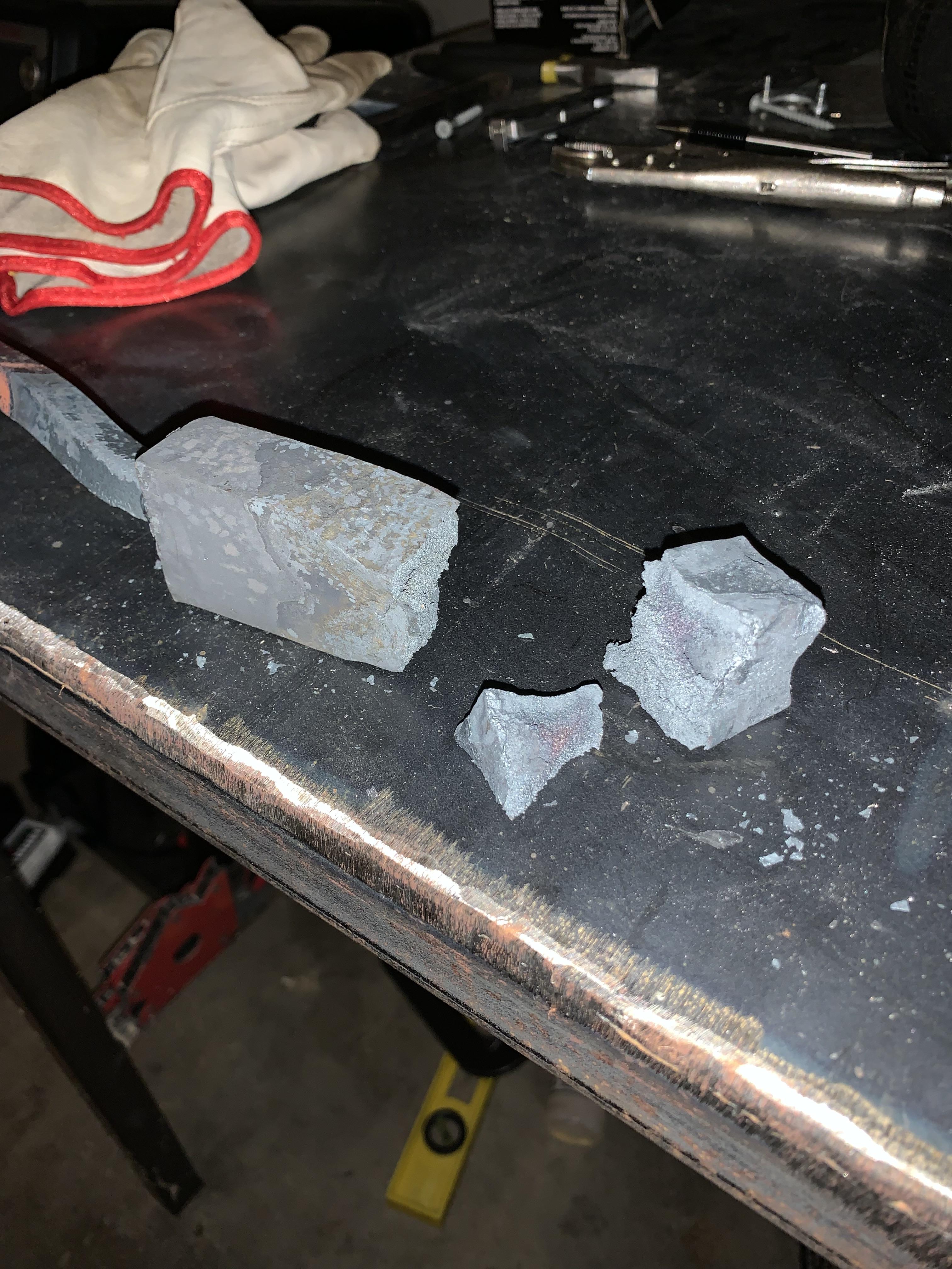

H13 cracked while working
Im a very new smith, just started forging pieces a few weeks ago, having a blast etc. I was in the process of working a large piece of H13 slowly but surely into a hot cut hardy tool. I had done some research on it and saw it was an air hardening steel that was shock resistant and made for hot work. I thought it was a great alloy for my purposes if not a pain in the butt to work, but hey one swing of the hammer at a time.
I was drawing it down into the tenon for the hardy hole and all of a sudden it just split in 2 pieces when I struck it... never worked with this alloy before so im curious as what happened and what I can do better since I have a bunch of this stuff. I can go into detail on how I got it if desired but I maybe this is enough to solve it. Third piece broke off after i dropped the smaller one on the concrete floor from anvil height. I know youre supposed to keep this stuff hot so beyond I didnt keep it hot enough Im not sure
It "looks" over heated. I'm not very knowledgable on the alloy but looks like it to me.
Hmmm, possibly. I dont think I ever got it above a yellow heat. The forge was too bright to look into but the steel wasnt ever that bright. I am still learning to tell colors and its night time so perception is different
H13 has a very narrow  working rang of yellow and orange heats. Do not work it red, as buy then it’s already getting hard.
Do you think I can still utilize and salvage the rest of the billet? And I may have been guilty of forging it when it was in the red zone in a similar area to where the crack occured

I suggest you learn how to forge normal steels before playing with air hardening steel, but since I doubt you will listen to reason, you must remember that with Air hardening steels you can either work entirely above hardening temp NEVER letting it get below conversion temperatures until finished, or do the work below hardening temp and barely move it, but you can work them a little at a time stopping to rest as needed

I can only imagine, any other tips for working with the stuff since its the vast majority of what I have access to?
I'd certainly start making hardy tools from 4140 before jumping to H-13 (or even A-2 or D-2).  As others have stated, it is a bear to work with, particularly without a power hammer or press.  Even 4140 in hardy tool size will benefit from having a friend onboard to strike.  I have overheated H-13 in a coal forge and had it crumble under the hammer.  Hard to tell for sure from the photo, but your grain looks massive.  Did you soak the steel for a long time at high yellow?

Never thought about that, but yes I did soak it for quite some time at a yellow heat or higher. Im still learning my forge and how much gas is actually needed to get the heat I want. I wish I had a press or a hammer but currently its attached to my shoulder and thats the best I have the money for. Sadly I cant get it that cheap, i end up paying about 3.40$ per Lbs for it and any other tool steel alloy I buy from them. If you have any other recommendations for places to source specific alloys then id be appreciative.

Welcome aboard Huntmaster, glad to have you. I'm afraid you've made a typical beginner mistake, thinking you need tool steel and worse picked up a very difficult alloy. High yellow is WAY TOO HOT! Below ORANGE is WAY TOO COLD!
You can make a hardy from darned near any decent steel, my commercially made Atha, hardy sparks orange on the grinder and a center punch marks it easily. I strongly doubt its even medium carbon steel. An axle makes fine hardies and it's hard enough to work to give you a taste of heavy forging and it's not nearly so temperature sensitive. Spring steel is also a good option for most smithing tools, leaf and coil both have advantages over the other. If you don't have an automotive wrecking yard or better a scrap yard that will sell to the public, check with automotive, truck or heavy equipment repair shops, offer to pay scrap prices to sort through the scrap bin. Most will just point you at the dumpster or pile and tell you to be careful. Bring basic PPE, leather boots, glove, safety glasses and perhaps a box of doughnuts.
