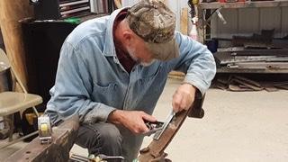

Most garages will give you ones laying outside their scrap bin (and a dozen of donuts early in the morning may get it carried to your vehicle) I cut an old one off of a rebuilt dodge pick-up project back in 2019 Joey asked about blacksmithing a knife out of it, I assisted (let Joey do most of the work) turned out pretty well!
