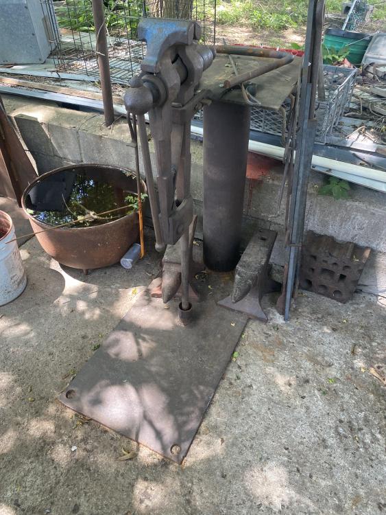

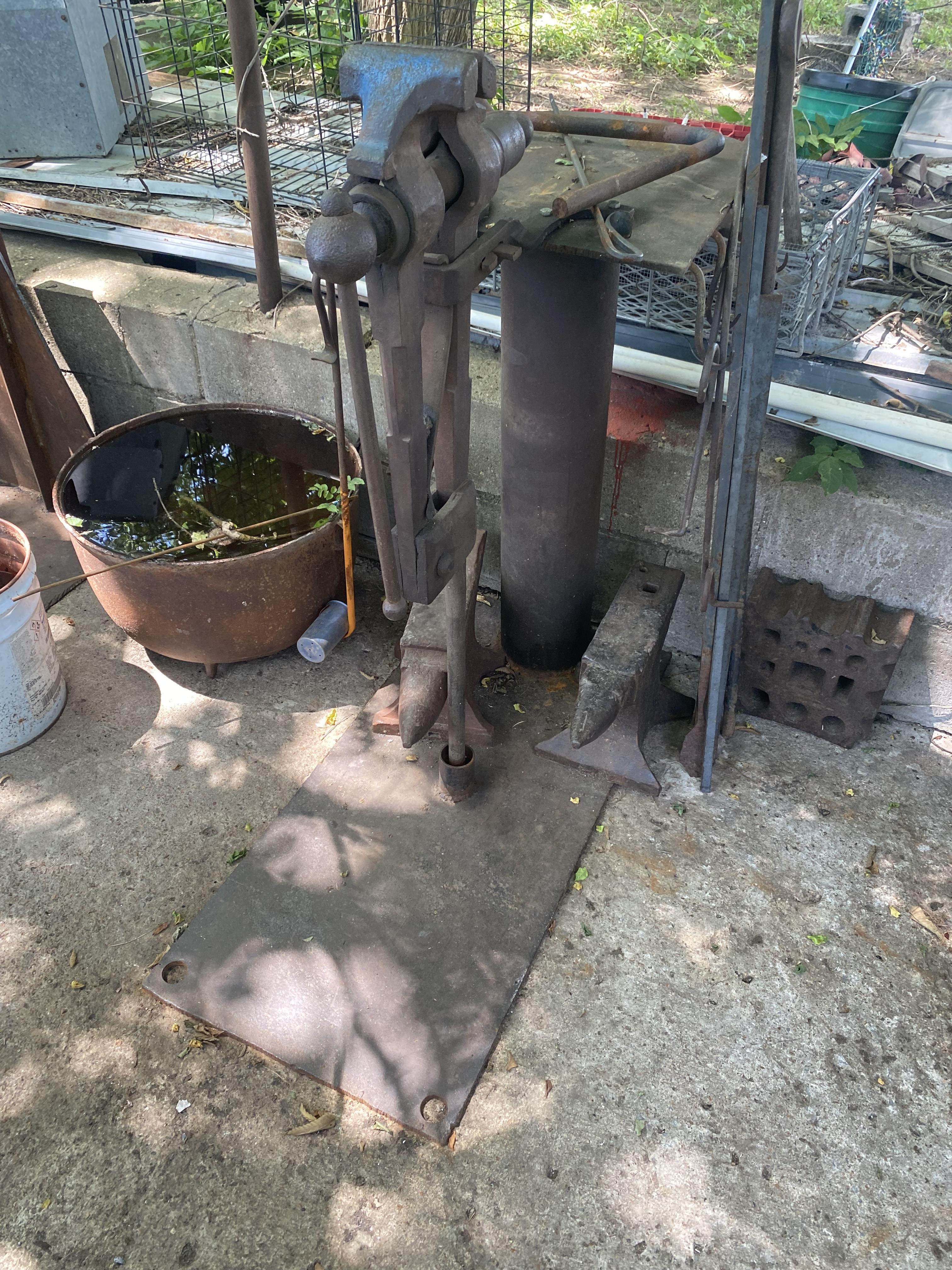

So my setup is really based around the factor of the small amount of space and having neighbors gardens joined on to mine. So I am working in an 8x6ft steel shed. I bought the forge and anvil about 2 years ago, when I had very little knowledge of how to use them or what to buy. So I bought the mini hand crank forge- the exact same one that GS tongs has been using in the past few of his videos. I believe that it is a cast iron bowl with a cheap blower, it rattles about a bit and I have had it open before to try and make it quieter. It seems to put a good bit of air flow through. The 2 downsides are you can't heat the center of a long bar without a a hearth- otherwise your coals would fall out (can't build a cave for instance). So I cut 12mm plate so the bowl can fit in and the plate becomes the hearth with some legs and edges on it. Second is, there is no ash dump, just a door- no problem, just takes longer to empty.
I also bought an anvil- unknown brand, but it really does look like the vevor ones. It's 10lb. My first or second time forging (when I though an anvil was designed to take any abuse) I cut on the face of it, with a big chisel... Please forgive me. I then built the base and cut 6mm plate for a 1" hardy, and 1/2" pritchel hole. Mild steel plate that I now use as my cut plate as well- a little to late. Thankfully the cuts on the anvil face don't seem to mark the work. I don't know if it is steel or cast iron, it has stayed flat which makes me think steel? It has I think about 70/80% rebound when I did a ball bearing test.
I also managed to pick up this vice for £27. Most vices over here go for about £75. It's an attwood that comes from England, I think somewhere about 1850-1900ish when it was made. A fair bit of fighting with it to get it to a pretty functional state. Had to forge a mounting bracket and spring. I haven't decided if I want a leg on it yet. I put a temporary wooden leg on.
Is there any advice on how to improve this setup, or anything I should be using differently? I used to have a treadle hammer I built in there, but it took up too much room.

personally I prefer a solid leg on my post vises for more stability when doing heavy work and not putting so much stress on the mounting bracket’s but I have seen others setup like yours,

See, if I put a leg on it does it touch the ground? Or does it sit a little high with a few wedges under it. Could it chip the bricks on the ground?
The hardy and pritchel work well for tooling, but if it is hot steel going further than 6mm I risk setting fire to the base. I do like being able to cut on it tho. It is very light even with that base the anvil walks around a fair bit. Sadly I have more time than money haha. I would love to get a big one, but with the weather conditions I like being able to lift the anvil back into the shed when I'm done. I've been searching about but no good ones at the minute. I mounted at a knuckle height (believing at the time that was the proper way), tho I have been finding that I am leaning over a bit.
As a joiner by trade, I find that I can hit the piece accurately from standing straight, but I can't half see it haha.

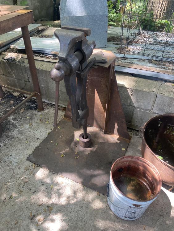

Yes you typically would mount the vises with the leg secured on the ground,
I build stand alone steel stands for mine that way I can reposition them In The smithy as a need or want,
it is possible that the leg could chip your bricks with heavy work though so you may not want a metal leg on brick,
you could make a leg just long enough to lock it down on the bottom of your work bench and then have a block of wood under that,
but agin if your not doing any really heavy hammering or twisting heavy steel and the vise is working for what you do then I wouldn’t worry too much about it,
