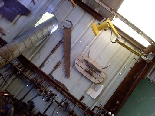

Well I'd go the opposite---I commonly stand by my forge at a distance where I would be burning by my wood stove!
However, you can debate why things do or do not work; but the 10" flue does work where the 6" doesn't.  Empirical proof trumps theoretical!

If you run the stack horizontally straight out the wall and turn it 90* up, use a T rather than an elbow one arm up the other down and put a section of stove pipe straight down on it. That way when you first light the fire the cold air that can block the flow in the stack will flow downwards and out the bottom while the first warm air can flow up and outwards unimpeded. That way you won't get smoky start ups or have to prime the stack with a wad of burning news paper to get it drawing.
What surprised me about that stack was it didn't suck warm air out of the room if there wasn't a fire going like a chimney will.

The plain super sucker with a vertical chimney is a pretty much "gold standard'.   As my used wall material had a previously chimney hole in it I just took a piece of 10" spiral seamed duct and ran it up at an angle.  Of course rain issues are not much of a problem out here in the high and dry.
