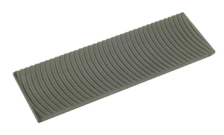

metal99 Posted March 11, 2012 Share Posted March 11, 2012 I know this is an old thread but just in case somebody stumbles across it I wanted to share this, You should try out a body file for doing body work that would leave a really neat design when finished like that. Here's a link to what I'm talking about.http://www.race-werks.com/product_images/g/517/SVST-PBF4-Panzer-File__69183_zoom.jpg Quote Link to comment Share on other sites More sharing options...
