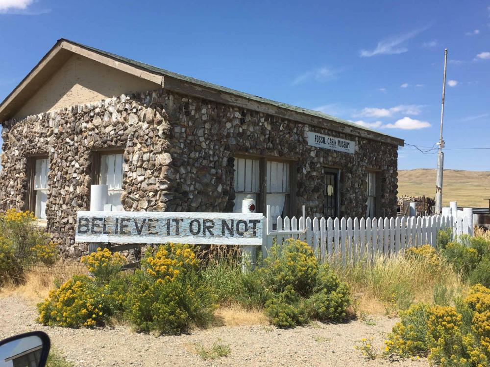

Uranium will bind up with carbon resulting in, as Thomas mentioned, coal often being more radioactive than surrounding rocks.  There are dinosaur bones here in Wyoming that are "hot" because of uranium concentrating in the bones.  There is a small building near Como Bluff, a famous dinosaur quarry site, north of Laramie that is built out of dinosaur bones and is "hot" enough and has enough radon concentration that it is unfit for humans.  It used to be a gift shop.

I went by the Fossil House on one of my motorcycle trips.
