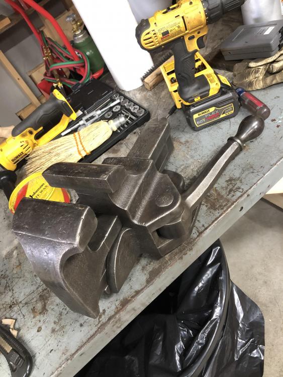

Here’s a neat one!  Just finished cleaning up and reassembling it.  I took too long getting around to it and had to look up the patent to figure out what went where.

Messer Slag: The horizontal lever is connected to a cam. Pushed back like it is takes pressure off the slide for the moving jaw. Pull it forward and it engages the slide then as it "rolls" along the slide tightens the jaw with significant force. Probably not as much squeeze as a screw vise but these are very fast, push its loose, pull it's tight.
I'm betting they're fast enough to forge weld with, like a press.

That isn't quite how I thought the vise worked but a rack gear makes a lot of sense. Does pulling the handle tighten the jaws or just lock them?
Agreed Thomas, the patent files have a lot of silly muck but so does Iforge not to mention youtube.
Pulling the handle tightens the jaws up to about a quarter inch on mine, it’s not a locking mechanism at all.
So basically just slide the jaws shut and then pull the lever, and it tightens up as much as it can.

The handy thing about the Stephens design is: I can pull the lever partially and slide the jaw closed on whatever I am clamping and it will hold it, then I can pull the lever to apply more clamping pressure. Handy if I am positioning something with both hands, using my body to slide the jaw closed. Sort of like a ratcheting mechanism.

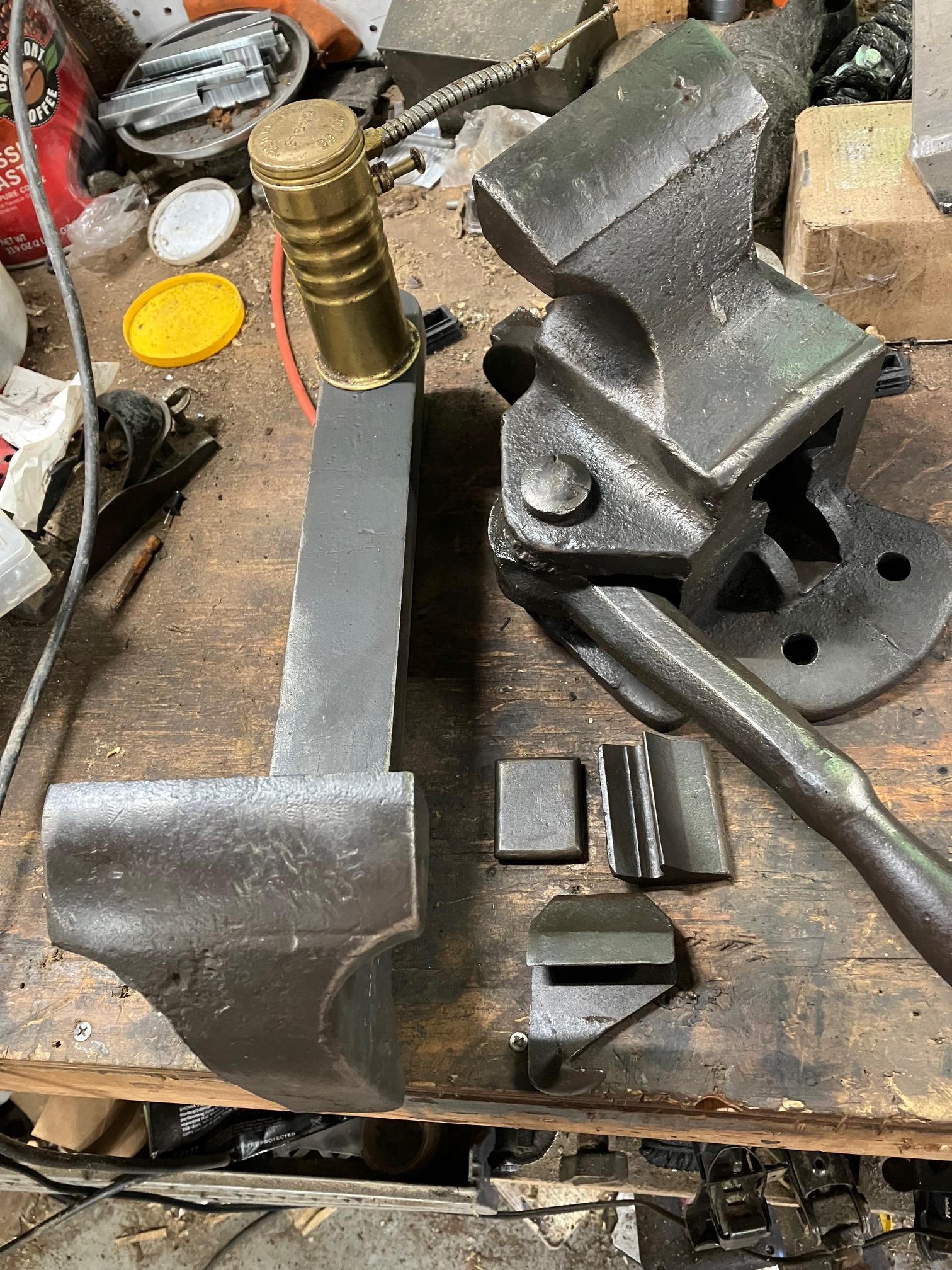

Hello Flynn.  I hope you are still willing to chat about your Stevens Lever Vise (or is it "Stephens" as the patent indicates?).  I just acquired one the other day.  In the process of restoring it (I was just going to do a surface cleaning) the guts fell out of the vise.  I tried every conceivable way to reassemble the parts but failed.  Last night I found the patent for this vise that you spoke of and it gave me a diagram of how those parts are supposed to fit in there.  As soon as I get a minute, I will work on the reassembly process.  Naturally, since I now have the entire vise disassembled, I will shine and oil every millimeter, inside and out.  I will keep you posted.  Also... There is so little information out there about this vise, I want to launch you a big THANK YOU for helping me figure out what I was in possession of.  I am still not sure if this vise will be the one in my shop or one for the shelf.  I really want to use it as it was made for.

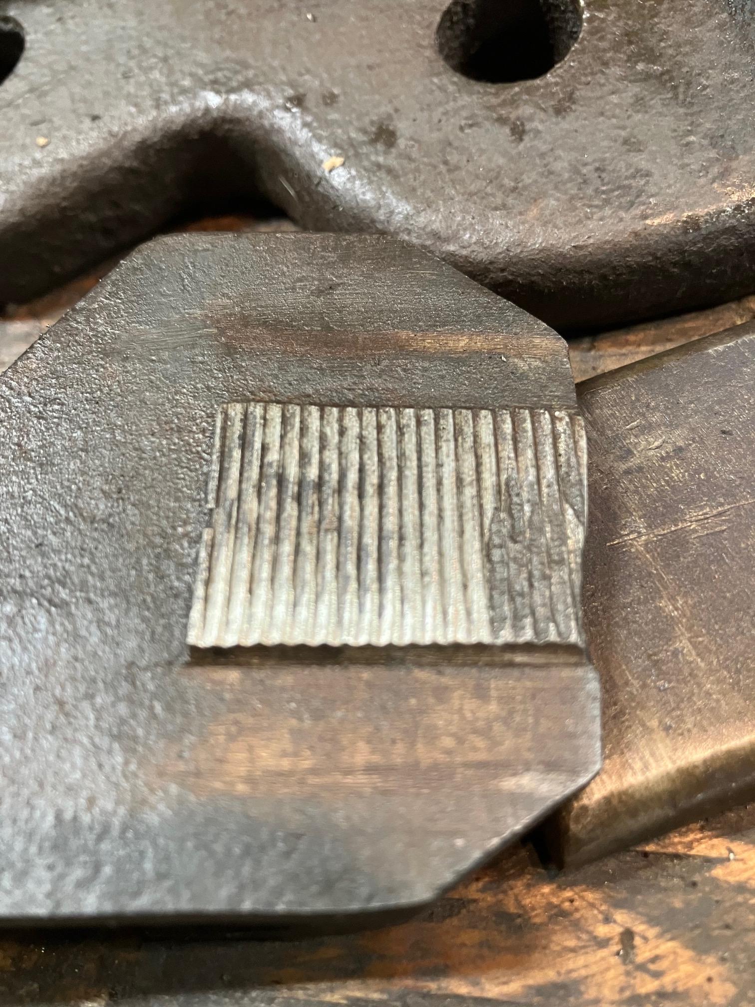

Hello Flynn.  With the help of the patent, I was able to reassemble the lever vise.  It went together and seemed to function normally until I tried to tighten it on something but it wouldn't tighten.  When I started looking closely at each piece to see if there was anything wrong, I found the teeth on the internal mechanism were goobered up.  If you look at the last picture I included, those teeth are on the back side of the bottom part.  I am not sure I have the technology to fix this problem, nor will I be able to go on Amazon to get a replacement part!!!  The teeth on the sliding part of the vise are perfect...  Any thoughts?
That's going to be a tough fix, I'm sorry!  I'd say your only real option would be to build up the area with weld and then carefully file the teeth back into place.  Maybe somebody smarter than me will offer a better option though!
