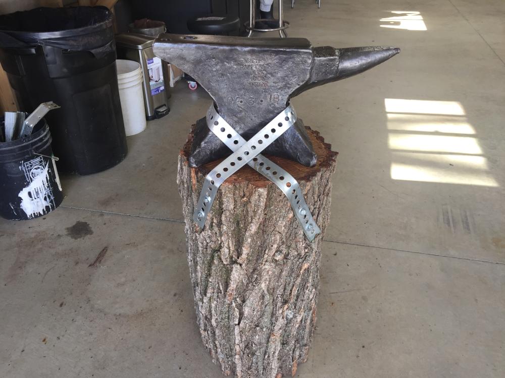

MarkN Posted October 11, 2022 Share Posted October 11, 2022 I have dug this mousehole out from under my bench and started brushing it. Can anyone tell me about when this one was made? There is no serial number on the front base just a “A and a figure that looks like an “F” with the top horizontal line missing. Thanks Mark. Quote Link to comment Share on other sites More sharing options...
MarkN Posted October 11, 2022 Share Posted October 11, 2022 Here’s the markings on the anvil. Also a before and after picture Quote Link to comment Share on other sites More sharing options...
Irondragon Forge ClayWorks Posted October 11, 2022 Share Posted October 11, 2022 Welcome from the Ozark mountains. Sorry about the only thing I can tell ya about your Mouse Hole is it weighed 102 pounds +/- at time of manufacture. Quote Link to comment Share on other sites More sharing options...
ThomasPowers Posted October 12, 2022 Share Posted October 12, 2022 And so not a large anvil; but a very handy sized one for a travel anvil. With an original pritchel hole it would date after the 1830's and so not exceptionally old either. Quote Link to comment Share on other sites More sharing options...
MarkN Posted October 12, 2022 Share Posted October 12, 2022 Thanks for the replies guys. I'm in West Central Minnesota and don't have a forge so this one will be used for light jobs in the garage. Quote Link to comment Share on other sites More sharing options...
Frosty Posted October 15, 2022 Share Posted October 15, 2022 Don't let ANYONE near it with a torch! Of any kind for ANY reason! Seems shop folk thing anvils were made to use as a place to put things to heat or cut with a torch. Few things will ruin an anvil like a torch. Frosty The Lucky. Quote Link to comment Share on other sites More sharing options...
