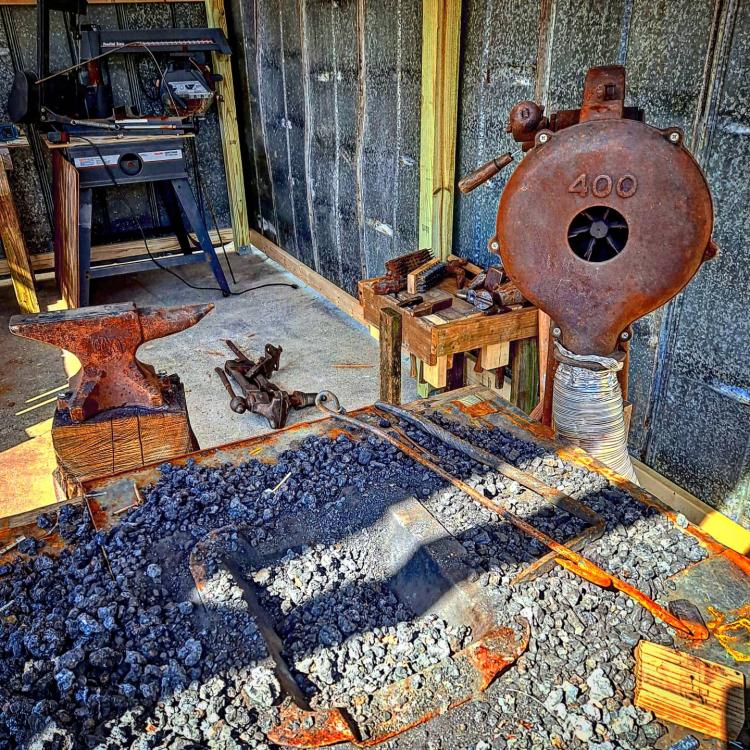

Ridgeway Forge Studio Posted March 7, 2021 Author Share Posted March 7, 2021 Made some progress on the shop yesterday!! Now all it needs is a roof and the walls. Link to comment Share on other sites More sharing options...

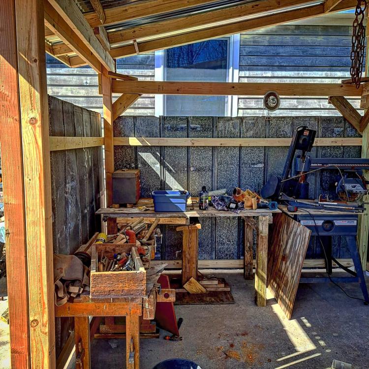

Ridgeway Forge Studio Posted March 19, 2021 Author Share Posted March 19, 2021 Finally finished up the shop, thought I'd post it up here for viewing pleasure! Thanks to all who gave me advice, it was all very helpful! Link to comment Share on other sites More sharing options...
