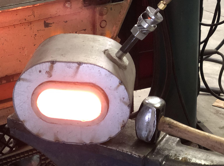

I have not payed attention but no ozone that I have detected.  I don't have an accurate temperature reading but they are hot enough for me.
This is a 3/8" burner with an 0.031" orifice running below one psi in a mini forge.
Both the forge and the burner are older designs.  I am currently working on updating the 1/4" burner for a forge this size.  I still haven't built a micro(nano?) forge for the 1/8" burner yet.
Wow Frank!
That almost looks like a spacecraft engine! (Millenium Falcon / Nostromo!)
That is so cool. Me likey a lot!
I'd still be interested in one of your 1/4" vortex injectors to use as a hand-held burner.
Please let me know when they are available.
Keep up the fantastic work, matey.
