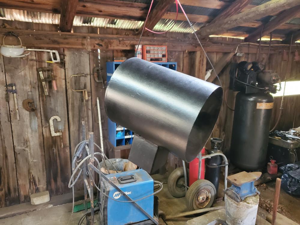

Still need to finish getting all the paint off before I can weld my legs and some door hinges. My refractory comes in Tuesday so I'll cut the door holes once she is lined and then set my ledges up. Havent fully committed to a burner yet but would like to come in at a tangent whichever way I go.

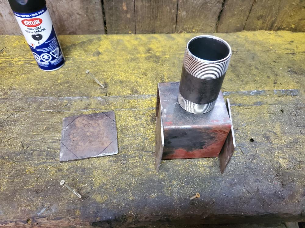

What's the square box and pipe nipple you're welding up?

Originally I had a 2 inch pipe leading into a 4x4x4 box i was going to attempt making a ribbon burner or possibly an NARB with it but making the switch to frosty t and going to experiment with that other one  in the future

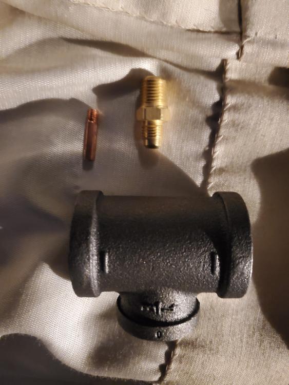

Lonely, check what threads your mig contact tips have many are not 1/4- 28 close but not quite. Mikey knows but I don't recall. It'll be on the lable of the tips you get.
The most common thread found on American MIG contact tips is 1/4-27, which can be CAREFULLY fit into standard  /4-28 threads on a steel fitting. Also, manufacturers are slowly switching over to /4-28 threads on MIG tips.

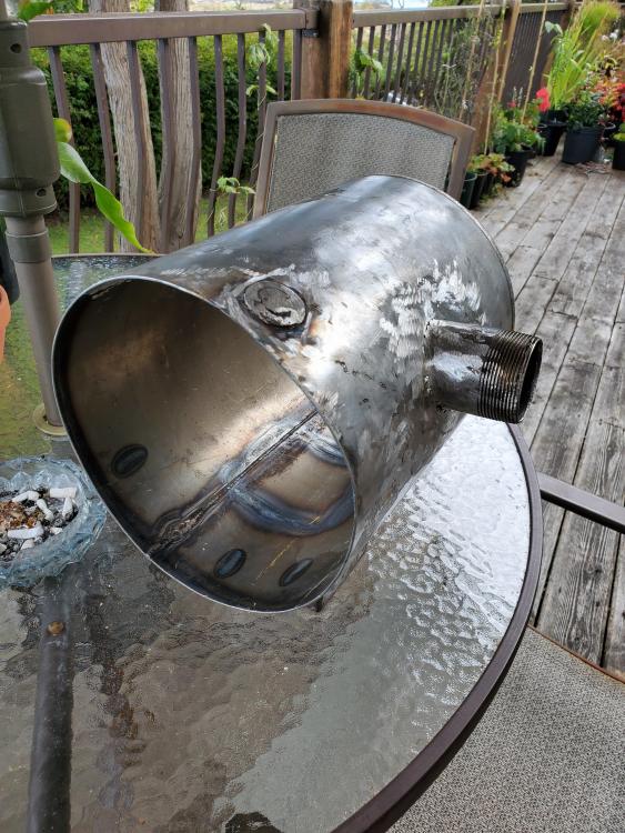

Thanks for the tips guys. Got most of my shell welded together today... haven't touched a welder in 15 years but I can live with the final product
Made it into town. This the the fitting I found in town it looks like I should be able to tap my .035 in with a 1/8 m28. Need to grab a regulator and the bottle still. Then get some insulation in my shell then hopefully start cooking soon
