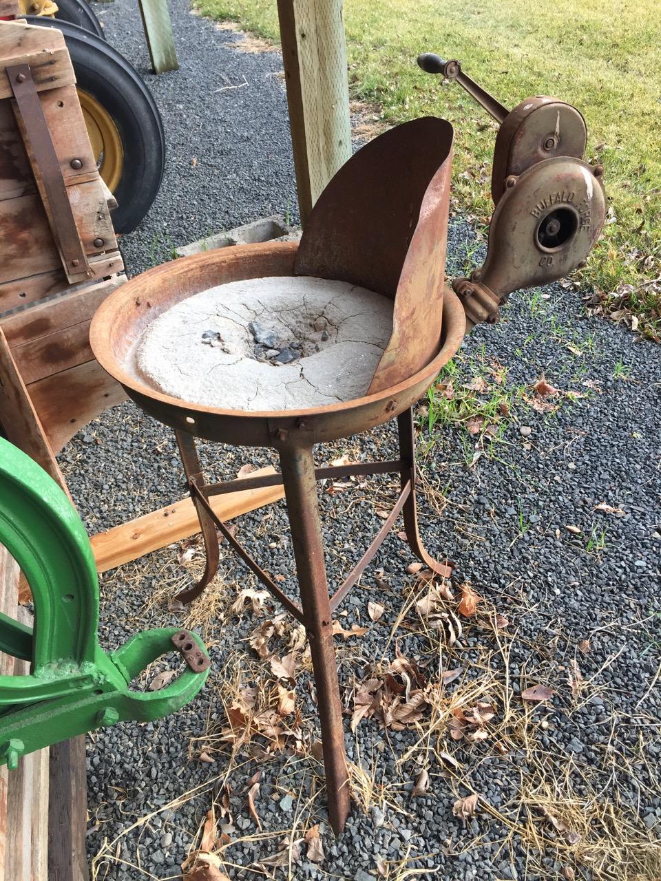

Cowboy Rich Posted March 3, 2020 Share Posted March 3, 2020 A few weeks ago I got a buffalo forge with hand crank blower, from member Kozzy, and it will fit my needs perfectly except I cant seem to get the shaft the crank goes on freed up, everything else moves.(Yes i took it apart). So I started with saturating shaft with PB blaster, for days not helping, then I went to another penetrating oil called knocker loose these have been 3-4 days at a time. So Saturday I put it in ATF, still no movement, so it's currently as of this afternoon sitting in diesel. Which is where the thread I was reading stopped, now the long winded question..... what next if after a few days? Week? This doesn't do it? I am not wanting to put a torch to it, it's to nice for that. TIA Rich Quote Link to comment Share on other sites More sharing options...

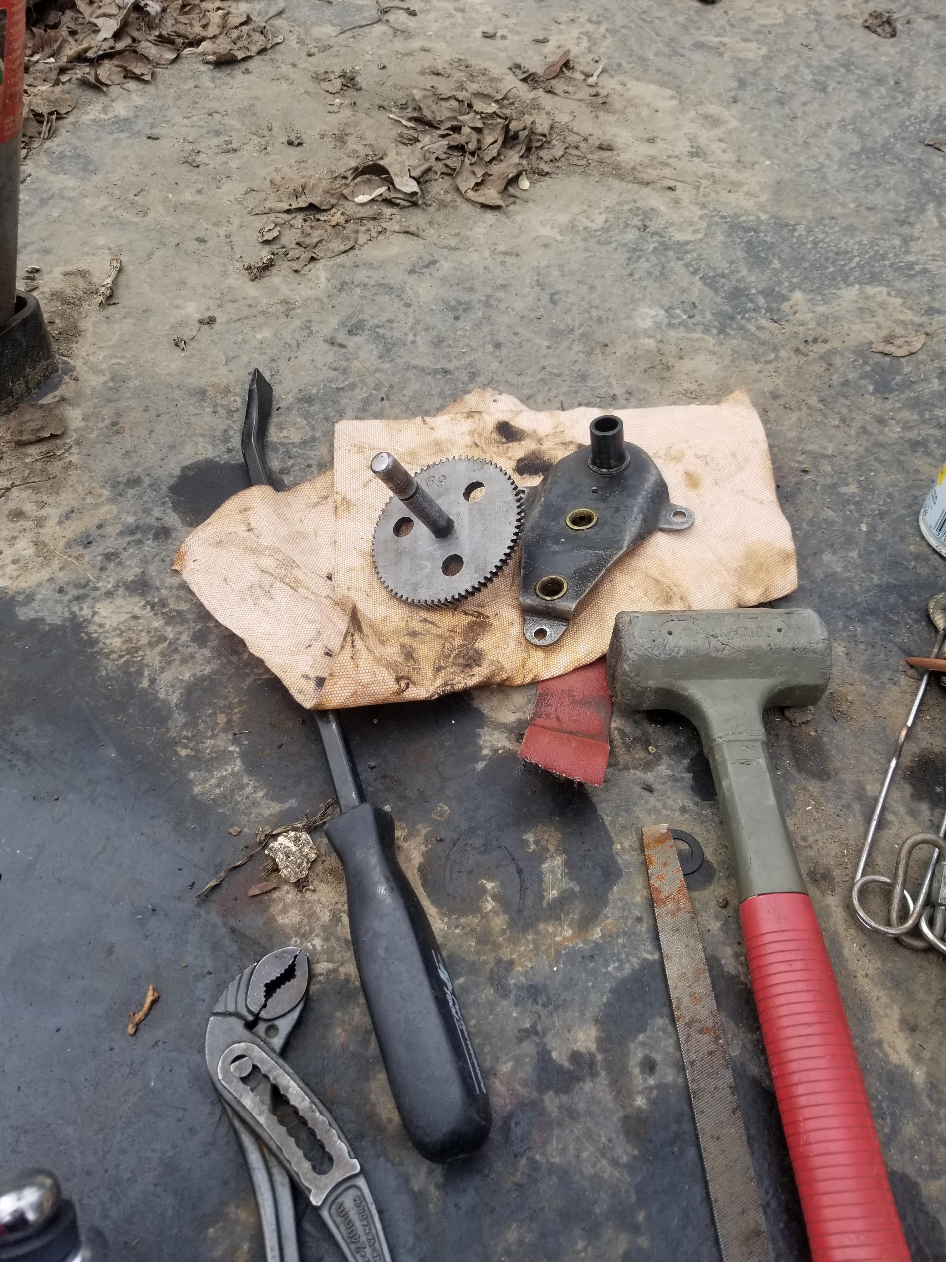

Irondragon Forge ClayWorks Posted March 3, 2020 Share Posted March 3, 2020 19 hours ago, Cowboy Rich said: (Yes i took it apart). How far apart did this entail? Pictures will help with advice too. Quote Link to comment Share on other sites More sharing options...
Kozzy Posted March 3, 2020 Share Posted March 3, 2020 It was frozen but not in terrible shape---I figured it would come apart reasonably easily with the usual soaking etc. It's a stamped sheet metal buffalo that was sold to Cowboy Rich. Quote Link to comment Share on other sites More sharing options...

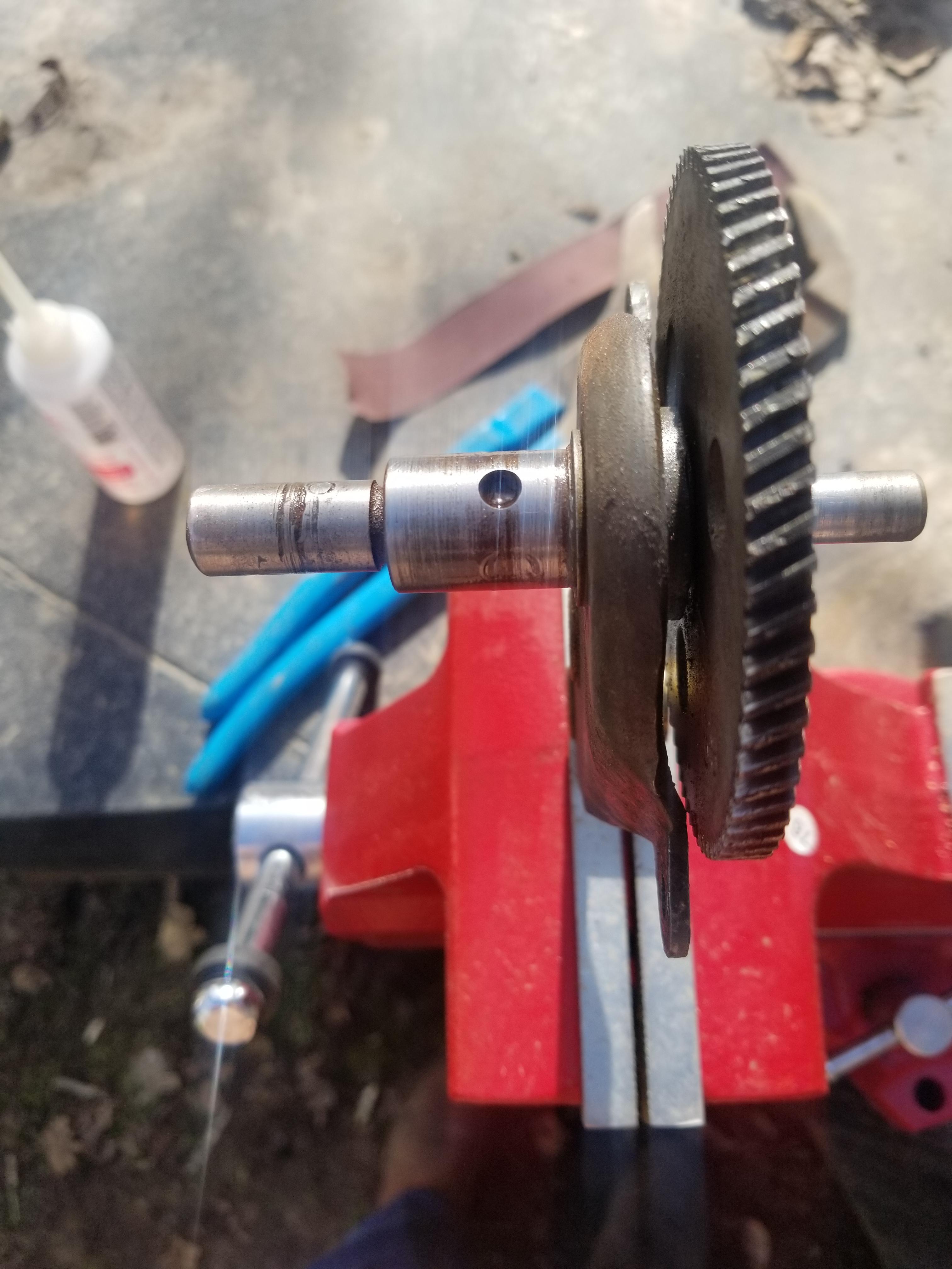

Cowboy Rich Posted March 4, 2020 Author Share Posted March 4, 2020 Thanks for the help folks. This is how far apart it is the main gears shaft is the only thing seized up everything else spins freely. It was sitting in diesel but found out when I got home my coffee can apparently has a small hole in it so no progress today. I have tried bumping it back and forth but it's not having it just yet. So tomorrow I will get a different container and some more diesel along with PB blaster then see what happens I just wanted to make sure I hadn't missed anything. Not applying heat is me being stubborn, I will if need be. Kozzy, dont take this post the wrong way I am very happy with the forge and just trying to take baby steps to free it up, I am a horrible combination sometimes stubborn as all get out and then while I'm busy with stubborn I get impatient. I've been steering clear of the impatient because I dont want to hurt anything. Oh forgot the inside was free of anything but wasps nest. Thanks again everyone Rich Quote Link to comment Share on other sites More sharing options...

Irondragon Forge ClayWorks Posted March 5, 2020 Share Posted March 5, 2020 I would try tapping the shaft back & forth with a wood mallet (not too hard) and rocking the gear back & forth, it should let loose. Quote Link to comment Share on other sites More sharing options...

Cowboy Rich Posted March 6, 2020 Author Share Posted March 6, 2020 Its apart!! Yeah! Thanks kozzy but working on getting it back together now, IM HAPPY! it wasn't a big deal just took longer than I thought it would. Quote Link to comment Share on other sites More sharing options...
Irondragon Forge ClayWorks Posted March 7, 2020 Share Posted March 7, 2020 Looks like the 50/50 mix penetrating oil worked. Quote Link to comment Share on other sites More sharing options...
