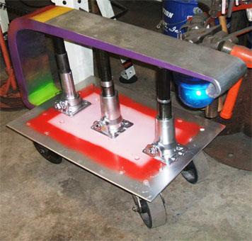

Here is one we use, this was a prototype, better if two legs were facing to rear, and one under the horn

They have proved useful, the inside support legs also have holes drilled in which give a height adjustment in 1/2" increments.
Seems like that would be hard to adjust though. How heavy is that anvil?
