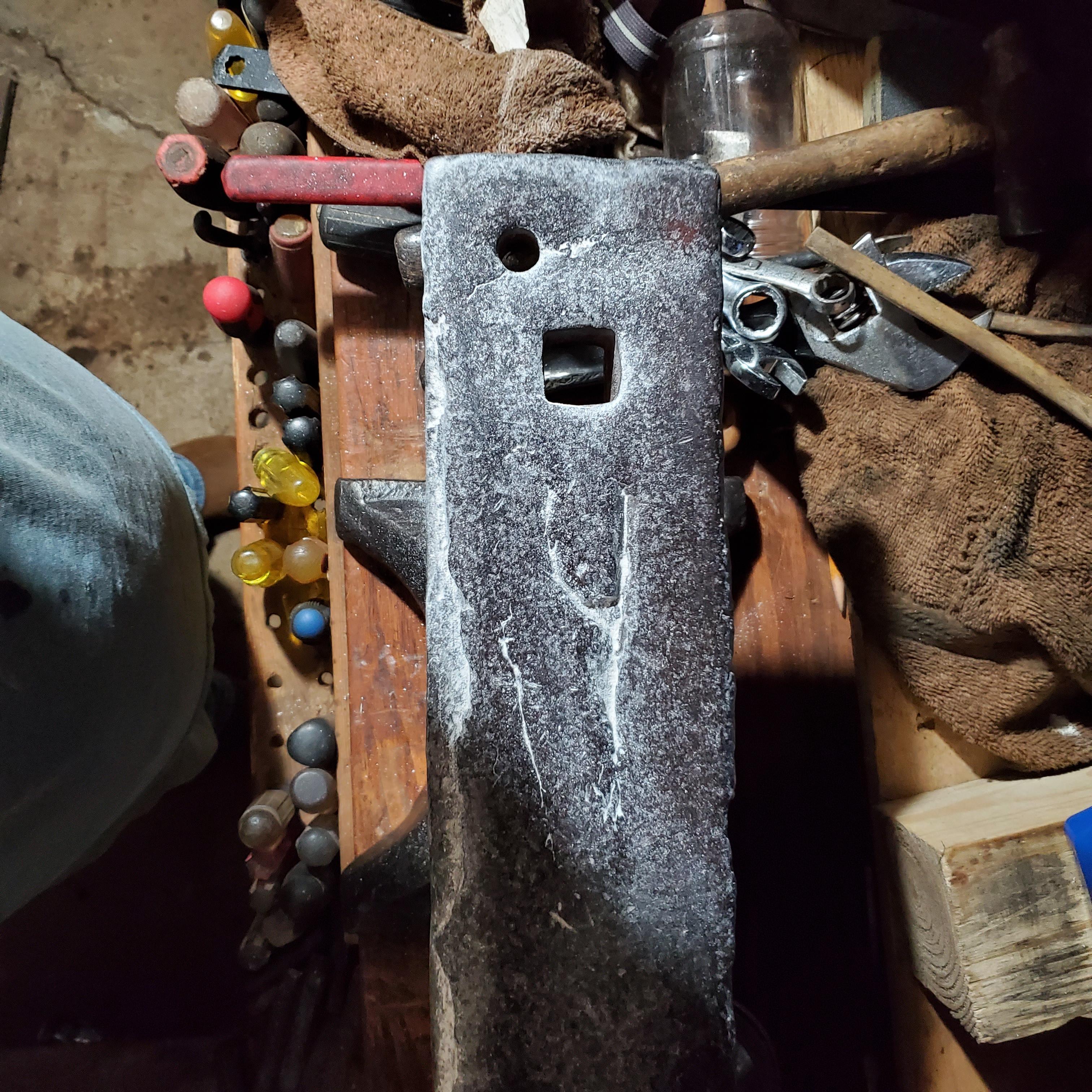

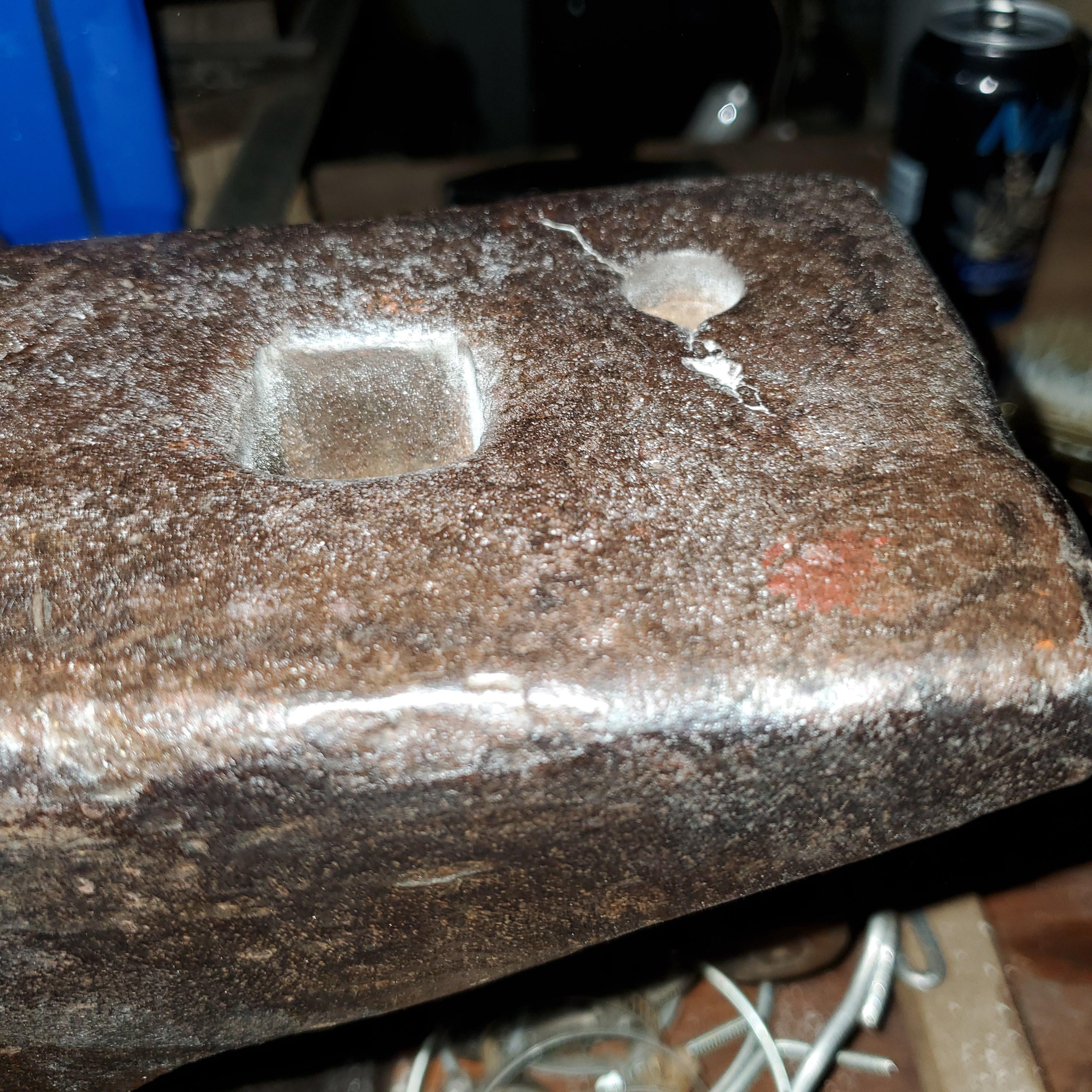

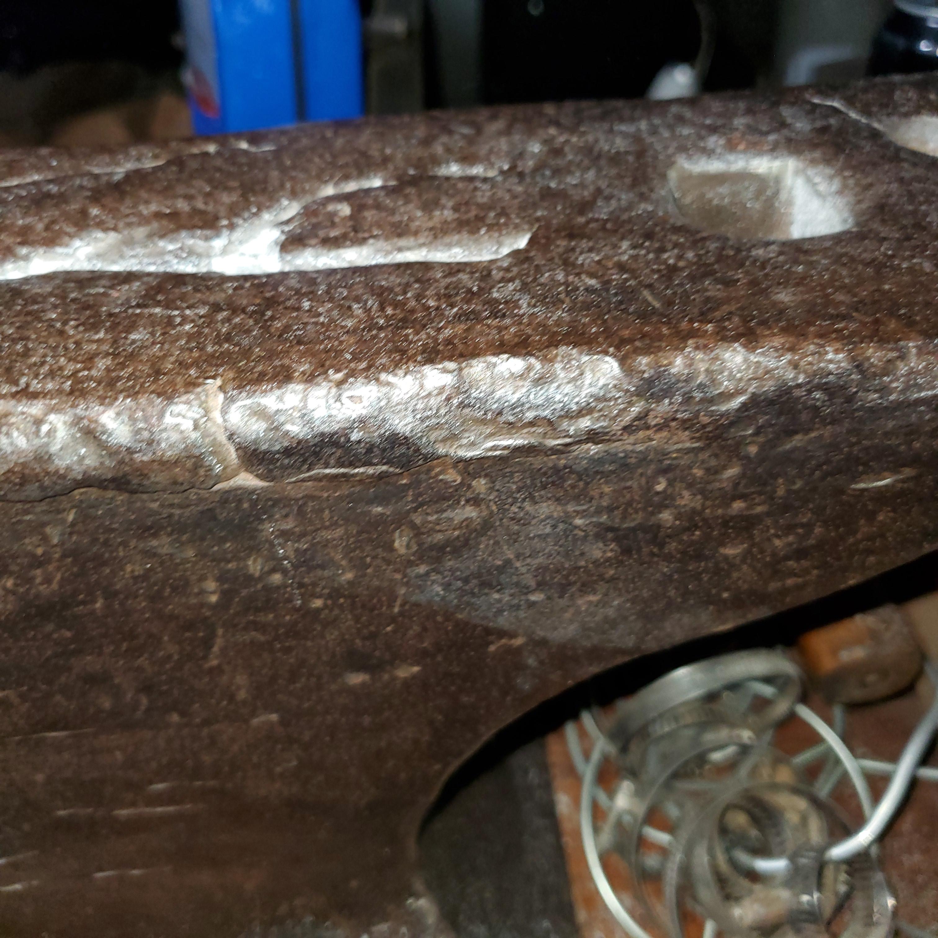

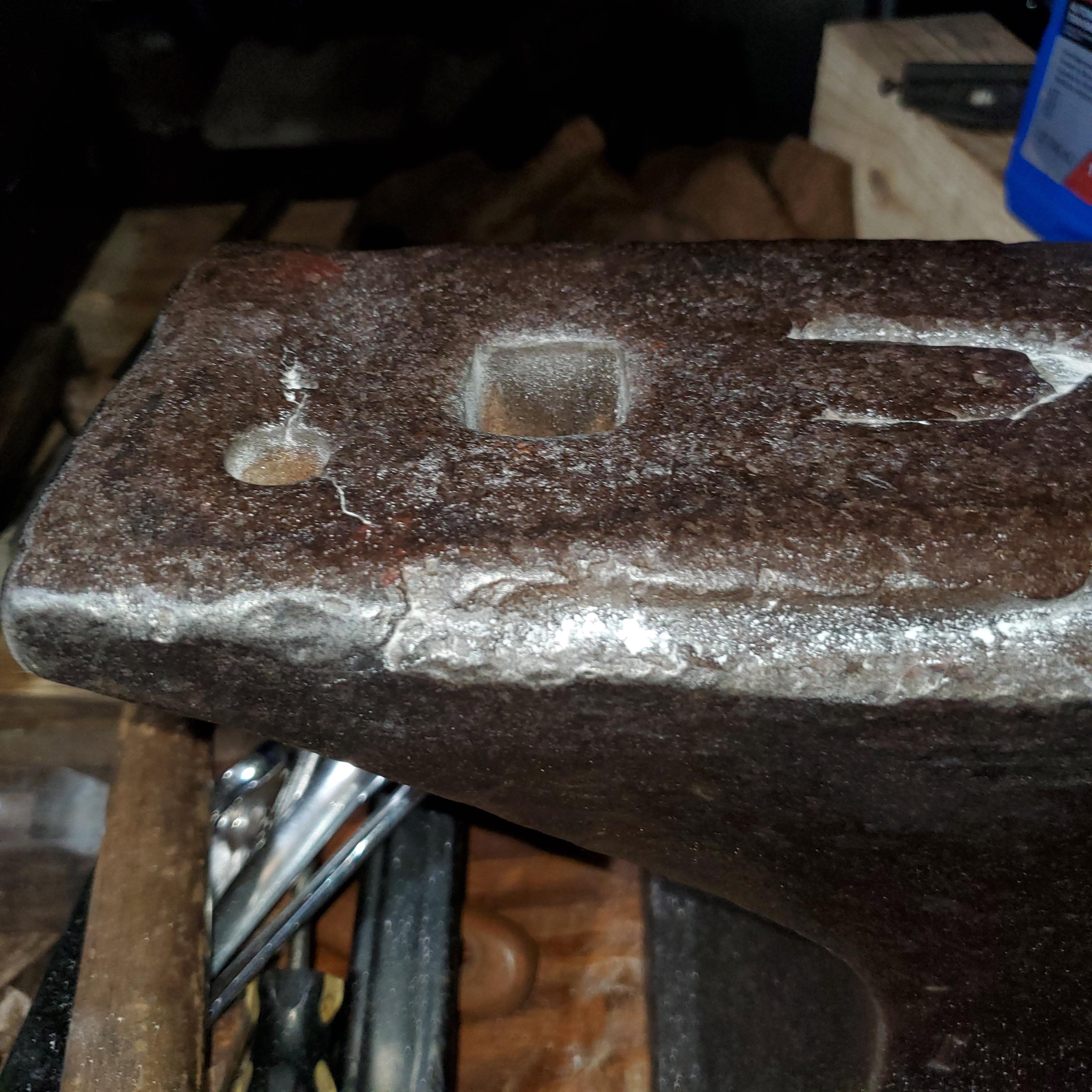

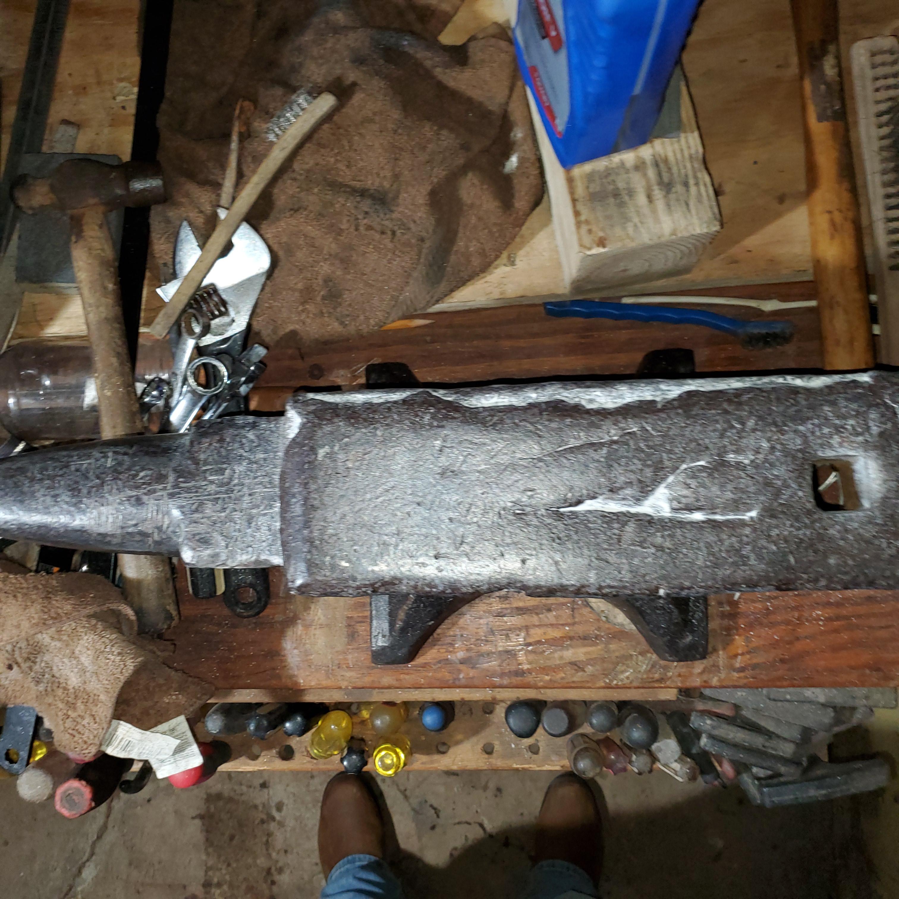

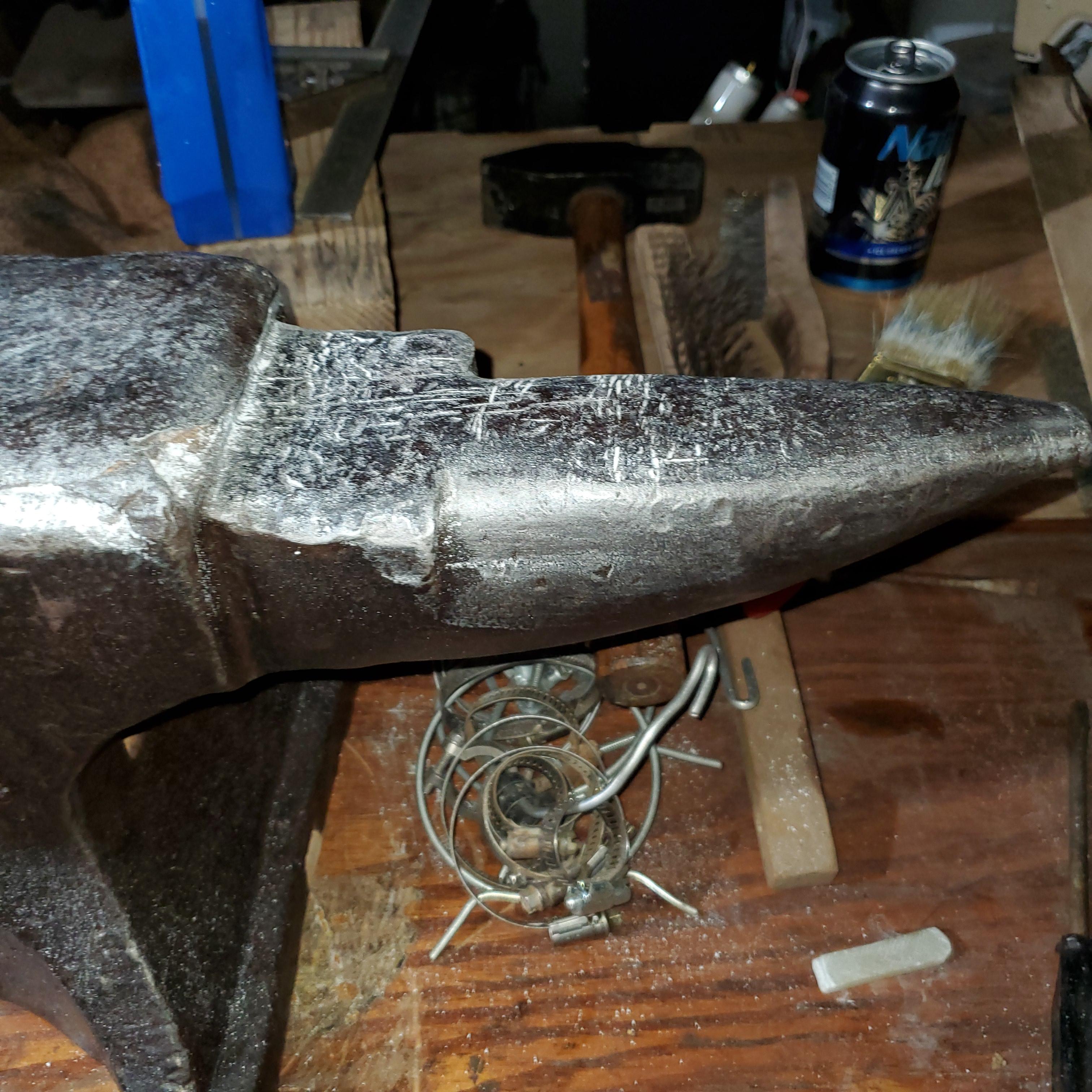

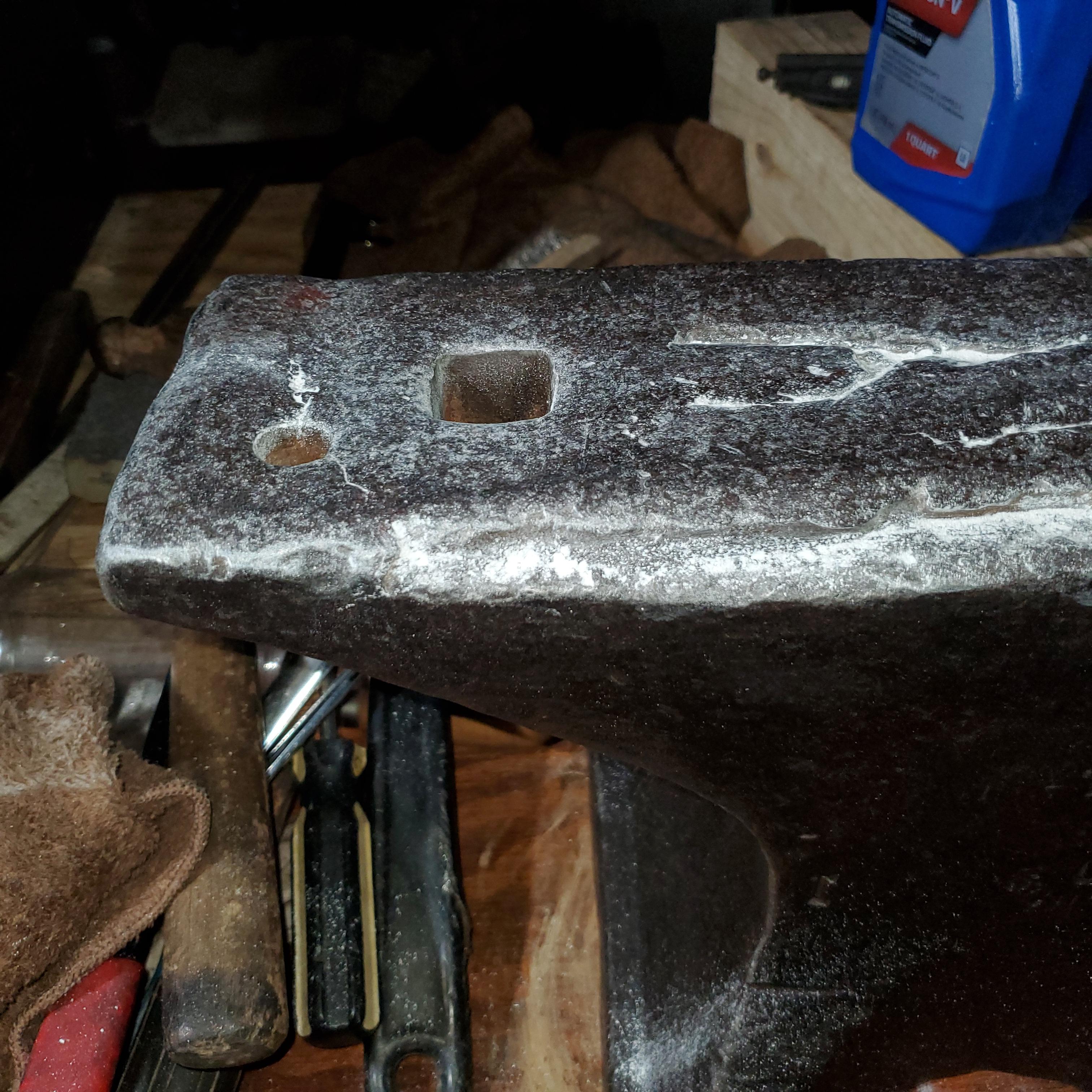

SgtCoffee Posted January 17, 2020 Share Posted January 17, 2020 (edited) What can I do to restore this ole boy to his glory???? Some one has all ready welded on him I"m sure ! so what can I do do bring him Back?????? Edited January 17, 2020 by Mod30 Delete duplicates and resize photos. Quote Link to comment Share on other sites More sharing options...

CrazyGoatLady Posted January 17, 2020 Share Posted January 17, 2020 Wow, that anvil has been rode hard and put up wet. Makes you wonder what someone was doing to damage it so thoroughly. What a shame Quote Link to comment Share on other sites More sharing options...
Glenn Posted January 17, 2020 Share Posted January 17, 2020 You need to ask yourself if that anvil is worth the cost of a new anvil in order to repair it. If you still want to repair the anvil there are several posts on the site that explain what are considered "good" methods for the repair. Start here: Robb Gunther and Karl Schuler's Anvil Repair Process Quote Link to comment Share on other sites More sharing options...
Marc1 Posted January 17, 2020 Share Posted January 17, 2020 I am afraid that not even Gunther can save that anvil. I doubt there is much original faceplate still welded to the body. Of course it does not harm asking someone experienced in restoring anvils having a closer look. New faceplate can be build up with successive passes, hours of welding an 20 kilos of rods What it seems that anvil needs, (from the safety of my keyboard) is a completely new faceplate. A new plate is welded to the body by leaving a gap wide enough for a welding rod to fit between plate and body. THe plate is welded starting from a point in the center and going round and round until the gap is completely welded up and full welding is achieved on all the face. Needless to say that it will cost to get a new plate machined, if you can not do it yourself, and a few kilos of welding rods, not to mention a powerful possibly 3 phase or diesel powered 300 or 400 amp DC welder. Not rocket science but needs attention to detail and experience in stick welding, pre heating, a fume extractor and lots of patience. Of course the leftovers of the original plate need to be milled off, if it is determined it has no possibility of being repaired. Quote Link to comment Share on other sites More sharing options...

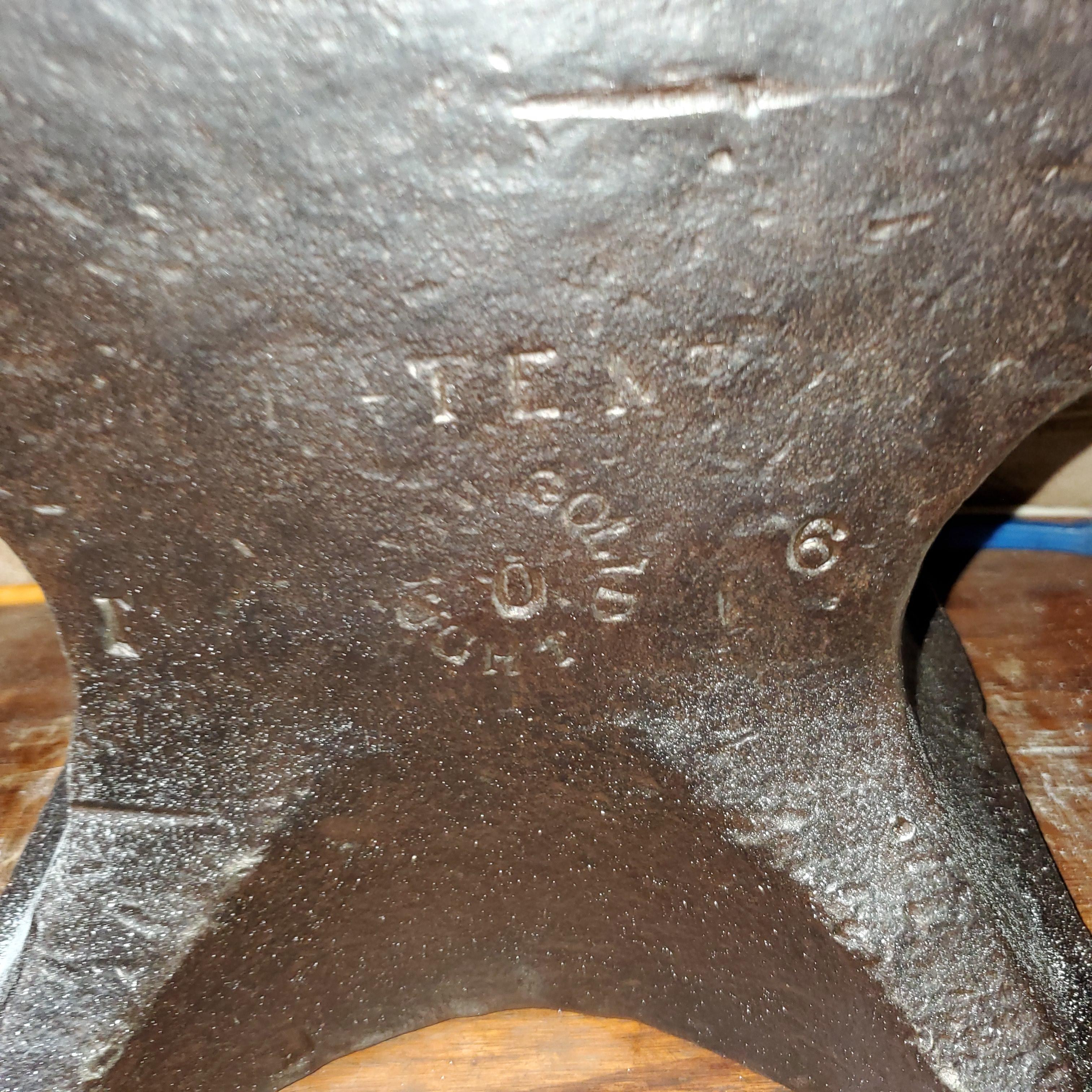

SgtCoffee Posted January 18, 2020 Author Share Posted January 18, 2020 Sorry for the size of the pics , I'm a older pipe fitter and not real good with these newer cell phones didn't know it was doing such large photos. And I could not find a way to edit after I posted. Thank you to the mod that fixed it ! So it sounds as if I should use this ole Peter Wright as a lawn ornament, it was given to me at no cost so was hoping I could make it usable to me. Thanx for the info! Quote Link to comment Share on other sites More sharing options...
caotropheus Posted January 18, 2020 Share Posted January 18, 2020 SgtCoffe Hope this video will give you some repair ideas https://www.youtube.com/watch?v=d5vFle0kzdc Personally, I would try to repair it, but "butter layer" electrodes are expensive. Quote Link to comment Share on other sites More sharing options...
CtG Posted January 18, 2020 Share Posted January 18, 2020 The challenge with just welding on a tool steel plate is getting the heat treat and HAZ treat right. If you have proper rod available and plenty of welding experience, I think if you follow the link IF&C provided, you are unlikely to hurt her worse than she already is. If you do do any repairs, try to see how bad the delam is under the remaining plate. Quote Link to comment Share on other sites More sharing options...
RogerrogerD Posted January 19, 2020 Share Posted January 19, 2020 I’d “retire” it from regular forging, and use it, if you have the space, simply to hold hardy tools, or a guillotine tool held in the hardy, or just use it as an extra horn, or the “table” bit behind the horn which is meant to be soft for cutting etc. If you have the luxury of space next to another better faced anvil, then this grandfather still has some pragmatic uses. I have a second anvil, unsuitable for forging on, which has a smithin’ magician almost permanently mounted on it, which makes life a little simpler. Quote Link to comment Share on other sites More sharing options...
