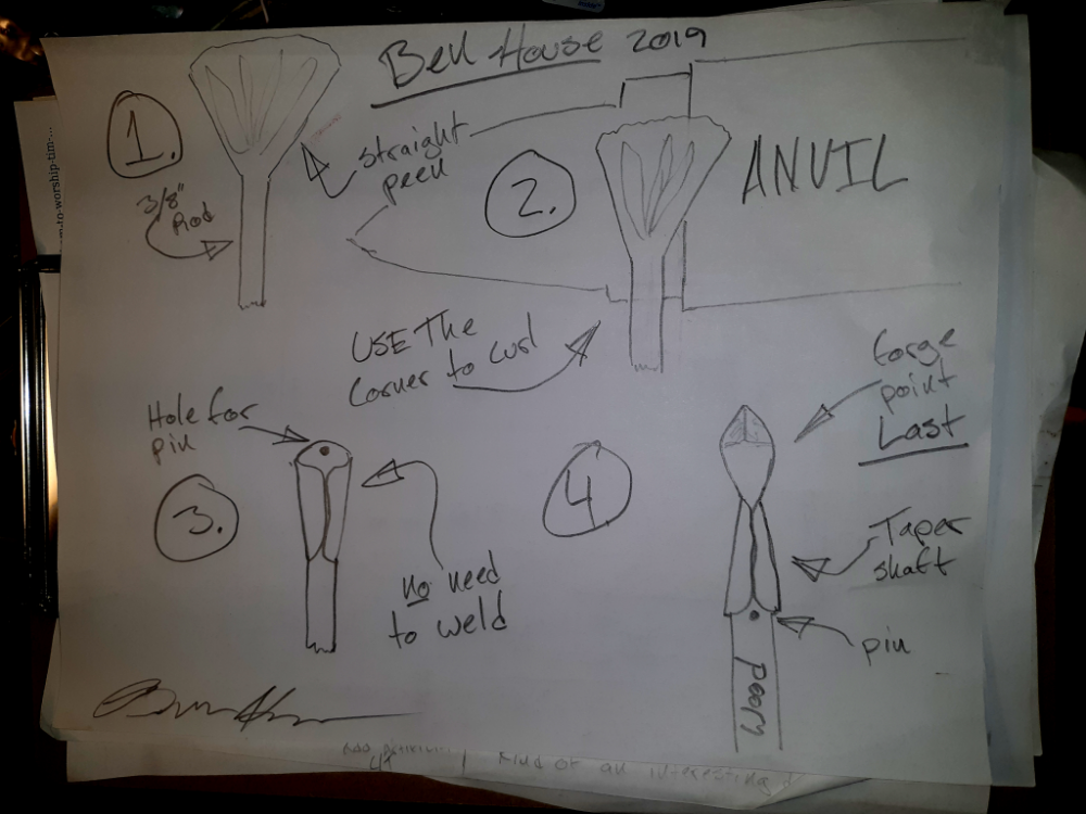

I have made several arrowheads, broad heads and field points. I forge them with a socket. Then I drill the end of a socket and put a pin in it. The process goes something like this:
I use 3/8" rod stock, I begin forging out the skirt and when it gets a bit flat and belled out I switch to a straight peen hammer. The goal is to thin and spread the metal on the outer edge more than at the neck.
Man I should just film a demo. This is hard to explain.
Once you have the skirt spread out to .... I'm gonna post a drawing.
Easier.
Oh and I use a simple tapered drift to round it out a bit as needed.
