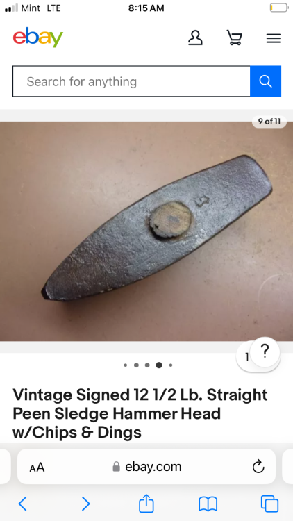

it looks so funny it’s like someone dropped a anvil on a clay hammer. ill be looking out for stray claw hammers that look like they want to try something new. “…and I don’t want tickle id rather ride motorsickle…” -
