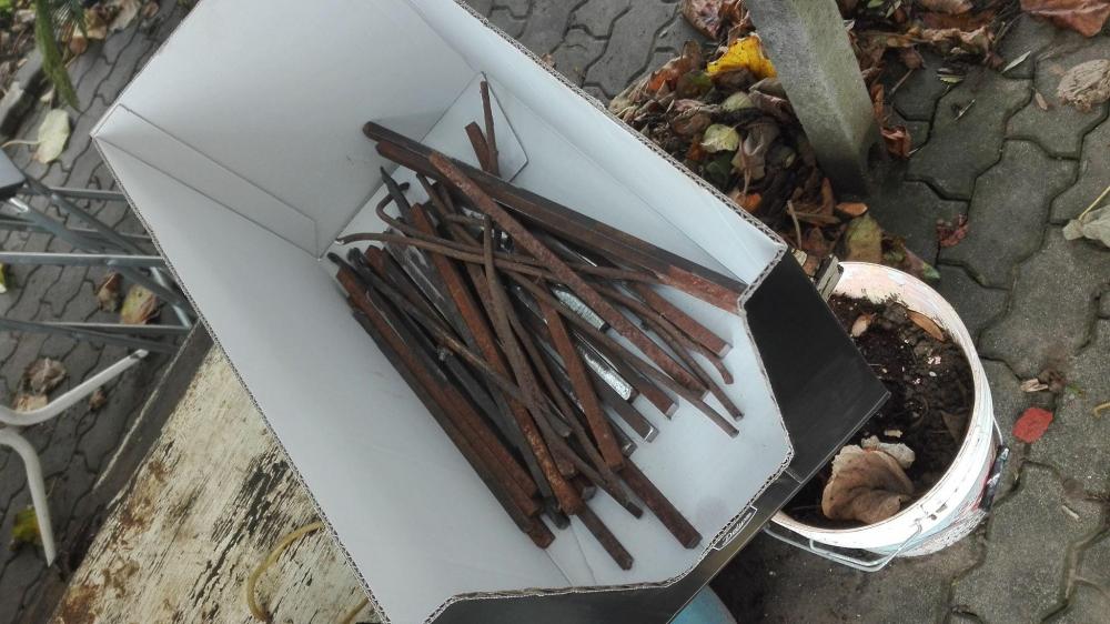

Last year I started thinking about the idea of getting a material that I can fully feel paternity. After reading through the pages of this forum and learning from other people's experiences, I decided to make a first attempt. I collected some old pieces of iron that I had in an equally old garage. The material from the spark test gave virtually no spark except for a few.

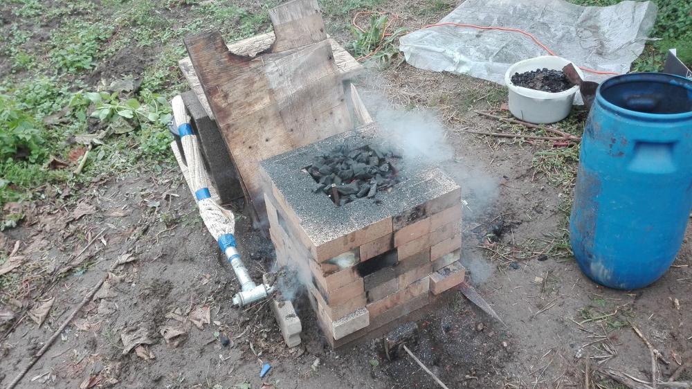

So I've made some like a bloomery and run with a lot of charcoal and the pieces of iron. And, of course a lot of air.

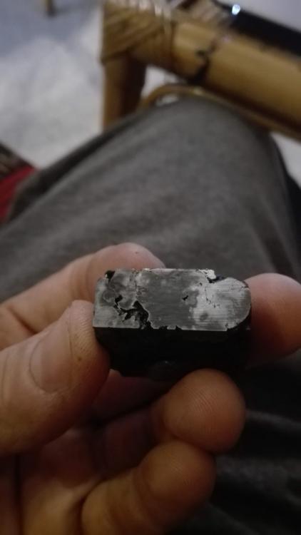

This is the bloom that I've got! Unfortunatly I was not able to remove the slag from the bottom of the furnace, so it cools down all togheter. My fault.
45276498_1888007237920296_4246351560449196032_o.thumb.jpg.bdd5119dd93d93345c93dd53dc09883c.jpg
This is one of the pieces that I've cut out from the entire bloom. And his sparking test. And another smal pieces that I've etched.
762588254_WhatsAppImage2019-08-25at13_06_14.thumb.jpeg.2db843085542ea951c220f20484af530.jpeg
293961115_WhatsAppImage2019-08-25at13_06.14(2).thumb.jpeg.a6f169bcf9c0eef5939d4e53095a7c1f.jpeg
Ant the end I was not able to compact the bloom, a friend of mine, that works in the metallurgical field suggest that probably is because of the chrome in it, (or maybe because I'm not good in compact bloom :P) .
Well this was my first try, I think that I've add some carbon in it, I kept the turkeye detached from the bottom of the smelter to allow the material not to oxidize. I think I succeeded. Surely some of you will be able to give me good advice!

Lee Sauder has done something similar- he called it an Aristotle furnace. He has an interesting write-up on his site Looks like a fun project, Matthew. You going to try to forge something with your bloom?
Steve
Dear Steve, thank you a lot! I would try to forge it! But for shure I will try with a better and more known starting material! :)
9 hours ago, Steve Sells said:
From what is shown, this is not a bloom,  I didnt see any ore being processed, just melting of existing metals
My fault, yes I didn't start from ore, as you said, this cannot be called "bloom"
6 hours ago, ThomasPowers said:
Orishagane
Yes, this should be a most correct term, I've been ispired also from a book of Yoshindo Yoshihara, that describe the process.
