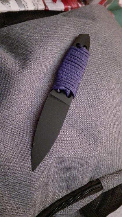

  19. Hello! I would like to share some of my favourite knives that I've made! I love to remove material with my belt grinder from plate but also I love to forge! This is made with c70 (1070), leather sheat and home made "micarta". This tiny little one it is a test made from k720 steel (that should by something like 01 I guess). And coated with gun kote! (that I love). This is also made from 1070 with a wood stratification This is an old project (sorry for the bad quality photo), it's old but gold to me, and I still love to carry in my outdoor experience! It is made from w1 steel, and old file. And paracord wrapped. Here one of my first puukko blade! And these, are probably the first stuff that I've made a ton of years ago!

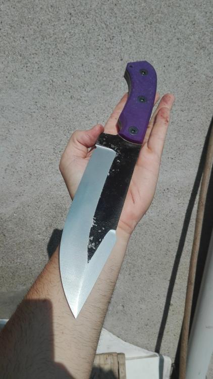

  24. Hello! I made this knife from a truck spring, about 1 cm thick! Sharp razor! Homemade micarta handle, screws adapted to make it removable, colored blade with gunkote! Leather sheath! Hope you like it!
