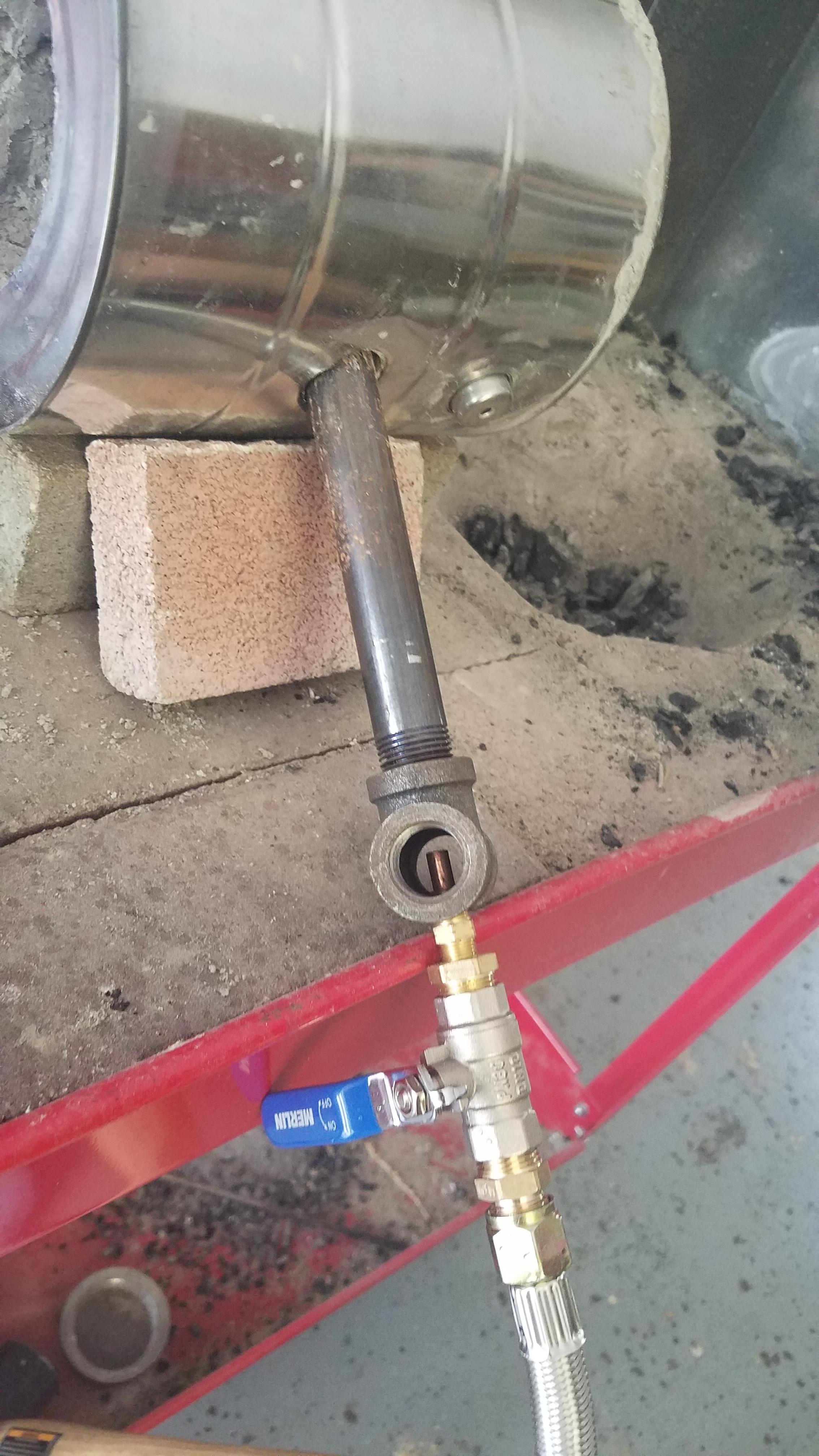

Working in the garage this weekend doing some cleaning and straightening, I found enough parts to cobble together a horrible version of a propane forge.  Pictures are still to come but to get your cringing to start early I’ll give you a little description.  The body is an unused 1 gallon paint can from another project.  Cut a couple holes in it and used a scrap piece of PVC for the center.  I mixed up some homemade refractory from left over clay from building my charcoal cart forge, and filled the can around the pvc and a 1/2 inch pipe for the burner hole.  Whipped up a T-burner with a 0.025 MiG tip.  Really the only thing I had to purchase was a regulator and a couple of fittings.  All in all I’ve got about an hour of labor involved and was able to mostly use scraps laying around the garage.
Fired it for the first time last night to start tuning the burner.  Trimmed down the MiG tip only to realize my welder tip file for .025 tips is broken.  Ah well, guess it can wait a day or two until I run past the store.  Hopefully by then I’ll have pics as well.  Up next is to forge a small cradle for it to sit on.

Replaced my broken torch files and cleaned up the cut from yesturday.  It's running really rich at the moment so more trimming on the tip is in order.
I've got no flare on the burner pipe right now, just relying on larger size of the hole through the forge wall. Thoughts? Should I flare it out slightly or just not worry about it with such a rudamentary build?

My soapbox aside, I just finished some touch up clay work on the forge.  I am in complete agreement for anybody who’s thinking it, clay was a bad idea, but it was left over so oh well....  As for the burner, I think my first change will be to shorten the tube, it’s 6 inches as that’s what I had laying around, but based on Frosty’s design it should be 4 inches, i.e. 8D on a 1/2 inch diameter.  So we’ll see how a shorter body changes things.  If it’s still on the rich side I’ll be shortening up the MiG tip to hopefully draw in a little more air.  I’ve still got to rivet together the cradle I forged up and then we’ll call this experiment done.

Update on this build:
It's been a fast fall and haven't had much time to play with this. Bottom line on the build, it sucks.  Ha ha.  As noted above, it takes forever to heat up. 30-40 minutes to even get the forge to temp and then the clay just wicks the heat away from the metal.  It's just not worth the propane to continue use.  Of the few times I fired it up I ended up lighting up the charcoal too as I had projects to get done and didn't have hours to spend waiting around.  It was a fun experiment regardless.  It certainly hasn't dissuaded me from going to gas in the future but it will have to wait until I can either invest the proper time in a build or invest the money going the commercial route.
