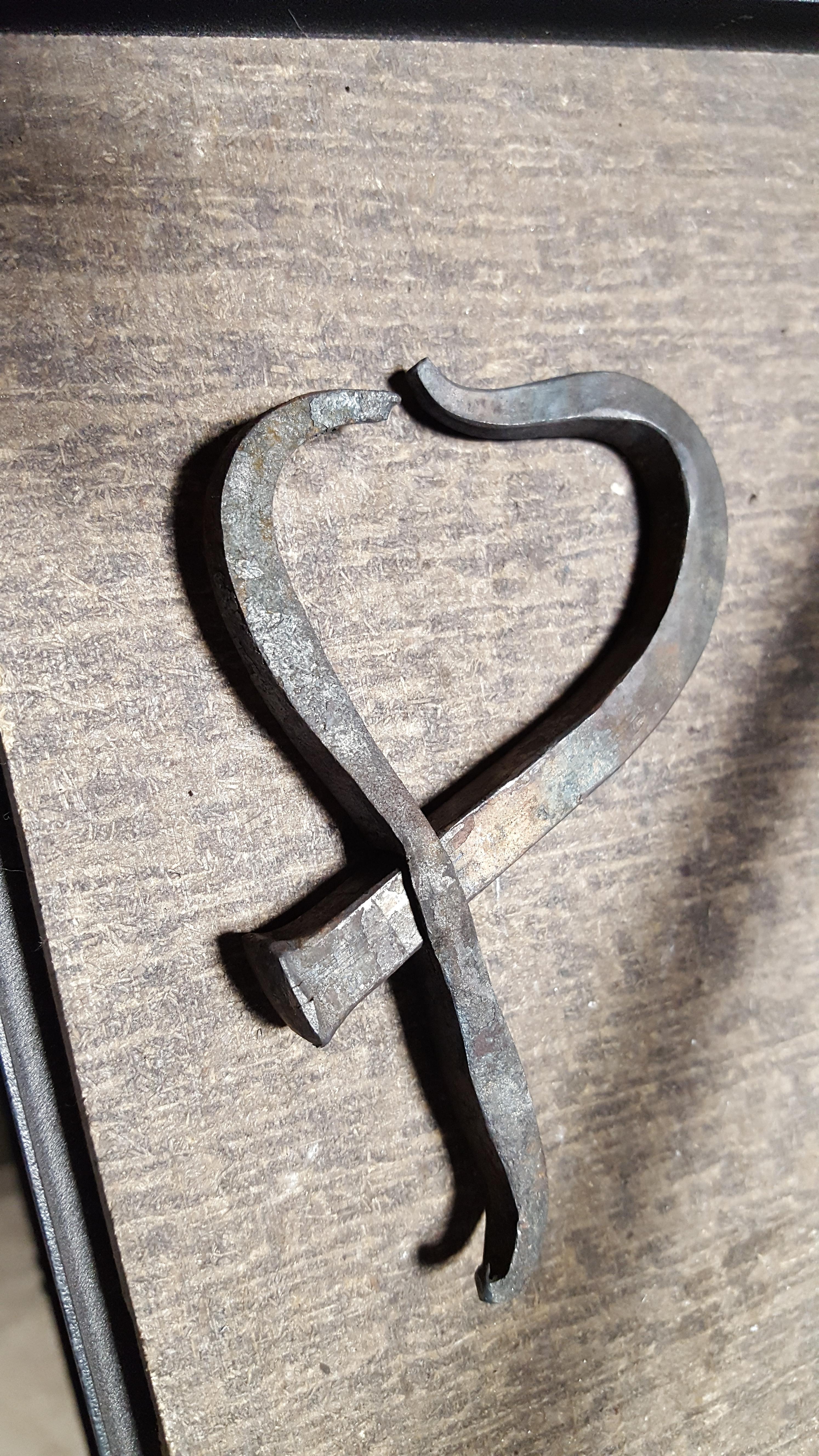

SLAG Posted May 30, 2019 Share Posted May 30, 2019 JHCC, 2 hours ago, JHCC said: One modification I’m going to make on the next one is to texture one side of the rod with a cross peen before I curl it into a spiral. I’ve had a couple of instances of the reins slipping a bit, and I think that will help. Glenn, a long time back, suggested using the thread of a bolt to texture the edges of iron leaves to fashion the toothed edges of those leaves. It can be used to enhance the gripof your very clever tong clips. A large screw would make diagonal indentations. Just a thought, SLAG. p.s. Thanks for your information. Quote Link to comment Share on other sites More sharing options...
JHCC Posted May 30, 2019 Author Share Posted May 30, 2019 Hmm...I think I have some long bolts that might work.... 36 minutes ago, ThomasPowers said: I just use a piece of pipe mounted vertically in my vise I've dropped a rod into the pritchell hole of my anvil and used that with good success. The trick is to pull the end of the bottom coil, so that as the spring straightens, it drops down rather than riding up. Quote Link to comment Share on other sites More sharing options...

Latticino Posted May 31, 2019 Share Posted May 31, 2019 Here is a clever style of crimping tong clip that a friend of mine showed me (his, not mine, I have yet to set aside time to make one myself). I think it needs a bit more refinement, but even as shown it crimps down pretty well and releases with a flick on the outside arm. Needless to say this is two pieces that slide with a square tennon/socket style joint. Quote Link to comment Share on other sites More sharing options...
