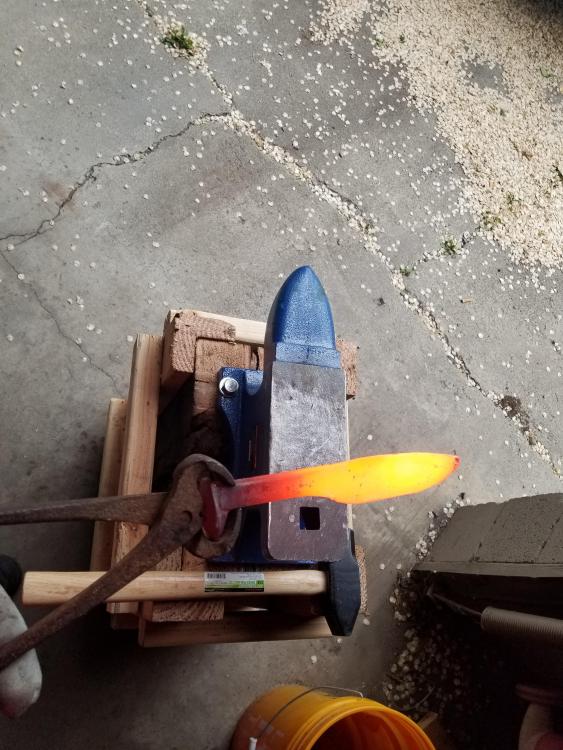

Jizzle69 Posted May 22, 2019 Author Share Posted May 22, 2019 Update slowly wearing that back and finally got my ledges put on for brick doors on each end. Does it being closed make a difference on tuning? But here's what it's at now Quote Link to comment Share on other sites More sharing options...
Mikey98118 Posted May 22, 2019 Share Posted May 22, 2019 Your tuning is fine; I'm looking at a great flame. Quote Link to comment Share on other sites More sharing options...
Jizzle69 Posted May 22, 2019 Author Share Posted May 22, 2019 Woohoo thank you everybody for the help been having a little fun in between shortenings Quote Link to comment Share on other sites More sharing options...
Jizzle69 Posted May 22, 2019 Author Share Posted May 22, 2019 Now dark and time to be done darn but from that to this Quote Link to comment Share on other sites More sharing options...
Glenn Posted May 22, 2019 Share Posted May 22, 2019 As soon as you get a chance, please brace the forge stand so it CAN NOT tip over. It looks way too tall for the size of the base. Quote Link to comment Share on other sites More sharing options...
pnut Posted May 22, 2019 Share Posted May 22, 2019 I have to agree with Glenn. It looks pretty tippy. If you weld four pieces of square tube on the bottom so it looks like a square with arms sticking off it will stabilize it considerably. You don't want it to take a tumble when it's up to full heat. Hot pieces of fire bricks bouncing around is a bummer. Pnut (Mike) Quote Link to comment Share on other sites More sharing options...
Jizzle69 Posted May 22, 2019 Author Share Posted May 22, 2019 Yes that was what I was going to do next. Thank you everyone for the help and the info Quote Link to comment Share on other sites More sharing options...
pnut Posted May 22, 2019 Share Posted May 22, 2019 Here's a picture of what I meant as the description wasn't the best. I'm sure you probably already have your design worked out. This one I'm sure isn't the best but it's an option. Post some pics when you get it finished. Good luck and it's looking great so far. Pnut (Mike) Quote Link to comment Share on other sites More sharing options...
