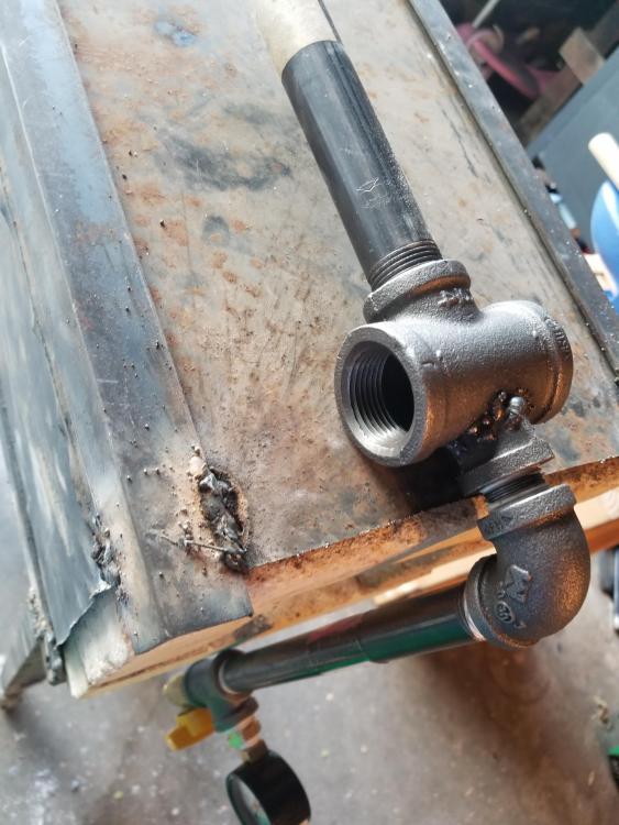

  9. Jizzle69 replied to Jizzle69's topic in Gas Forges
    So made it to the store today got a .035 was gonna get .030 and .035 but all the stores were out of .030 installed it and started getting this sorry for the quality it's still light out cant really see the flame but instant improvement no more chirp or whistle and holds the flame I will try to get a picture of just the burner when its darker

  14. Jizzle69 replied to Jizzle69's topic in Gas Forges
    Could my tip be too close to the throat?
  15. Jizzle69 replied to Jizzle69's topic in Gas Forges
    I have a inline psi gauge that after first plugging in the new reg. it was at 40 at first had to turn it down a bit before trying to lite
  16. Jizzle69 replied to Jizzle69's topic in Gas Forges
    So first that was an older pic yesterday lol so thats the new regulator, second spokane Washington, and Frost-T it actually is a T with a 1/2" cap welded after that I taped the hole from the 3/4" hole side to make sure it was straight. Maybe the first picture was crooked looking cause the the cap isnt square but if that tip is off it has to be like a hair or 2 lol. Lastly pretty sure it's a .025
  17. Jizzle69 posted a topic in Gas Forges
    I first tested my burner with a low pressure bbq regulator and was having the exact problem people said I would whistling, chirping, and back burning in the tube. Got my high pressure regulator today got it all hooked up and I'm having trouble lighting it. I got it lit a couple times but at a way low pressure and with the the shut off valve cracked barely once again since it was barely open having same issue along with it got fairly hot not red or anything but I burnt my finger. I'm confused and trying to not get discouraged but its frustrating
