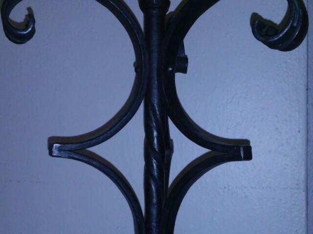

You can get a nice twist with round stock if you chisel a line in it.
I wanted to add that you can get a nice look from rebar if you first forge it square. Then you can use it as is, or twist it.
Adjusting the cross section of a piece before twisting can result in a large number or interesting twists.  I've seen a set of dies that turns round stock into fake rope after use and twisting.  Saw a glass table at Q-S that looked like it was supported with a steel Lasso done that way
I've used round bar with that lengthwise groove quite a bit. I like it.
You can also vary the depth of the groove to  create different "looks".
