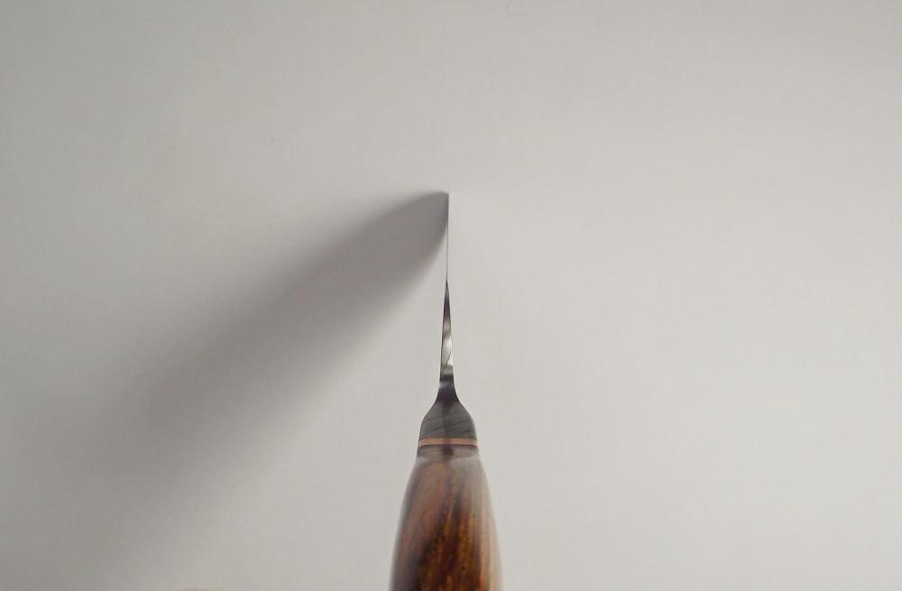

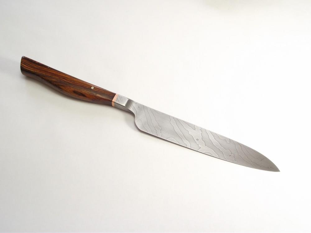

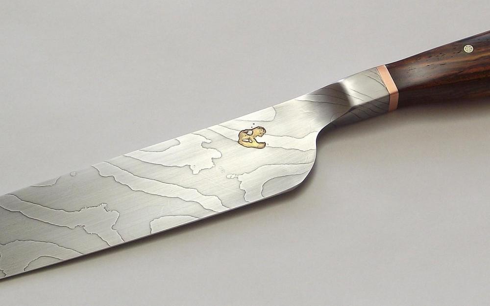

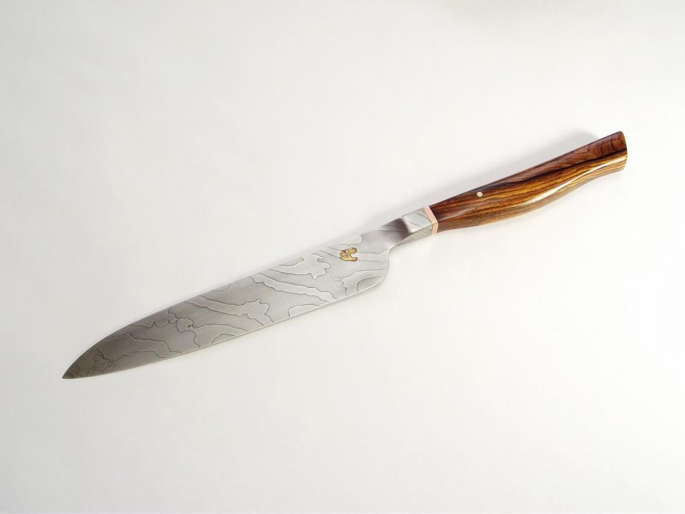

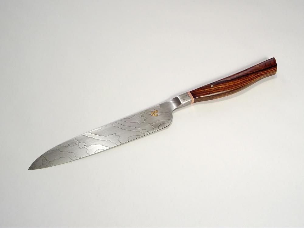

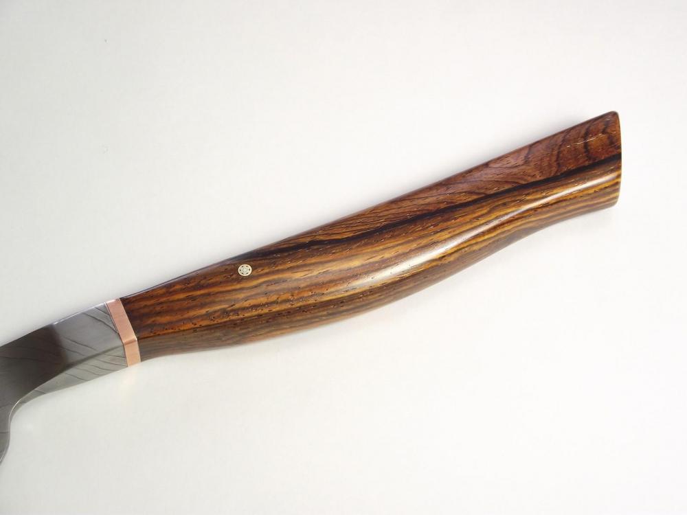

I recently finished this pattern-welded integral bolster chef knife, can't wait to start using it. I started with 8 layers of 1080 and 15n20 steel, forge welded them together, twisted the whole mess as much as I could, then forged to a knife-ish shape before grinding. I did the heat treatment in the forge, quenching in preheated canola oil and tempering in my kitchen oven. My logo is electro-etched on there and then gold plated to look fancy. The handle is cocobolo with a mosaic pin and copper spacer.
Very pretty. I love low layer counts.
Very nice execution, I appreciate your choice of materials and letting them be the focal vs extra adornments.
Excelent fit-finish and choice of materials !

Really elegant, I love the colour combos!
  • 1 month later...
Beautifully executed.
The damascas is not overstated.
Have to watch who touches it, some are alergic to the oils in coco.
